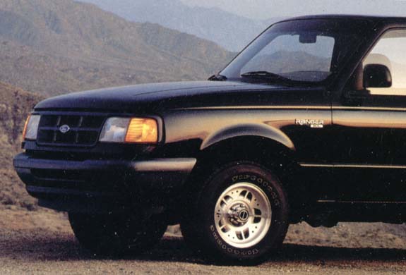

'93-'94 XL 2WD (argent gray color)
attachment.php

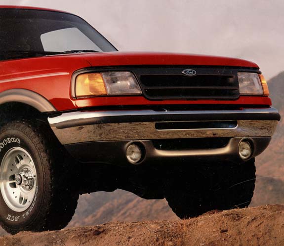

'93-'94 XLT & STX 4WD (gray w/ "4x4" impression at right, STX also has gray bumper)
attachment.php

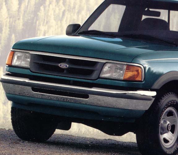

'94 XLT 4WD (optional all chrome)
attachment.php

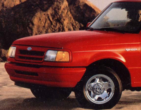

'93-'94 Splash (all) body-color-keyed
attachment.php
'95-'97 XL (all) & STX 4WD grill (gray)
attachment.php
'95-'97 XLT (all) (gray with chrome upper trim)
attachment.php
'95-'97 Splash (all) body-color-keyed
attachment.php

As far as I know one of the differances is where the grill face and the headlight trim pieces meet/ split.
On mine (93) the grill center ends just as it starts to go over the had light, where as the 95-97 ones end at the line where the headlight and turn signal meet (imagine where the turn signal starts, so does the other trim piece.
So, to my knowledge, if you swap out the entire grill (three parts to it) you can use one of the other years, but you can't swap just 1 or 2 of the pieces. other than that (and styles), they are the same.

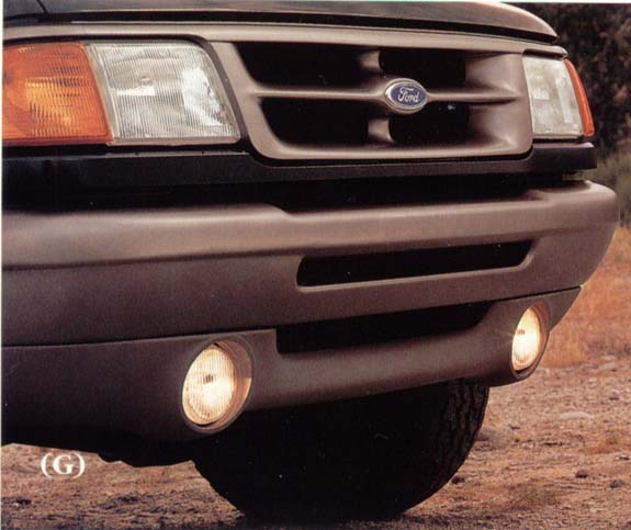

Should be fine. Me and my friend would always play pranks on each other by switching parts from each others trucks, tail gates, bumpers, wheels, and yes even the grills. His is 95 and looked just like the picture below and mine looked just like the one above.
Slight differences>>>>>>>>>

This style of grill are basically the same from 93-97, the only difference in the years, is the 93-94 are a 2 piece grille (the chrome strip above the grill is seperate) and 95-97 are 1 piece units (the chrome strip isn't removeable)
