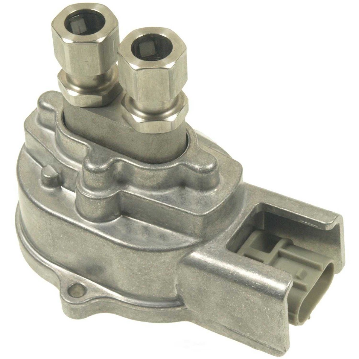

the first years of FF had a separate alcohol content sensor in the fuel line. VERY EXPENSIVE to replace.
There are no major differences to the fuel system beyond the presence of the sensor that tells the computer how much alcohol is in the gas.

Mine is old enough that it uses a flex fuel sensor I think, and it is not consuming oil, however it has 289,xxx miles on it. However if it doesn’t have a flex fuel sensor and it uses the o2 sensor that would explain a bad idle.
akranger also has a 99 I believe, and he definitely does have the sensor - we worked together to go through a stalling issue...
Your 99 should definitely have the flex fuel sensor. It's going to be on the driver's side framerail under the cab. It looks like this:
