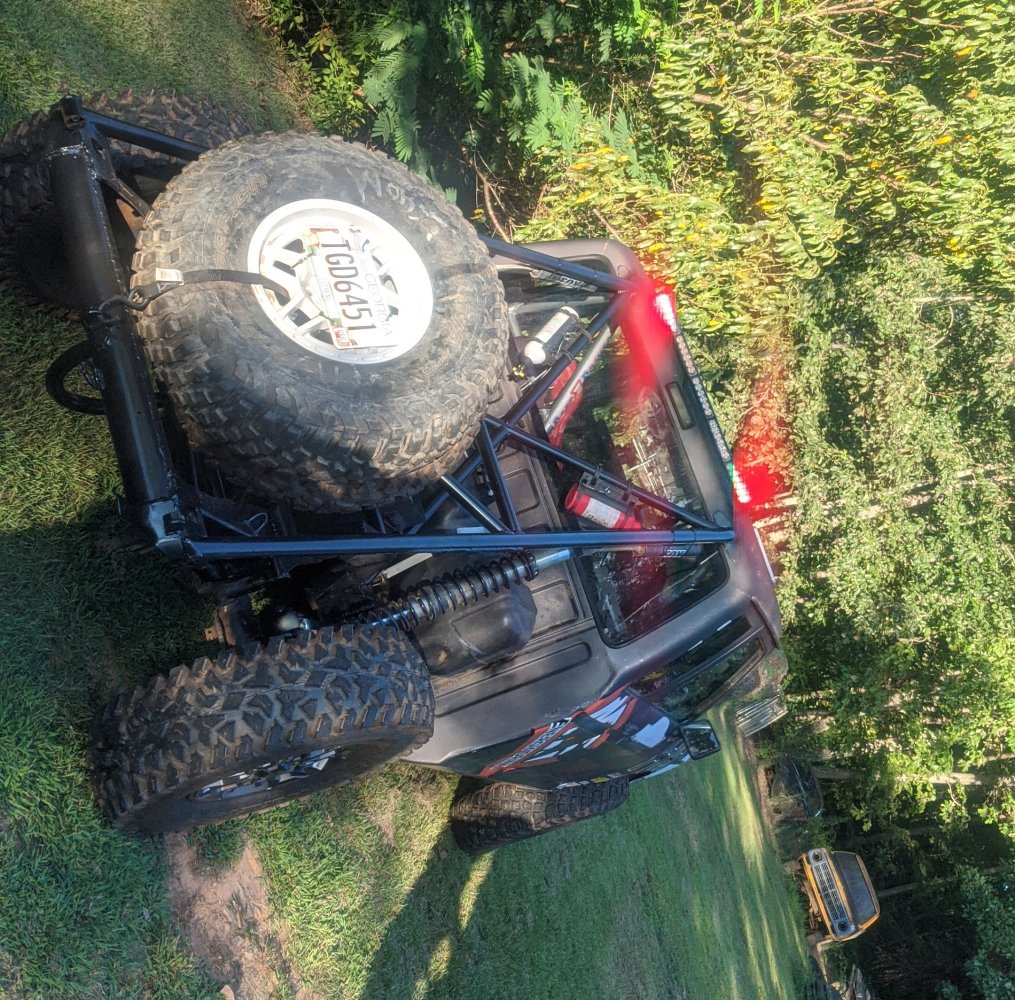

I am using the Navatlas PTS1 kit, so I have key fobs for security and the ignition is switched via the controller box. My hazards do still work, I have wired all signals and tail/brake lights to my chase bar(see picture) which was working before my push start endeavor. lol So if my fuses are good, I just need to introduce switch 12v to the input wire to fuse #5?
