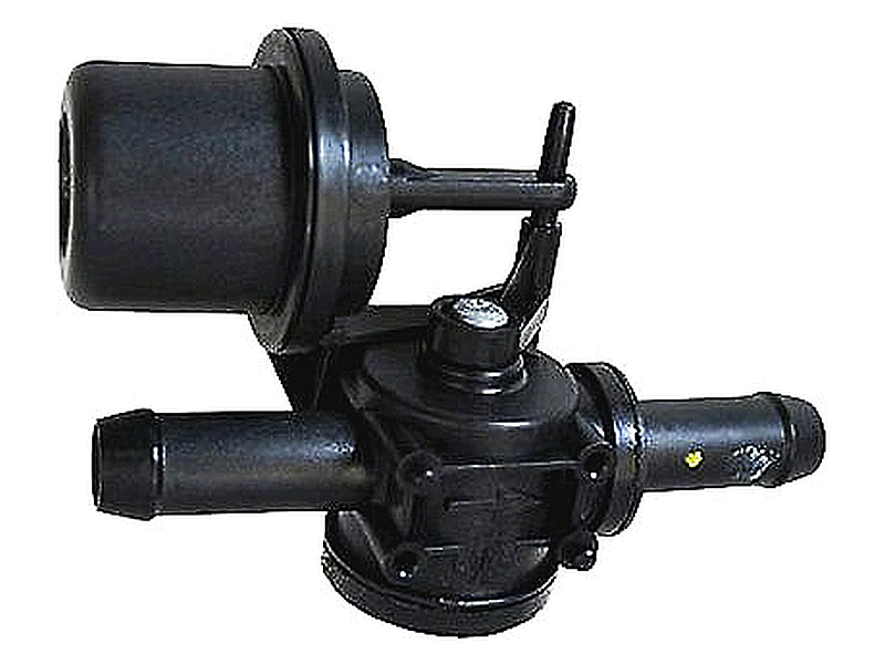

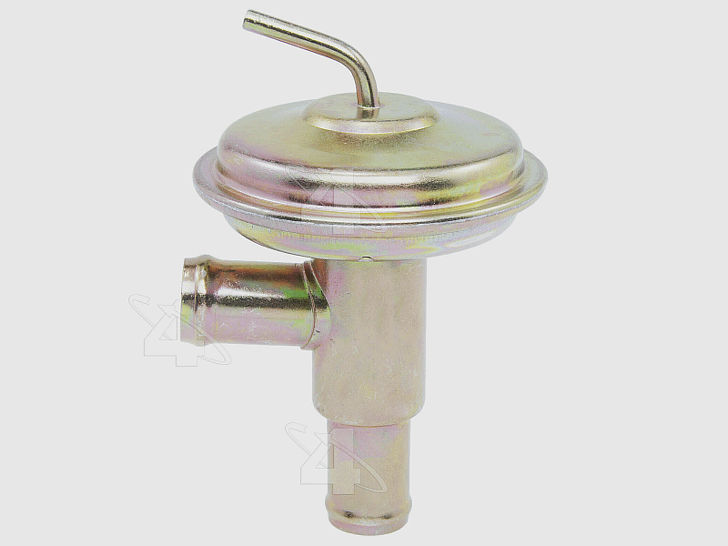

If you've got the junk Plastic HeaterValve, the VacToClose BallValve pictured below,
it can be easily replaced with an old fashioned AllMetal VacToClose PlugValve, pictured below: FourSeasonsFactoryAir# 74603
The FordOEM Plastic valve is notorious for cracking+leaking.

I wouldn't use the single hose valves to replace the dual(4) hose valves as that could lead to random overheating since Ford uses heater hoses as the water pump bypass so both hoses need to maintain flow, either thru the heater core or thru the dual hose bypass valve, a single valve would cut off all flow when used
You can just install 2 couplers in place of the bypass valve and plug the Grey vacuum hose
The bypass valve is ONLY used in MAX AC setting to reduce heat in the cab from heater core coolant circulation which "might" lower cab temp, maybe 1 or 2deg
