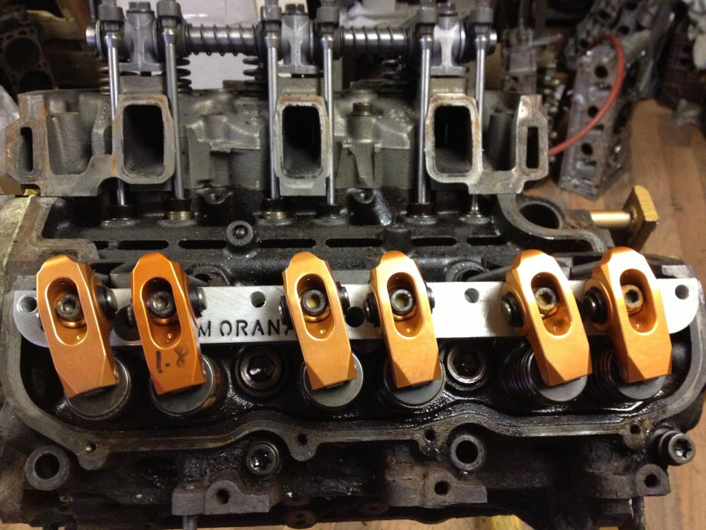

What Roller Rockers are these?

I recently picked of a 4.0 and as I'm about to drive away the guy mentions, "I think that may have roller rockers in it." Got home, power-washed the engine, and like a kid waiting for Santa to come down the chimney I removed one of the covers. Score! I don't see any identifying marks on these and they look a little different from the ones I see listed for sale. Anyone recognize them? I'm wondering if they are stock ratio or increased.

Get in line! I'm planning to run them, whenever it is that I get around to installing this engine. Since the roller rockers essentially act like a bigger cam, they should flatten out the torque spike a bit and thus reduce the tendency to detonate from the higher compression from the 98TM heads. That's my thinking any way.
