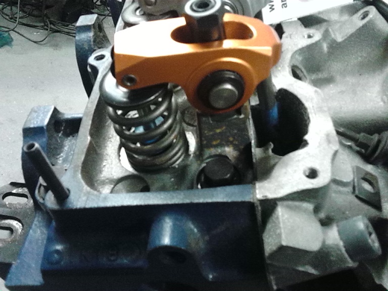

I put Morana's 1.8 rockers in my 3.0. But I did it as part of a full, supercharged engine build/manual trans swap so I can't say what, if any, impact they had individually.
I'm pretty certain they're LS based rocker arms with custom machined pedestals. They were Harland Sharp pieces, which was reassuring compared to some no-name stuff from wherever.
I also opted for Morana's upgraded valve springs at the same time. Stock 3.0 valve springs have been known to float valves on stock 3.0s, so I thought it was logical to upgrade to something a bit firmer with the increased lift and speeds involved.
There have been people in the past that used lightly modified Ford 5.0 roller rockers in the Vulcan. I've read some claim that the geometry of those rockers does not allow the roller to stay properly centered on the valve tip at all times. Just something to be aware of if that's what you're considering.
Because I installed my rockers with my engine on a stand, I was able to closely watch the valve tip as I cycled the engine by hand and I didn't see an issue with Morana's rocker geometry. YMMV
