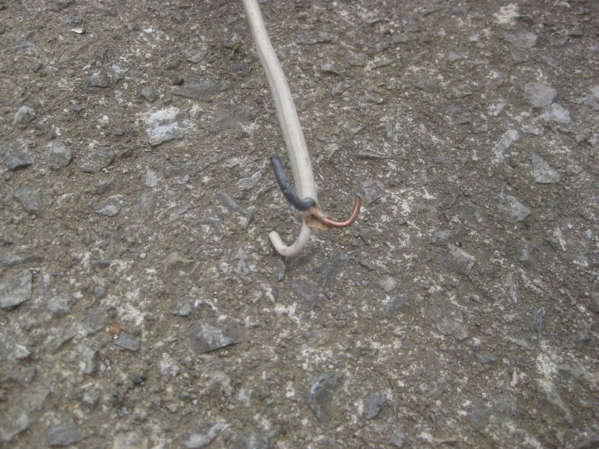

Goin' fishin'. This is really stiff wire but if the hooks caught on something you could bend them out. I have a very long piece way longer than needed. Anaconda 10/2 w/ground. I believe it came from some deconstruction work I did 15 years ago.
