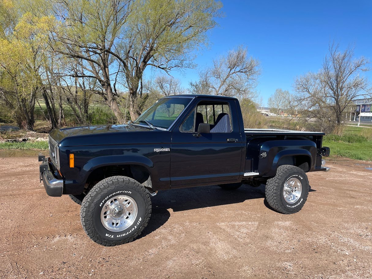

There is not much difference between 83-88 and 89-92 for tire clearance. The rear is identical - front might be a TINY bit better on 2nd gens but not by much. You are not going to run 31's with no lift and no rubbing. I have a 3" lift in the front of my '88 and 31's on stock wheels and they still rub on the radius arms. Wider/aftermarket wheels that have different offset may be much worse. I think you will need a 4" lift at minimum for 32's and your wheel choice will be a big factor.
This is 31's on stock wheels with the 3" lift - these same wheels & tires fit great on 93+ with no lift and no rubbing at all.
