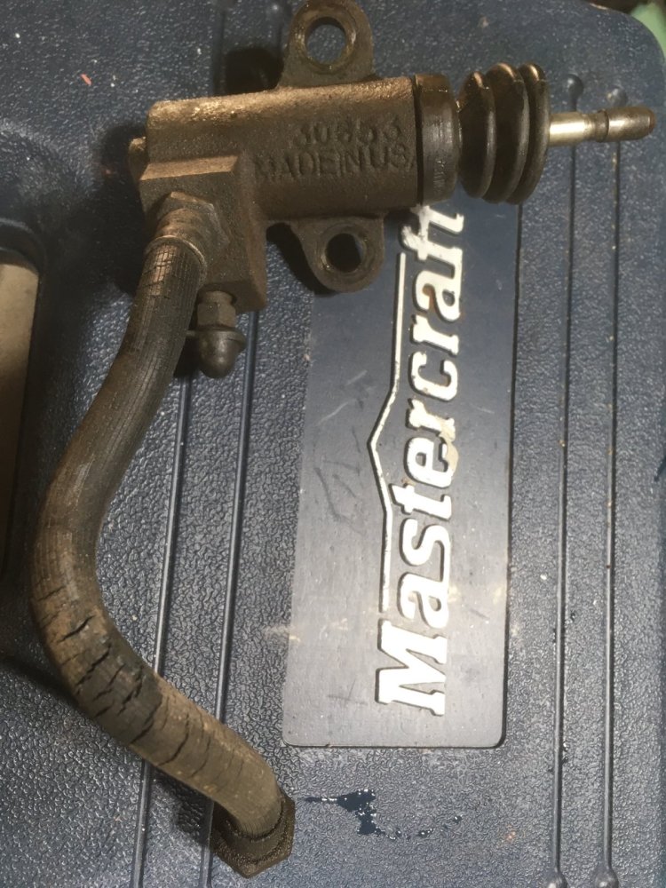

Did the slave cylinder on my old Datsun. It was working fine but the hose was looking not long for this earth and the slave was full of muck when I got the car. Since I didn't have a helper I decided to try filling the slave cyl on the bench, then gravity bled the whole thing on the car and it works perfectly, which sparked a question.
I see so many comments and threads about how hard it is to bleed clutches on the Ranger, I'm curious what might be different about the design that makes it so hard. Edit: I should amend this to say, how far back does the all-in-one slave-throwout go and is that the source of the problem? I would have guessed that was a more recent thing but it looks like maybe not.
Funny to see Made in USA stamped on a 40 year old part from a Japanese car... times have changed.

The hard part to bleed is the master cylinder because of how it mounts in the vehicle. The end points up trapping air. So, it needs to be bench bled in order to orient the cylinder angled down and enable air to be bled out of the cylinder.
Once that is done, the master can be installed, connected to the slave, and it all can be gravity bled to remove any trapped air in the line. Generally, trapped air isn't a problem as long as the master has been bench bled.
As far as when the current slave design started getting used? I think that started with when the Mazda M5ODR1 transmission got put into the Ranger. I don't know that for sure though since I never worked on a Ranger that had the Mitsubishi FM132, FM145 or FM146 and Toyo Koygo 4 speed and 5 speed transmission.

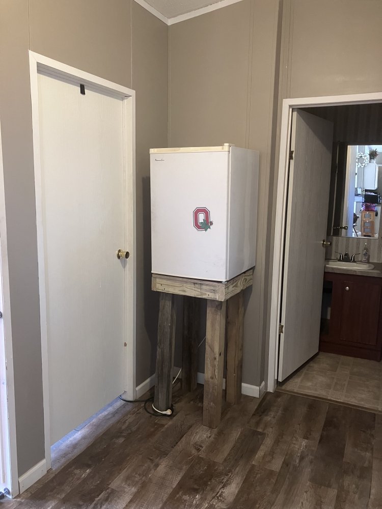

Moved my egg fridge into the house until spring, Had to build a high table for it so its easier to get in to. Was just going to stack some tires & toss a sheet over it. That got vetoed pretty quick. 😆

I know that style slave cylinder was used on the FM146. In fact it seems to be interchangeable.
