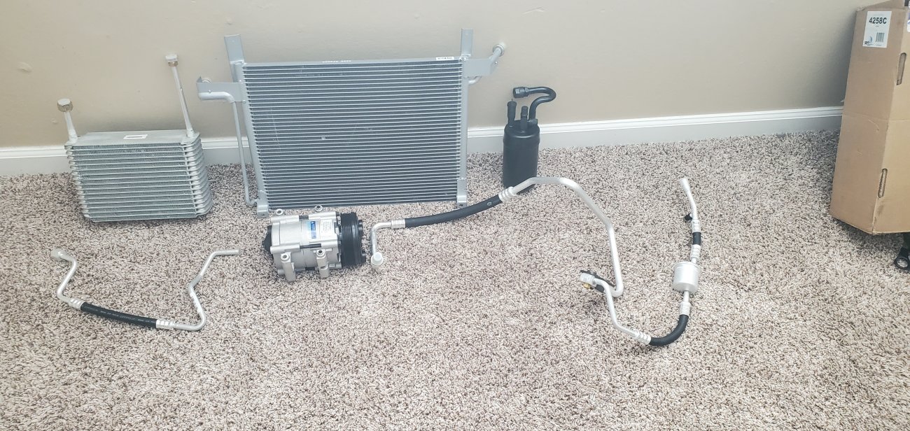

Got all the parts to replace my AC system!!

what did that cost you? Everything for the AC has been removed from under the hood of my 87 2.9, but it was originally an AC truck. I’ve been thinking of scouring the scrap yards to get all the goodies, but I’m just curious what you paid for the new stuff

Circa $350...not including the manifold gauges (harbor freight $50) and vacuum pump (also HF $100)

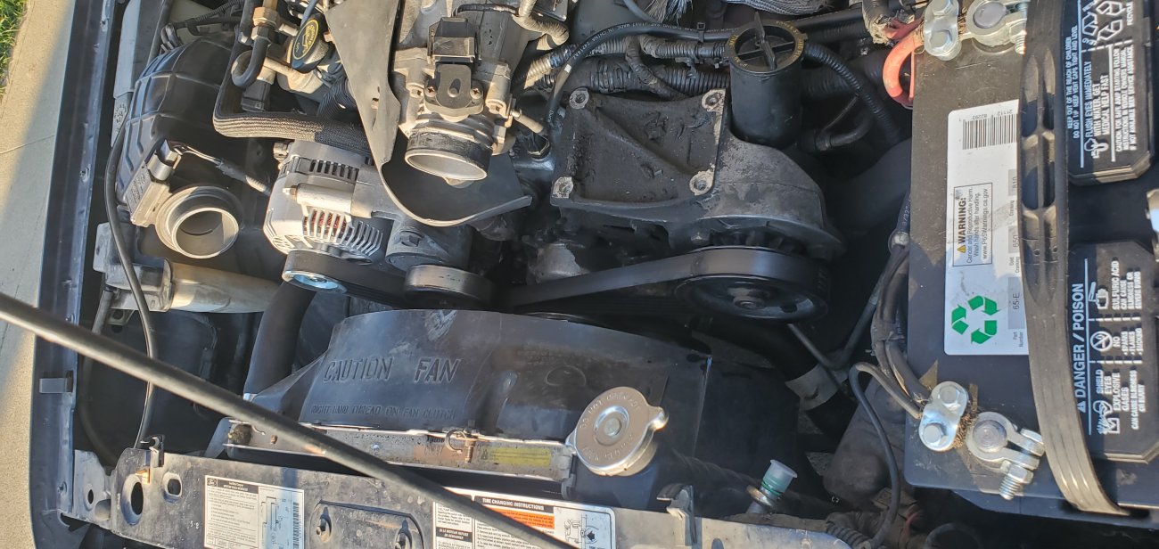

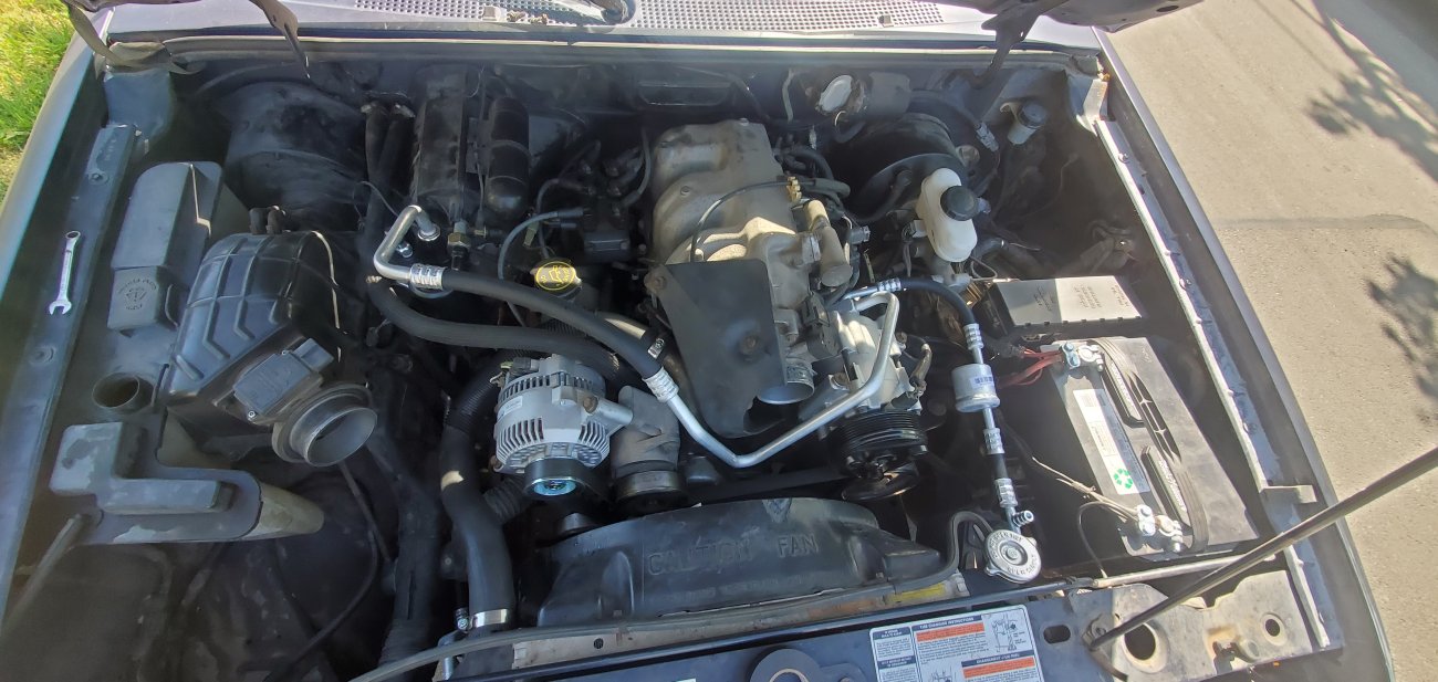

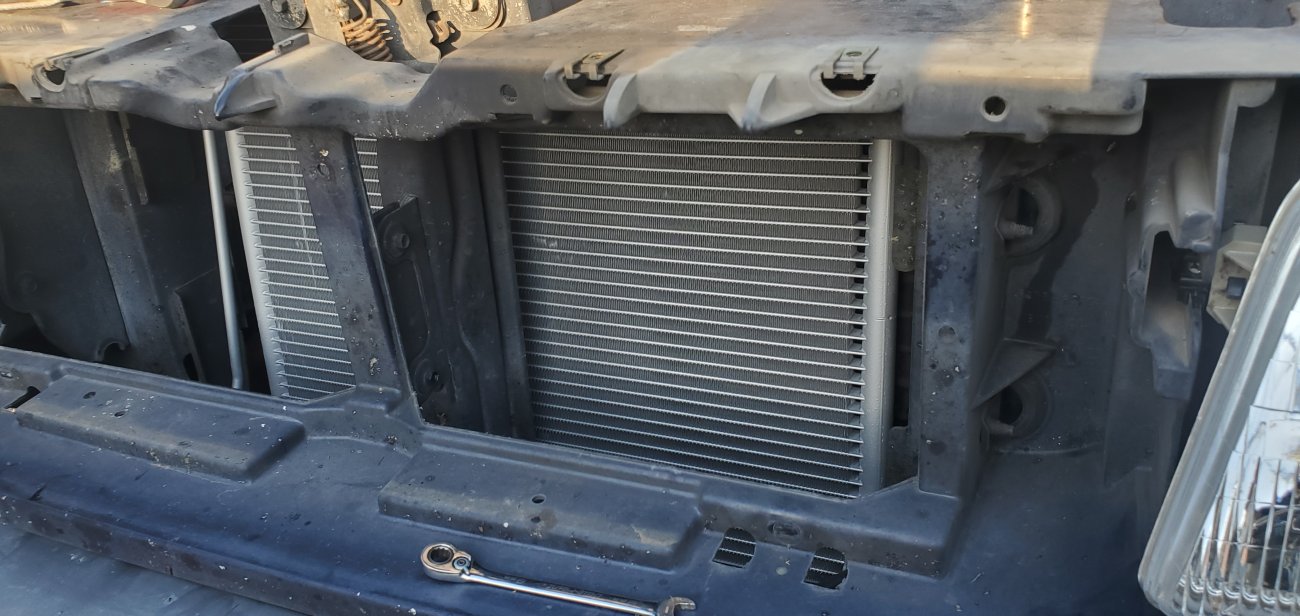

Got the condenser installed. Initially tried to remove the fan and after some cursing I realized the radiator didn't have to come out at all. FYI on a 93 4.0 OHV 5-speed 2wd you can "tilt" the radiator and get the condenser out...wrapped up the truck for the night and getting some chicken on the grill.

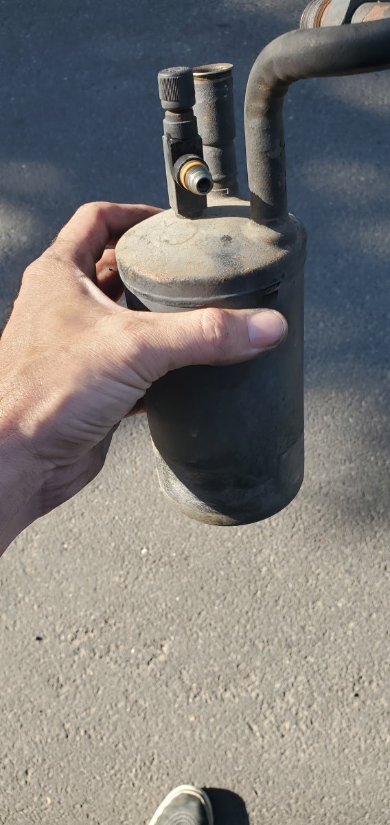

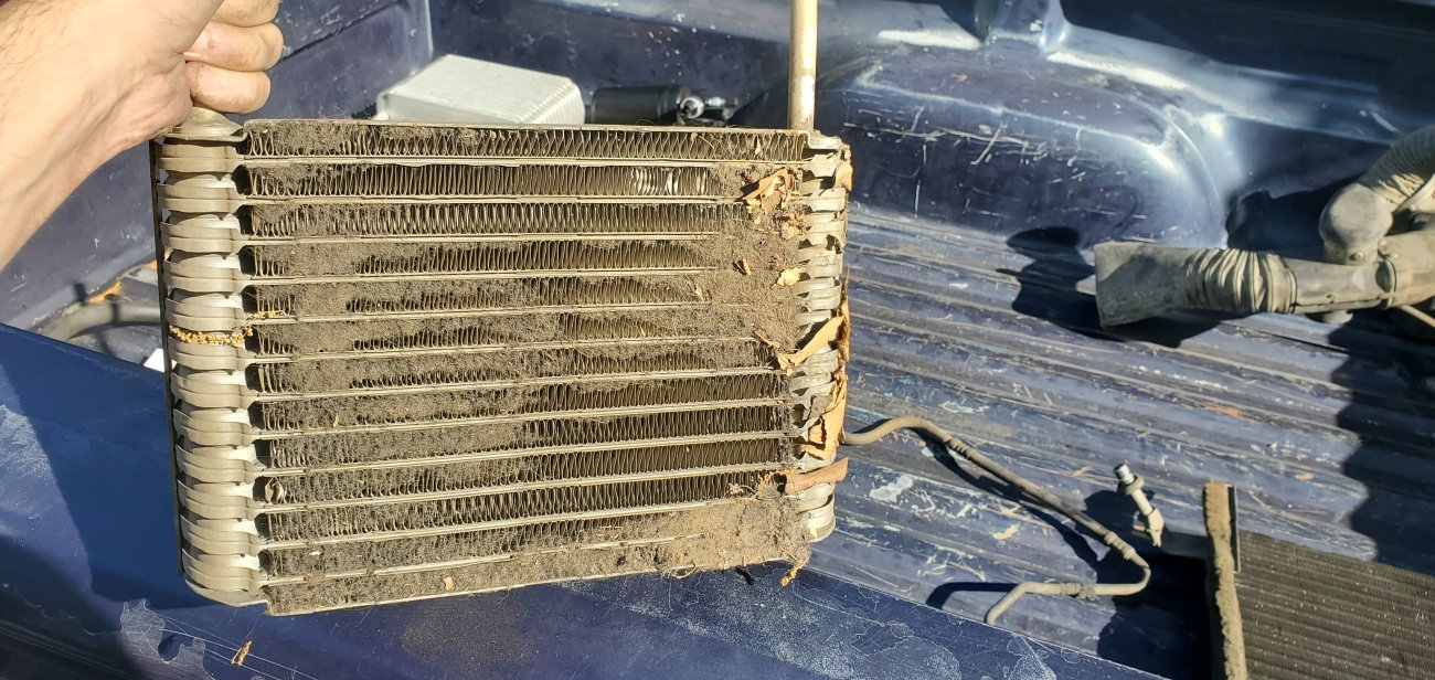

Well got everything back together and my ac pressure switch is leaking. When I remove it the system holds vacuum tried another switch and it leaks also...seems to be made of plastic so I'm not sure how tight it's supposed to be screwed onto the dryer..
Does that style take an o ring?
The switch itself didn't come with one but the dryer had one installed on the male fitting. I put a thicker O-ring on it and got it to hold pressure for about 10 minutes but I don't trust it. I went ahead and filed the system and the compressor kicked on and it's blowing ice cold! If the system loses pressure over the next few days I'll remove the pressure switch and jump it until I can figure out how to get it to seal permanently..
