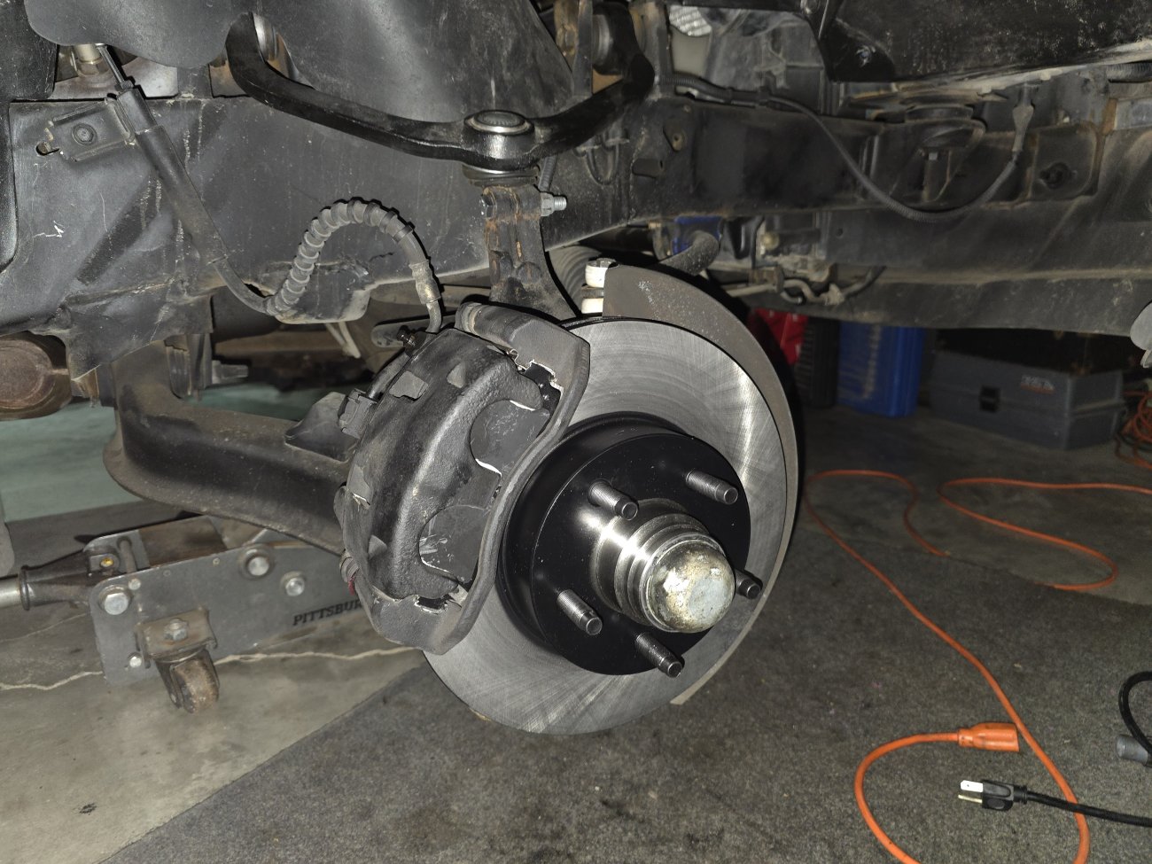

Took advantage of about 2 free hours today so I replaced the rotors and pads. I had already installed the new races, bearings and seals (all Timken, even the grease) into the Raybestos rotors a week ago. Installed Powerstop pads as well. Very simple job. Going to do the rears tomorrow, probably not going to be as easy, lol.

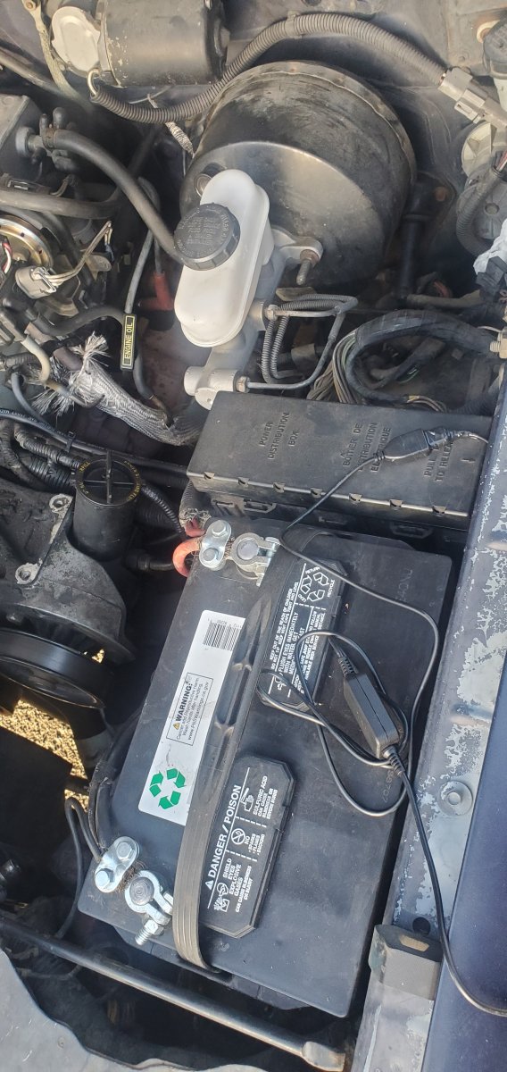

Then pulled the '97 into the shop to replace the stereo with an aftermarket JBL single DIN unit with a non contact charger in the shelf underneath:
Yes the charger with the phone on it gets dumb close to the shifter, if it really irks me I can butcher the shelf and recess everything as much as needed... I got a roll of the fancy 3M red backed tape to stick the charger down so it's there pretty good... when I do the heater core I'll put a relay in the system for key on power so the pad isn't powered all the time but I had enough for today...

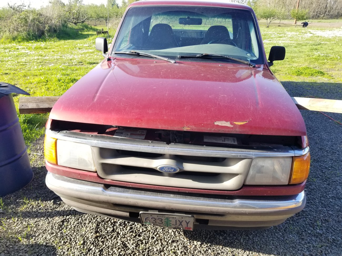

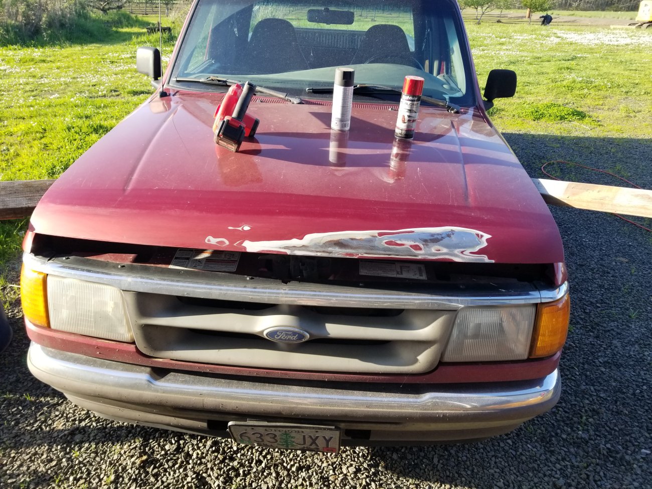

Then I switched to lazy body work, the leading edge of the hood was rough from the rear ending situation a couple years ago so I finally got to that, the whole process took like an hour so don't judge too much, I'll get it better later, I just wanted to curb the rust...
The paint was much darker than I'd expected by the cap, tried black primer first which didn't work so redid it further back with grey which still left a dark line when I tried to feather it... whatever...

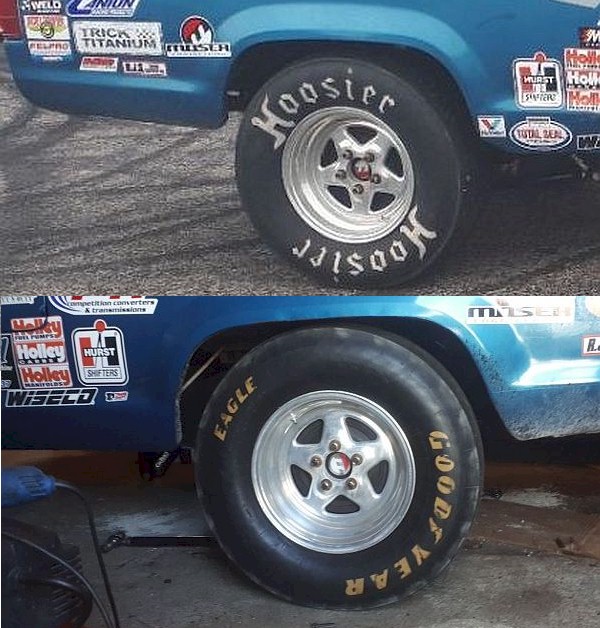

Replaced the rear springs with a pair of much softer ones that even lowered it an inch or so. The cobbled together set that was in there were waaay too stiff to allow my CalTracs and shocks to work properly. New Goodyear slicks are the same size as the old Hoosiers...
In the daylight the paint on the hood is less bad than it looked last night but that dark line at the top is there for sure... and the shelf with the charger needs to be reworked, it's annoying for the shift knob to hit the phone in 1, 3 and 5... I think I have a solid plan...

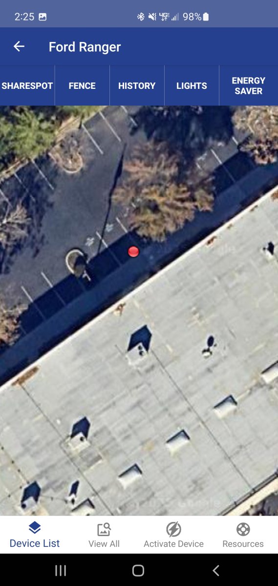

Hard wiring the Land Air Sea 54 GPS and finding a sneaky place to hide it.
