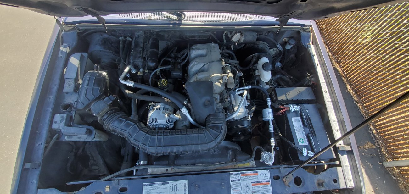

She's been blowing cold air for the last hour or so! This was a very easy job. I need to keep my eyes on the damn pressure switch/ doesn't leak. With the pressure switch removed the system held pressure for 15 minutes.. finally got the switch to hold pressure (but only for around 10 min) so my trust isn't very high that it'll hold long term but who knows. Worst case scenario I'll remove it again, top up the system and research a way to keep it from leaking at the threads.
It's funny. But the spray while it's vacuumed just might be the ticket.
Just threw the manifold gauges back on and it still has 26 psi on the low side. Looks like it's holding up just fine.

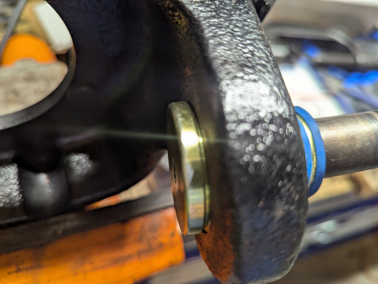

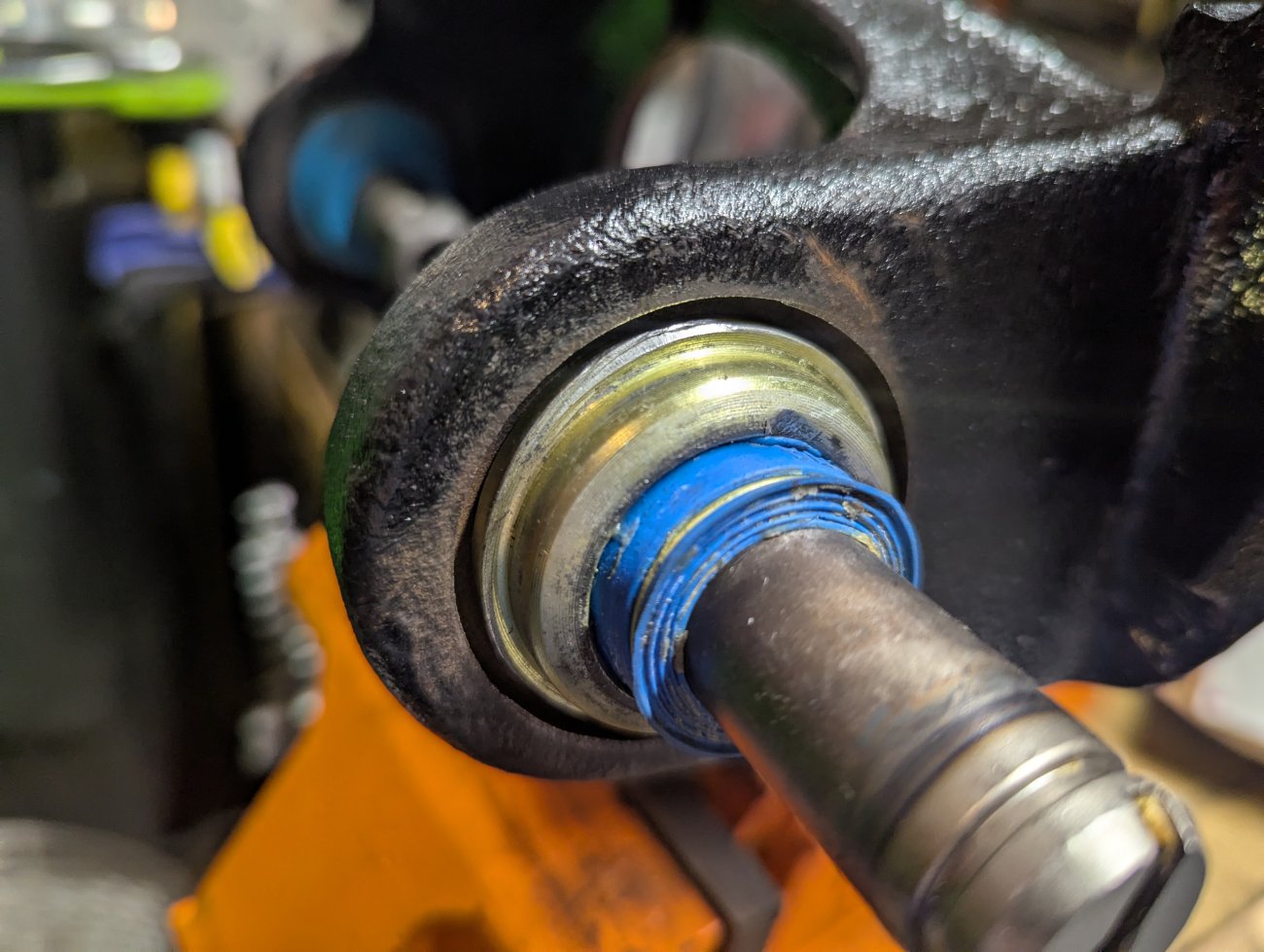

Broke down the driver's side steering knuckle and axle stub, cleaned them and got everything replaced. Except the last upper ball joint...
Apparently, my $40 el cheapo ball joint press installation cup mushroomed out and couldn't press it in all the way. Ruined the pressing edge on the joint as well. Borrowed a nicer press from AutoZone but the damage was done, with the damaged edge it can't apply pressure evenly.
So close, yet still so far away...
Ordered a replacement overnight from Amazon. Moog brand, bc that's the only one that could get here overnight and not cost $50
