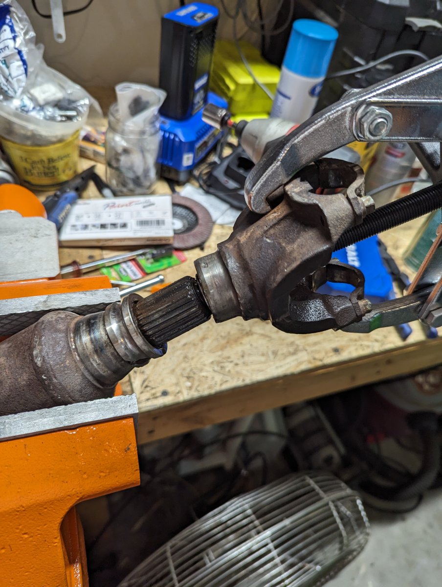

I looked at the videos for changing the center bearing a few years ago. It looked like a real, royal, total PITA. Luckily, my Ranger is a 2011 and doesn't have it.
It depends on how rusted together the slip yoke is. I broke a 3 jaw puller and an old craftsman vise before changing tactics.
Ended up using a propane torch to heat it for quite a while before using a stronger 3 jaw puller and a 2lb sledge to shock it along the way.
I might have been unlucky or let it ride too long when it shredded itself. I watched a half dozen YouTube videos where the damn thing fell off as soon as the nut was removed. So mileage may vary

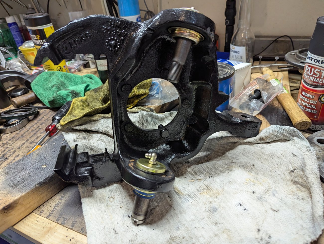

Pressed in new upper and lower ball joints on the passenger knuckle. Same with the new bearing races in the rotor along with the rear bearing and seal.
Replaced the needle bearing and seals in the spindle hub and cleaned up the automatic 4x4 hub in preparation to reinstall everything.

Center support bearings were used on bmws forever. I have changed lots of them. I sperate the driveshaft after marking the teeth with dots from a punch as they are not splined together any special way. Dont mark the driveshaft and you have to take it to a balance shop tgough.
Anyways, i split the shaft and set the end on wood so i can tap the race off with a punch and hammer. Then i tap it back on with a large socket. On the bmw, you have to preload the bearing by sliding it all the way forward so the bearing dust skirt is pulled.
