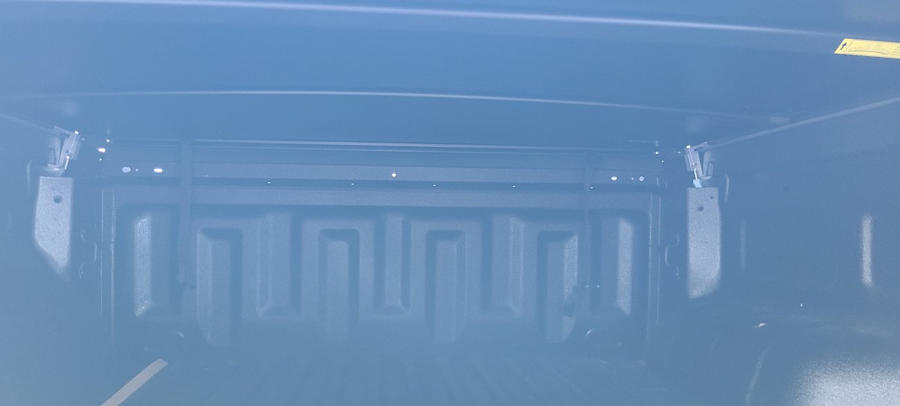

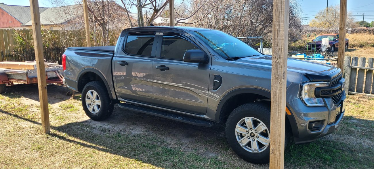

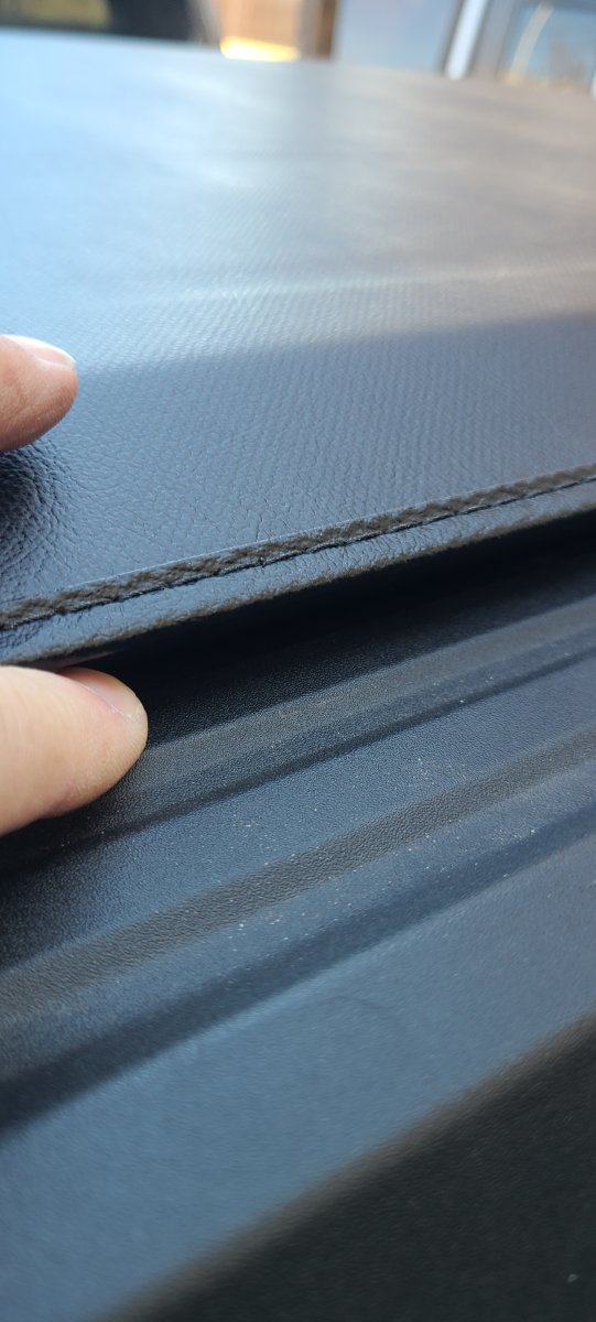

Tyger t1 tonneau cover installed. It fits ok. Its square built but the bed is not square and the back is thinner then the front. But, its not terrible. There are lots of holes in the ranger forward bed wall, the one against the cabin, so even if the rest of the bed cover sealed perfectly, water could still come through those factory holes unless you put some type of plug in them.
Tyger does send lots of foam rubber gasket material to fill seams and spots through so you could actually make it water proof.
Anyways, onto the pics
Tyger t1 tonneau for 2024 ford ranger
179 bucks brand new
Here you see the factory holes in the bed wall, and the area i have to put some foam rubber seal into.

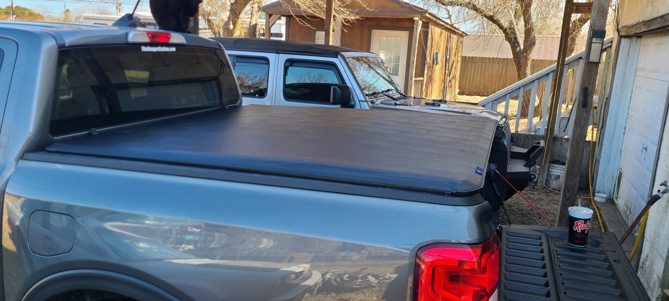

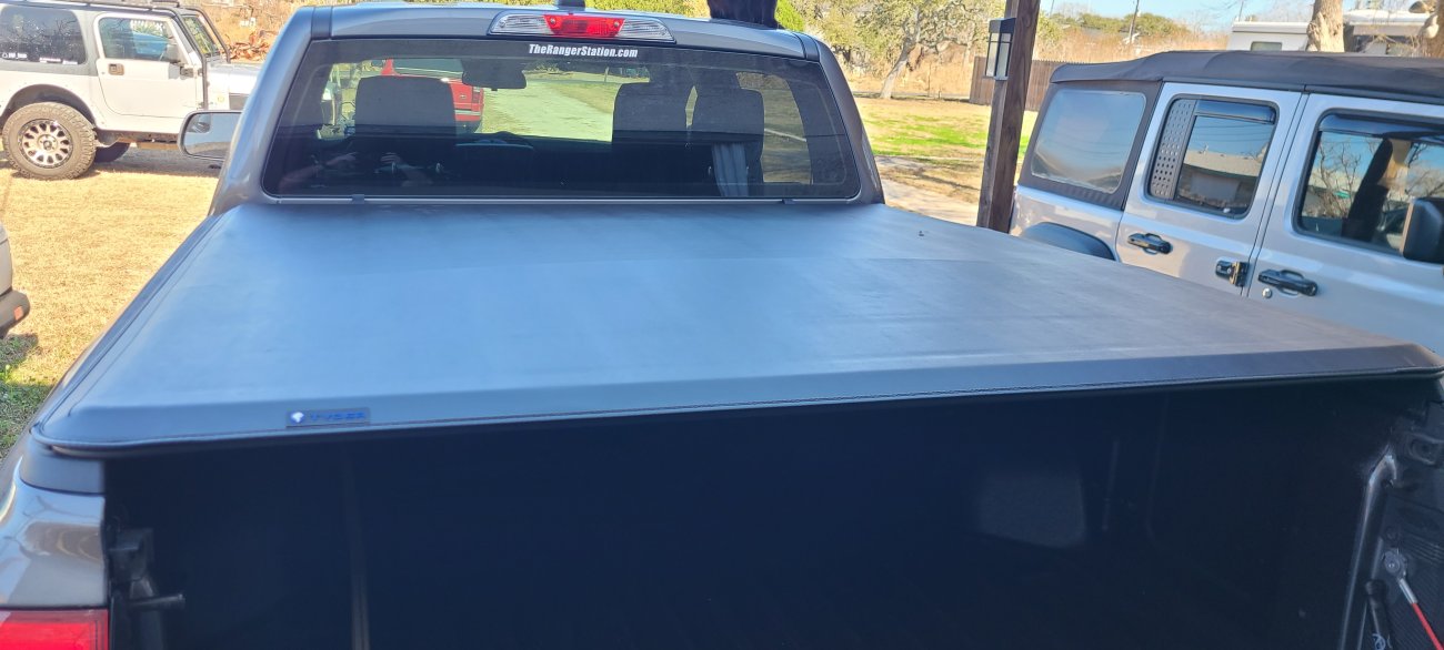

Here is the top of the tailgate. I need to slide the tonneau cover back about half an inch. I lined it up parallel to the leading edge of the forward bed wall, which has a top edge that is over an inch wide. I can move the tonneau back about half an inch and it will fit perfectly, fore and aft.
For the cost, i have zero complaints. I have had this same model tonneau on my previous 01 frontier and my 17 titan and they were trouble free so i expect this to also be without issues.

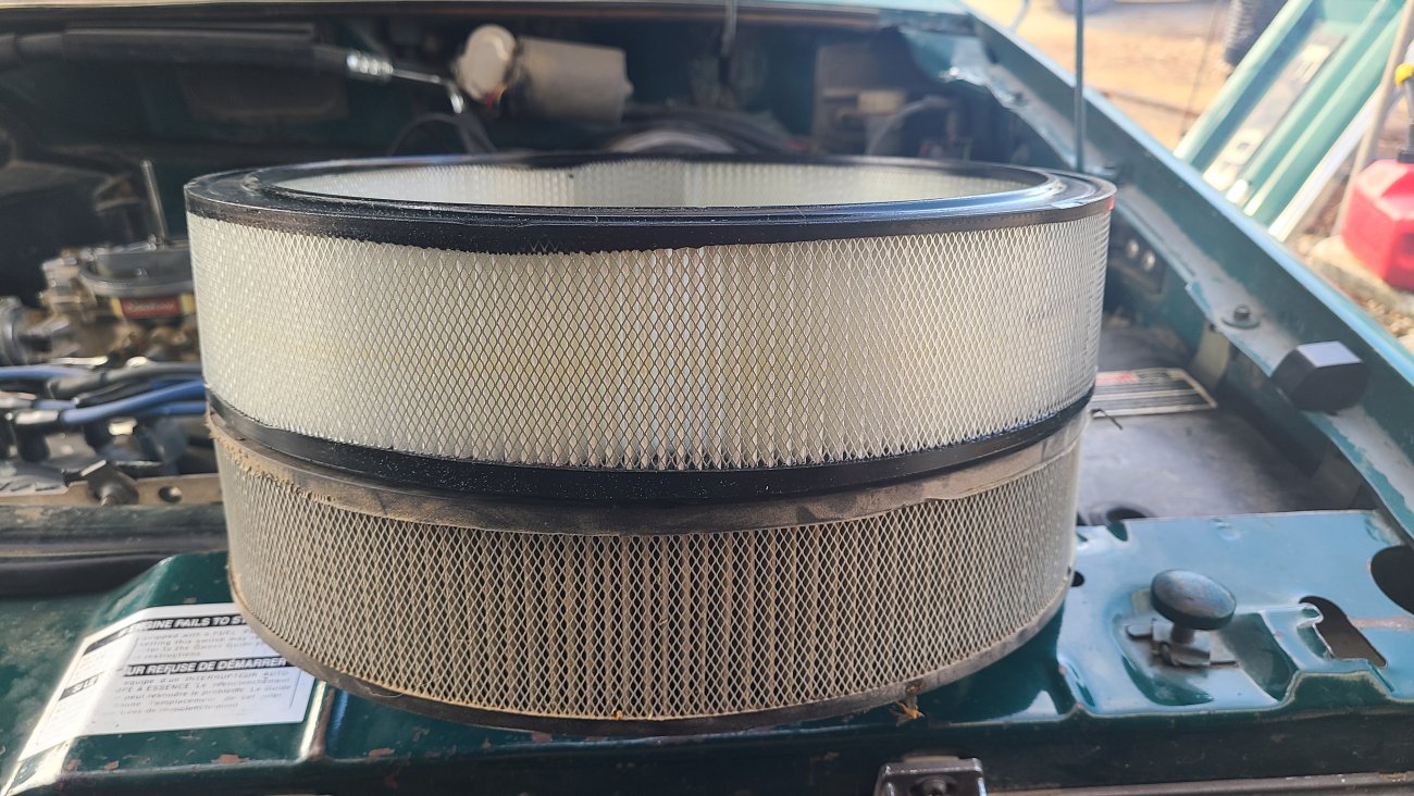

Spoiled it with a new air filter:
