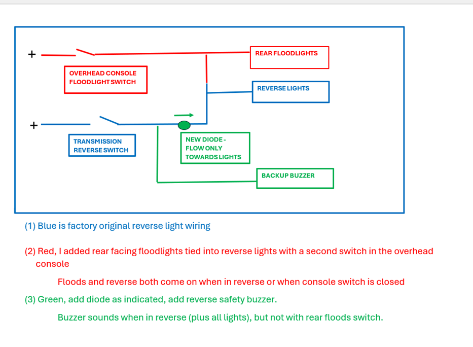

looks good to me as long as the factory wiring is stout enough to power all the floods without overloading (when backing up), and you put in big enough wiring to power everything from the switch (which shouldn't be that big a deal since 2 little bulbs is nothin especially if LED)
Will this work?
When I built the Road Ranger, I added rear facing flood lights, wired to the reverse lights, but also added a toggle switch in the overhead console. All lights come on with either switch.
I want to add a reverse buzzer/back up beeper that only works from the reverse switch on the transmission. If I add a buzzer with a diode as indicated, will it work?

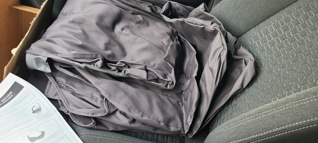

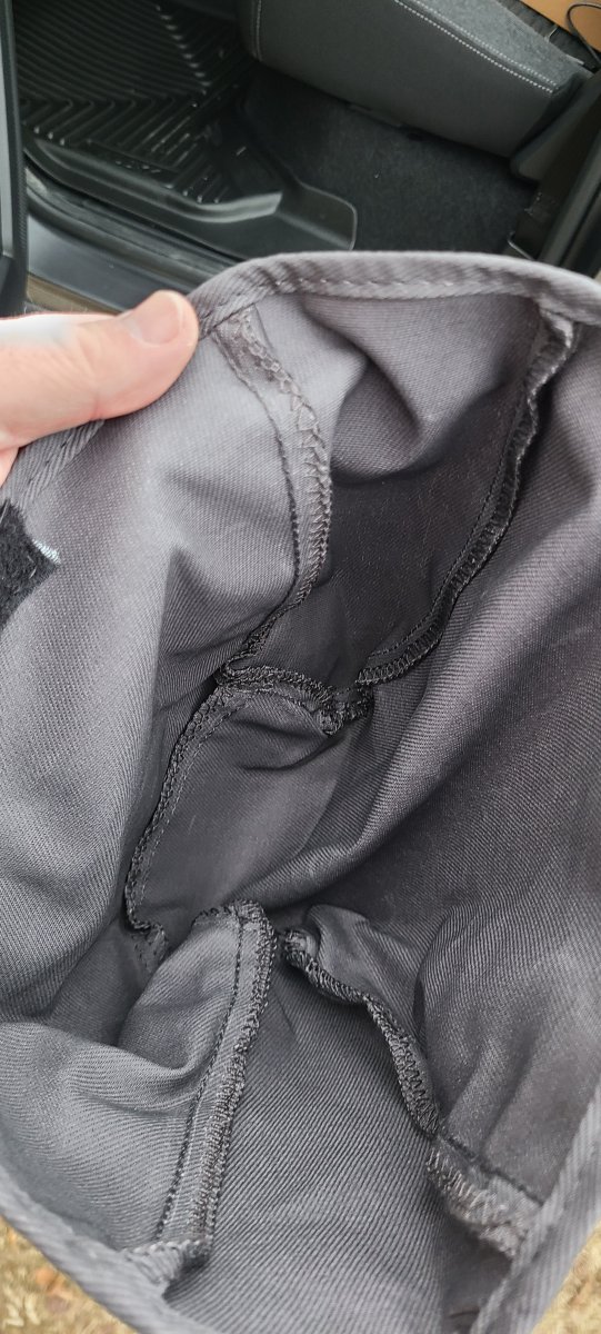

Woohoo! New License plates and seat cover showed up!!
I gor carhart seat savers because i previously had them in my titan. They are expensive but prptect your seats from spills, fading, and all kinds of daily wear anf tear. They are heavy duty and they seem to sew them up when you put in your order because it takes a little while to get to you, but so worth it.
Straight out of the box
Heavy duty stitching and material.

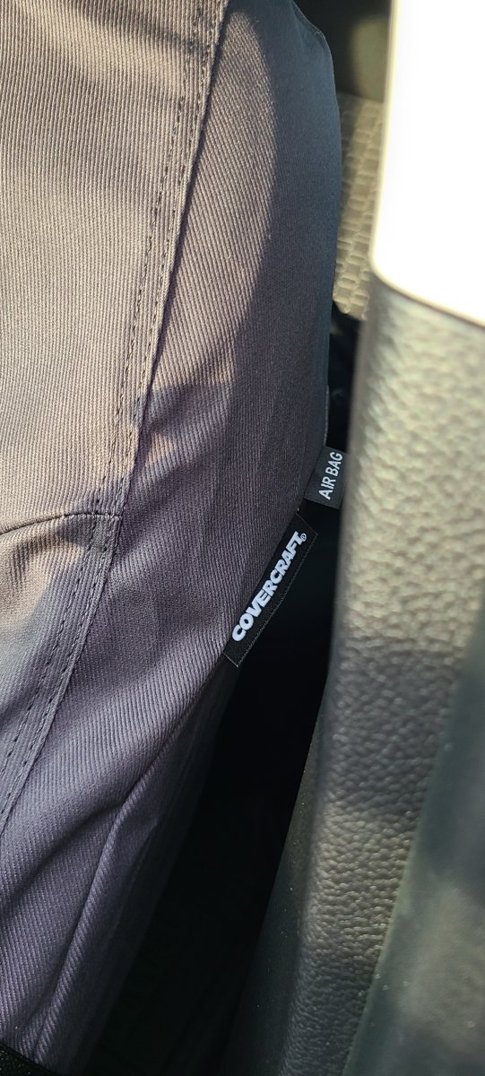

This tag goes on the driver seat and is how you differentiate which cover is which.
I will always buy these for any vehicle i get, i like them so much
Looks good to me too, but you may need/want to add a relay for the buzzer that is triggered by the backup switch. That backup light circuit was onily intended to power the backup lights, and you are already adding a load to it with the flood lights. The buzzer might be too much. Even if the wire can handle it the switch itself might not like the extra load.

good advice, thanks.

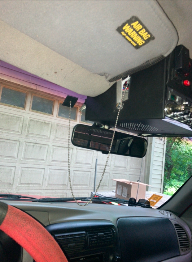

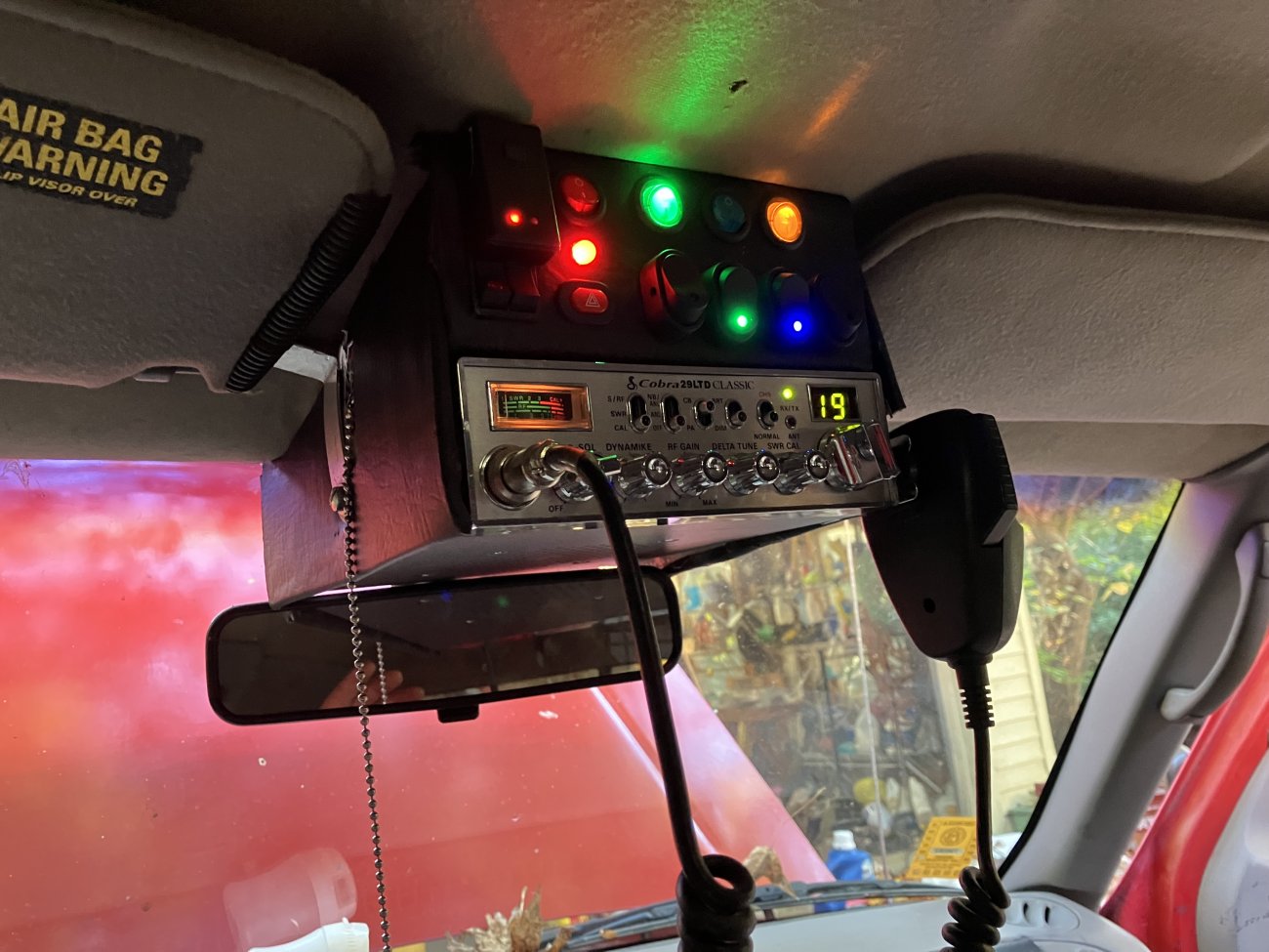

on the horn:

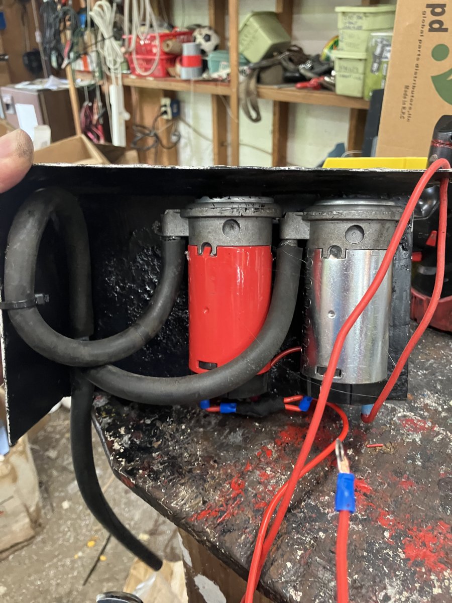

Do you see the little chain hanging down on the left? That pulls a little lever that I fabricated that pushes down on a push button switch when I pull it. That goes through a relay which powers up the two little air compressors (I need two) which blows my train horns!
Forget what you’re thinking, and go with the pull chain in the train horns! You WON’T regret it!
Better picture
and yes, look at the end of the chain stuck on the windshield. That chain is one of the chains you find in a bank that holds the pen so you can’t steal it.
Better picture
So tell me you left the pen behind...
