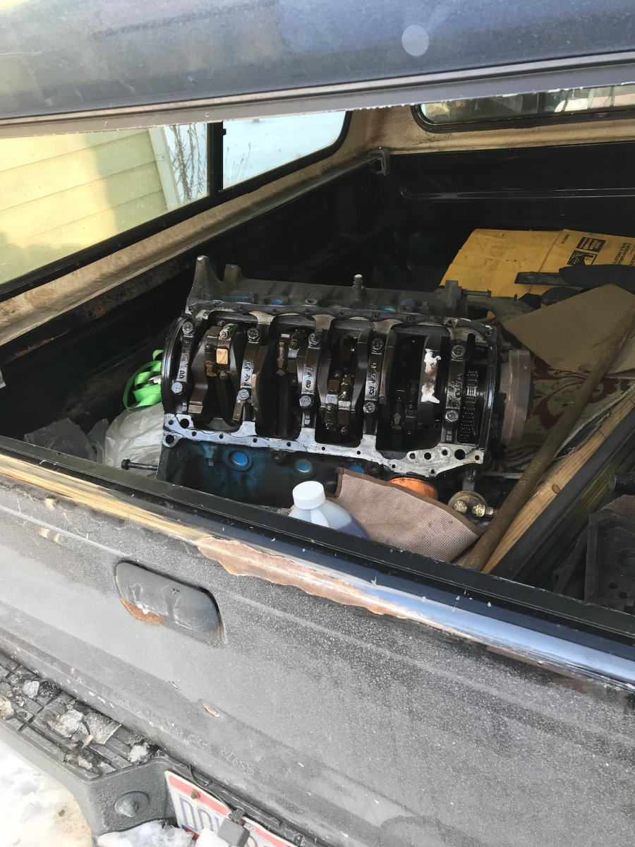

added 400 cubic inches of traction.
short block only, for now.
since I already have a complete 351M all I wanted was a crankshaft but had to settle for a package deal.
I don’t know as much as you guys do, but I think it’s supposed to go in the other end of the truck
One on each end would be cool... :cool:
