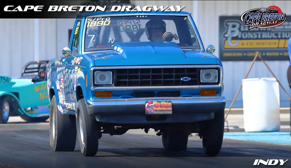

Got another pic from our track photographer today. This one only a couple feet off the starting line and it looks like our Lakewood 90/10 front shocks are doing what they are supposed to.
