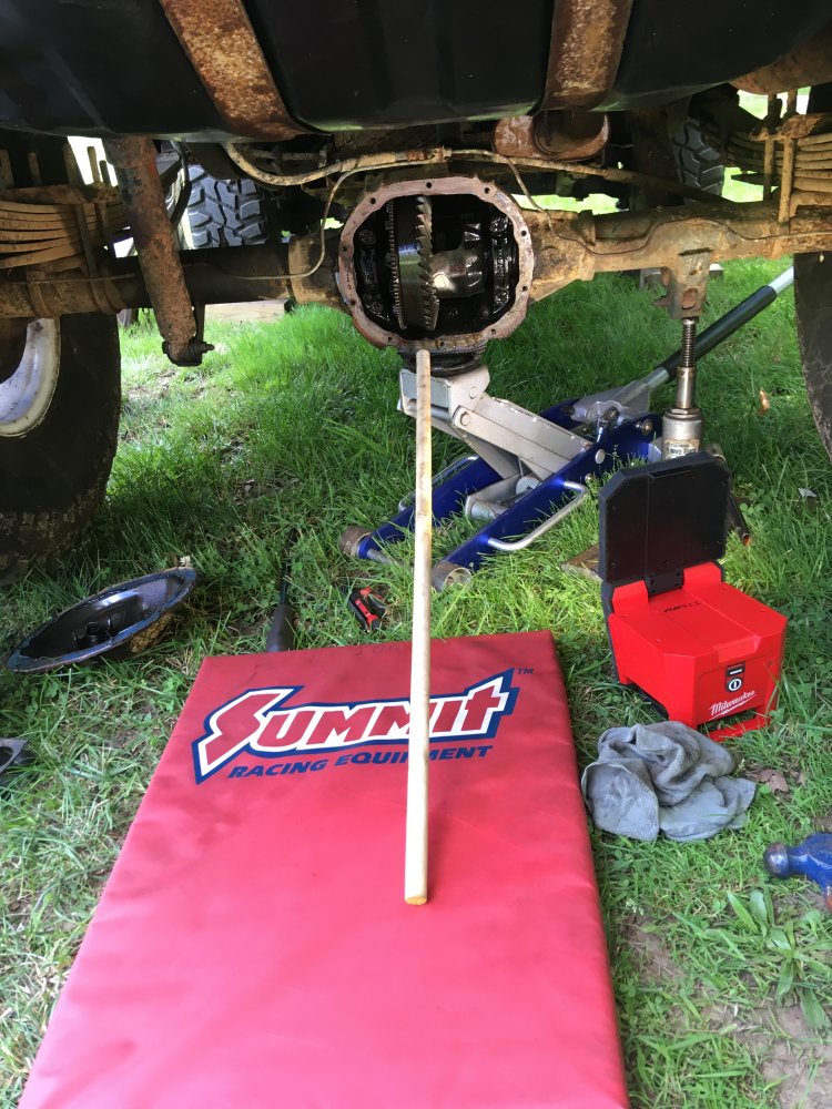

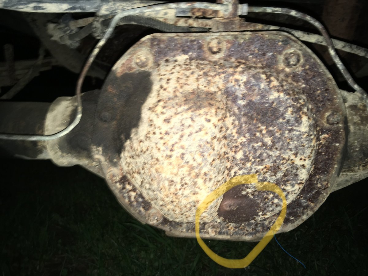

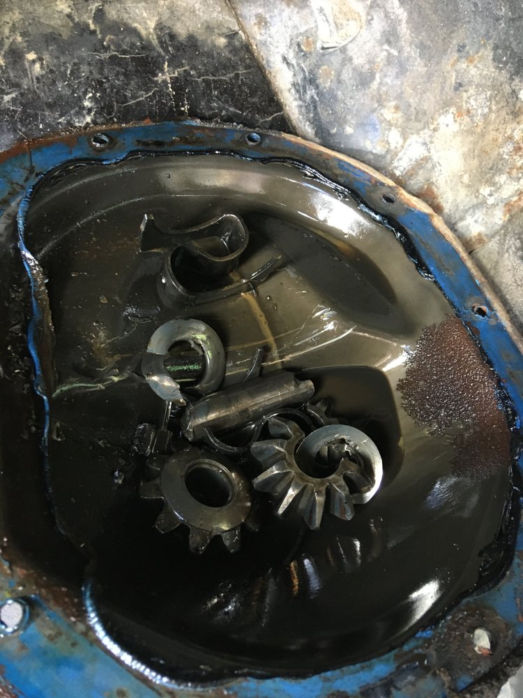

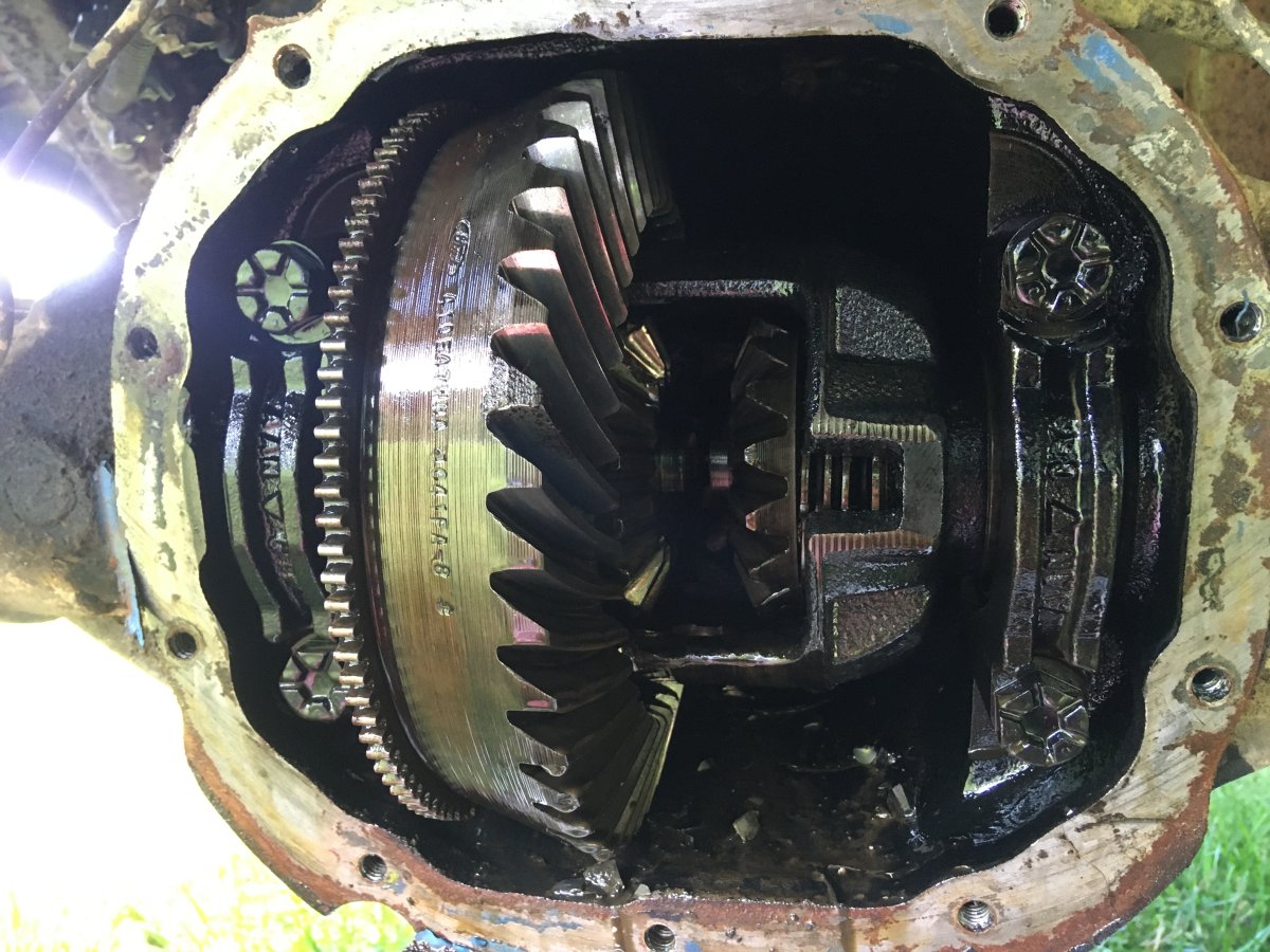

First indication that all was not well was a sudden clunk and nothing but neutral. Second indication that all was not well was a fresh dent in the cover… made by something trying to escape the cover…

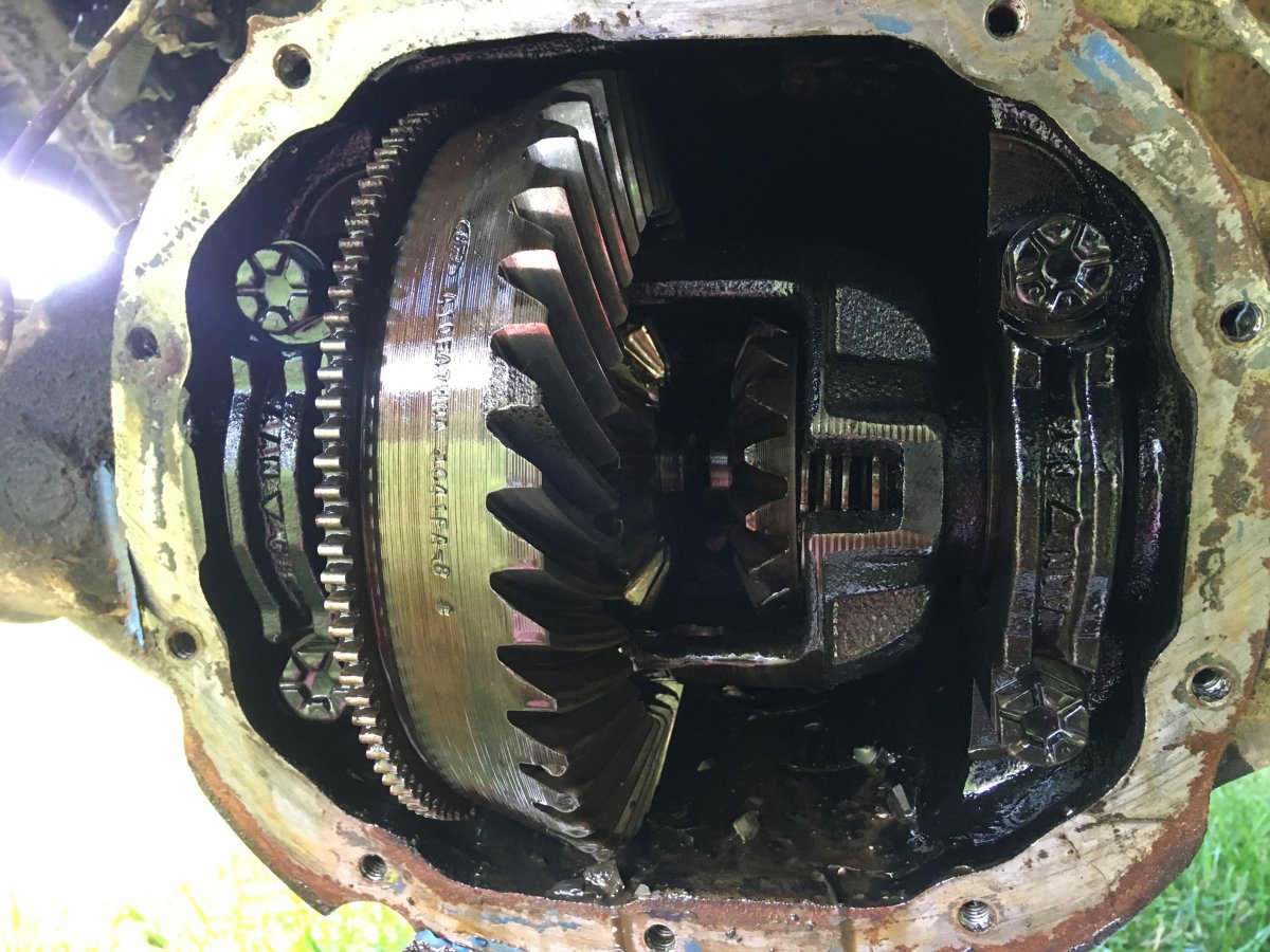

Ring gear and side gears aren’t really tore up. Pinion has som pretty decent damage. Carrier is scarred and has the start of a crack. Caught most of the chunks with the diff cover…
The chunks… lol
Possibly one of the most redneck temporary repairs ever. Wood dowel rod for a center pin to keep the axles in the side gears so the C-clips didn’t fall out so it could be flat towed because my F-150 is currently broke (slave cylinder and rear axle spring plates and U-bolts), Green Ranger has a bad hitch and it’s way too low plus it can’t haul the big trailer anyway, and the big trailer itself is a half hour or so from home at a family friends farm with a cab and frame on it. Haven’t popped the cover back off but apparently it worked to get it flat towed on a tow bar the 17 miles to a buddy’s place.
I believe that is a candidate for a salvage yard diff...
I’m probably just gonna scrap everything but the axle shafts and clutch plates. Everything else is basically toast other than the housing and I’m not sure I need to save that.
up grade time!
It’s been a plan for awhile. I actually have an Explorer 8.8 with disks at a family friends. I need to get gears and a locker for it though. It was a back burner issue for a few years. As long as things were working in the Choptop, it wasn’t a priority to collect parts. Now I need to find time and money to deal with it before September…

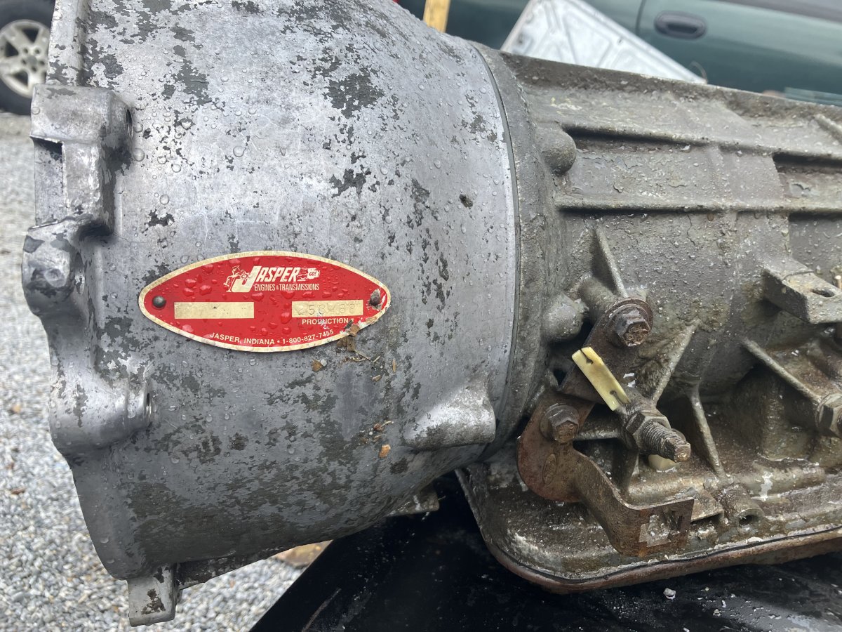

Pulled this turd out for a rebuild. 89 a4ld behind a 2.3 Was fine for years of abuse, tc got stuck locked so the previous owner just pulled plugs till it wasn’t. it became mine in 2016 ran it to near death in 2019 was doing a lot of sustained 70 mph highway driving and it was fine till I slowed down then it would puke fluid out the vent.
End of last summer I topped off the fluid with mercon V and within a mile it needed lots of rpm to engage.
The installers were nice enough to not tighten the bell bolts all to hell, I was able to get them all out, with just one wrench.
