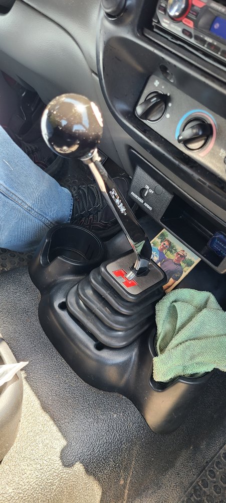

Found out that wasnt a hurst ahifter i got for 125. Turns out its a core shifter. I just instwlled it and what a difference. No wonder everyone says they have drift rangers after putting on a short shift kit to their ranger. It feels like my bmw after doing a super short shift kit

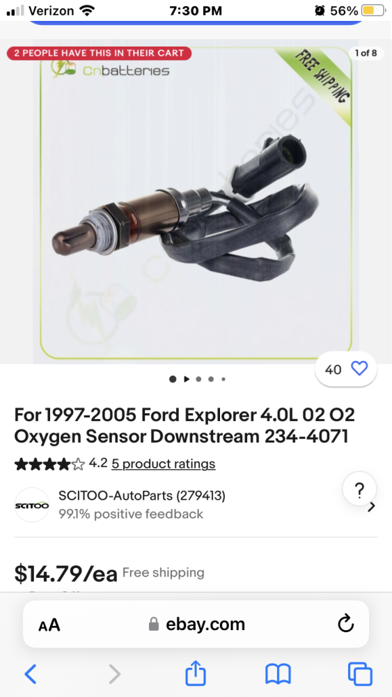

97 Ranger 4.0 5spd 2WD question(s), B2/S1 O2 sensor.
Check engine light is on, went to AutoZone and got it coded, P0153, bank 2, sensor 1.
Is that driver side after the cat? It’s listed for the 97 ranger 4.0, but it doesn’t say which sensor it is, and I think there are three.
When I converted the single exhaust to dual exhausts, the shop had to put a universal cat on the driver side. We left the passenger side alone, except for plugging the crossover hole.
If I remember correctly, the shop guy removed the oxygen sensor on the driver side and reinstalled it on the new pipe.
Is this the correct sensor? None of parts listings use the bank/sensor lingo…
Is my warning light because I have a problem with the oxygen sensor, or is the warning light on because I split the exhaust and put in a universal cat?
BTW, the truck runs fine, I just hate looking at the light now that I fixed all the other dash lights, and I don’t need it to see where the dashboard is….
Any and all comments and information are welcome. I’m not a bad turn wrench, I just don’t have the equipment and industry knowledge you guys do….
S1 is always the upstream O2. S2 is always after the cats. Bank 1 is the side with number one cylinder, obviously bank 2 is opposite.
So the pass side exhaust is p side cylinder bank factory cat, dr side is d side bank and universal cat?
I figure half the exhaust through the factory cat is not helping.

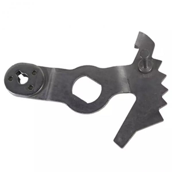

See that pin on the side by the detents? Yeah, that is super hardened and the part it's attached to is almost unobtainium (called a manual valve detent lever). I managed to find one in Nashville, TN and was able to purchase it and get it shipped to me. Yep, that set me behind a couple of days but I have the trans back together, bands adjusted and full of clean fluid. It shifts way better than it used to... smoother and more positive shifts.

Put a shifter knob on while i wait for a nicer one to come in the mail.
