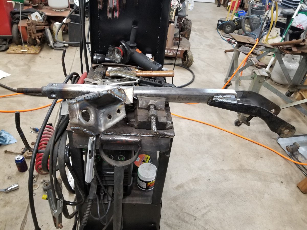

Then I finished welding up the drivers side radius arm for the '90 then moved to the pivot bracket, those brackets are kinda abstract which is annoying to figure out but I have it figured out now... I need to make a few filler pieces for it and do some more welding but progress is made, looking good for being able to finish this weekend! I have a plan for the trans crossmember, don't think it'll be too bad but we'll see...

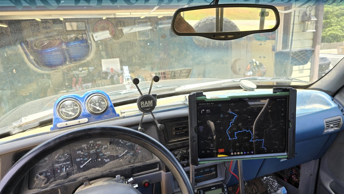

Got the tablet mount fabricated. I'll pull it out and paint it after I've used it some. It might need some modifications. I always seem to come up with "I should have..." more pictures in my build thread.

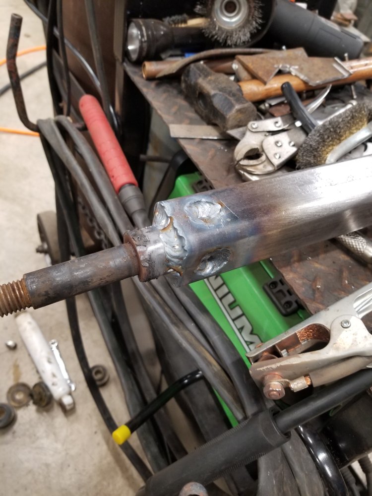

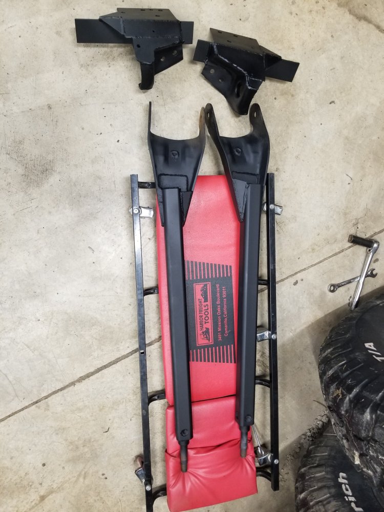

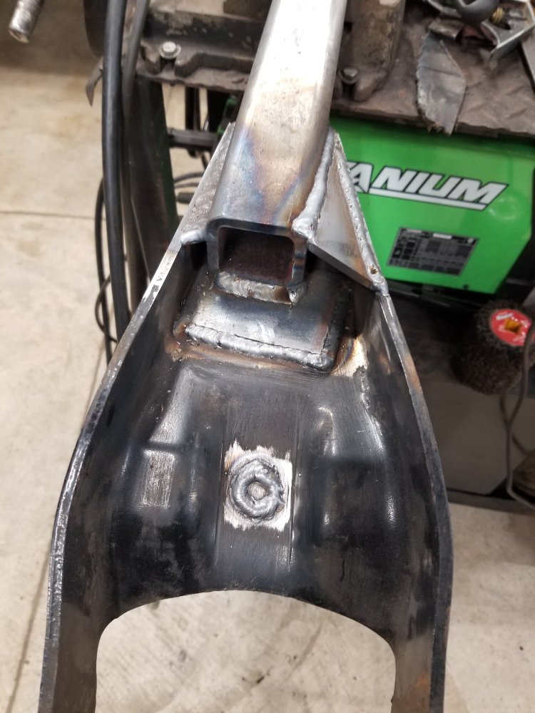

Got the radius arms and brackets finished today and painted! Finally! Those abstract brackets were a pain to figure out using chunks of the stock crossmember... ended up with the mount points flopped side to side and will use the original frame mount points to mount the transmission crossmember, might make it a pain to remove the transmission but I'm sure it can be worked around... So many little intricate pieces of metal all chamfered and welded, I welded the heck out of everything, that Titanium Unlimited 200 welder earned its keep on this project, some of the welds were real nice, not sure if it's the welder or weldor... whatever, it looks nicer than if I used the stick welder :). If anyone is wondering I did put a plug weld in the front end of the radius arm too...
Tomorrow I'll get those pieces installed and buttoned up then get to the transmission crossmember, after that I'll need to address the steering angles since pushing the axle forward made the drivers side link hit the pivot at the pitman arm worse than it already did so I need to bend the passenger side link (or more accurately unbend, the stock bend is too much)

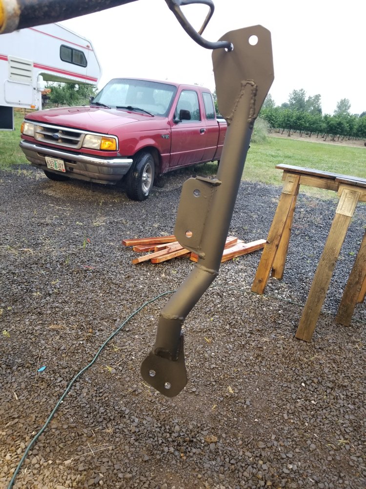

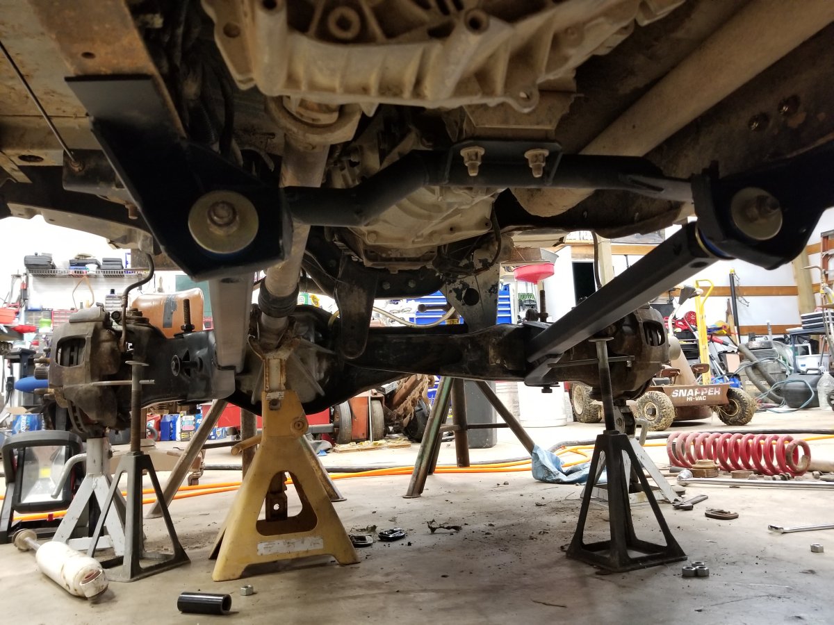

Got a good amount done today, got the last abstract piece made, the transmission crossmember... a bit interesting connecting the dots since I'm not great with tubing and don't have anything great to do reasonable measurements and was winging the whole thing...

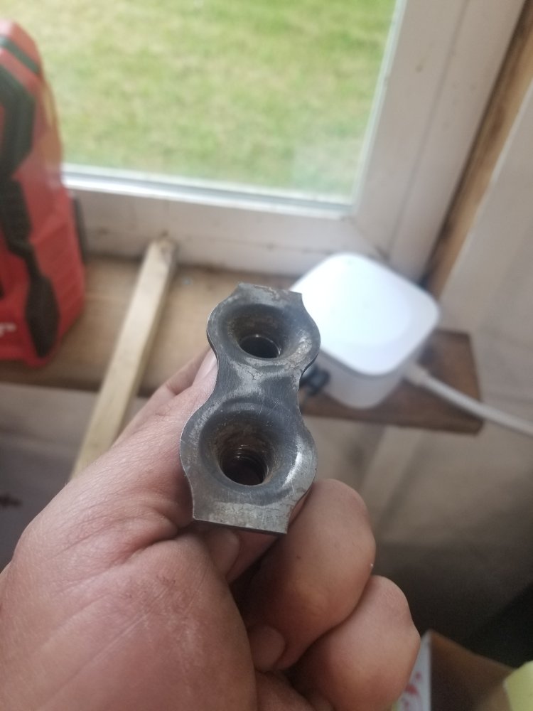

First pic is just to tease you rust belt guys, that's the original 1989 radius arm crossmember formed nut dealie, I took a standard wire brush to it and it's still got the stock black oxide coating...
Second pic is the transmission crossmember after paint, third is under the thing with the suspension all bolted up, still need to drill 4 holes in the frame for the brackets (one in front and one behind on the bottom rail)... then change the drivers side U joint and work on the steering linkage and alignment...
