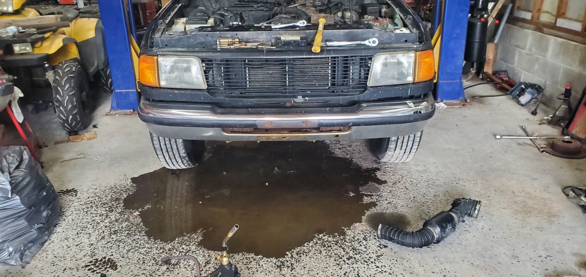

.....whelp.... said luck ran dry. Ironically. Since the floor is soaked now šŸ™„šŸ˜†
For once... I gambled and won.

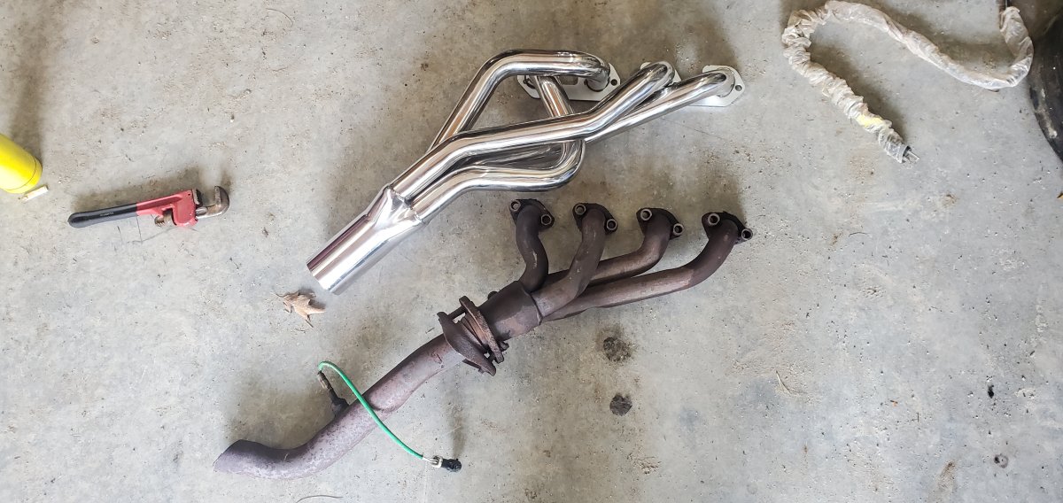

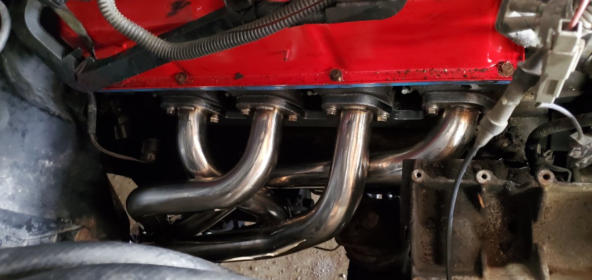

100$ communistical mid length header advertised to fit 74-82 pinto and 82-92 ranger... fits just fine on my 96. I'm assuming it's not listed as compatible with the 96 due to no provision for the EGR? Good enough for me šŸ‘all snugged up and happy for now. Not the easiest job.. but it'll be well worth it. Time to wash up and call it a day. We'll be back at it next weekend.
So far I've only had to swear at the egr fitting.. I'll take it.

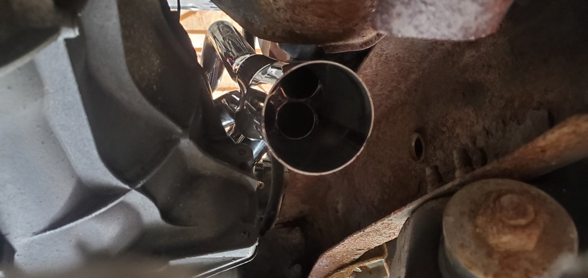

Looks like I've lucked out with where the o2 placement is as well. I was only intending on a test fit/mock up type deal with the header today because I forgot to bring along a drill and a step bit to make myself a nice little bunghole.... but stock placement is far enough back I'll be able to put it post-collector.

Is the muffler between those two flanges on the old set?
Put the roof racks on the 2011. I have a Lowe's run to make today and the 12 foot lumber won't fit in the bed.
The muffler is back behind the cab. Where I took the Sawzall to on the old set is right before the cat.

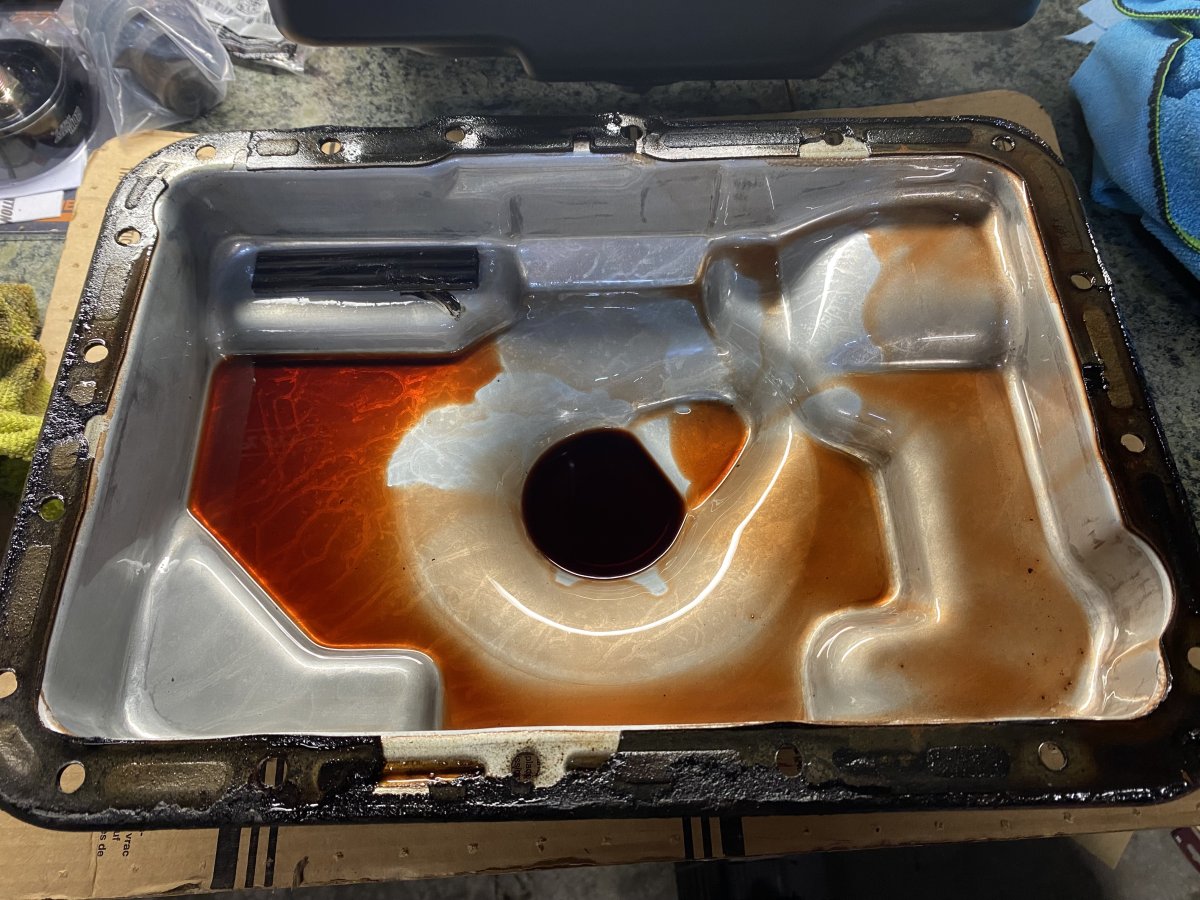

Did a transmission fluid and filter change today, along with installing a new pan that has a drain plug, so I never have to do this again. Even a drop cloth didn’t contain all of the mess.
Anyway, this is the pan, as removed, with no cleaning. On a 5R55E with 250,000 miles, and has the tow package trans cooler.
I am astounded, the previous owner really loved this thing.
Even after draining out what is left in the picture, there is no clutch material or metal shavings at the bottom. Just a very thin film on the pan itself, barely thick enough to notice. And very little on the magnet either.

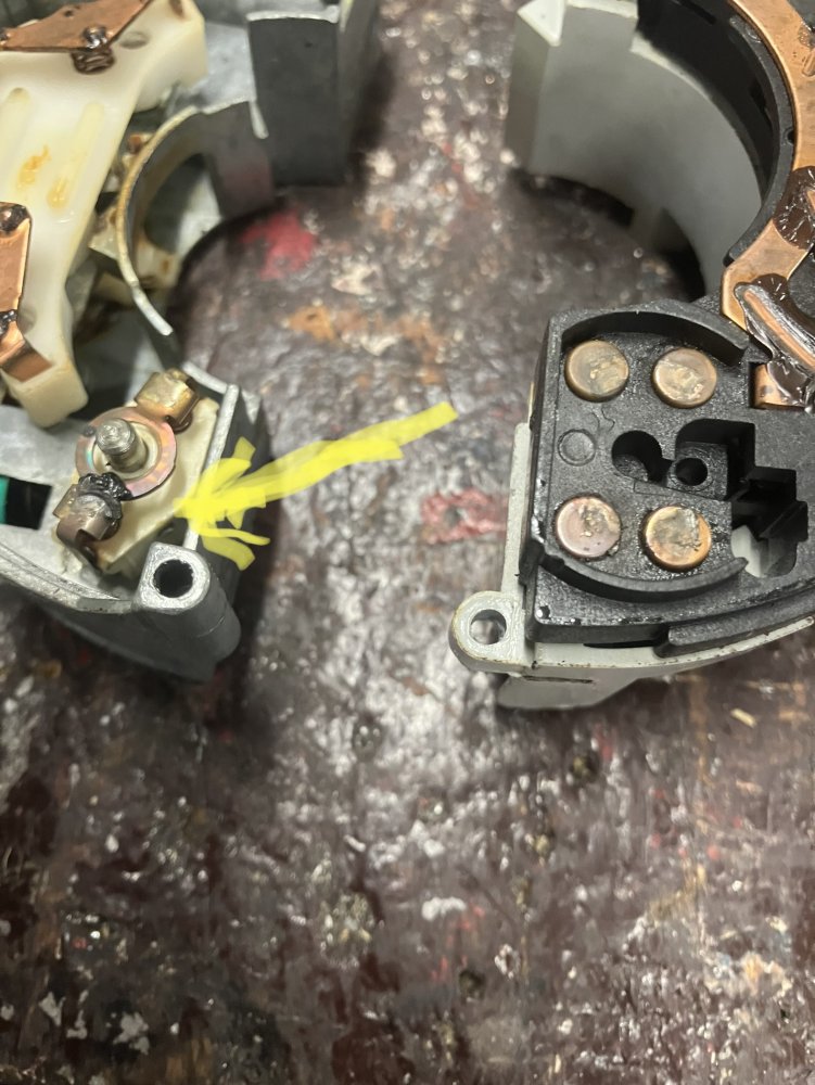

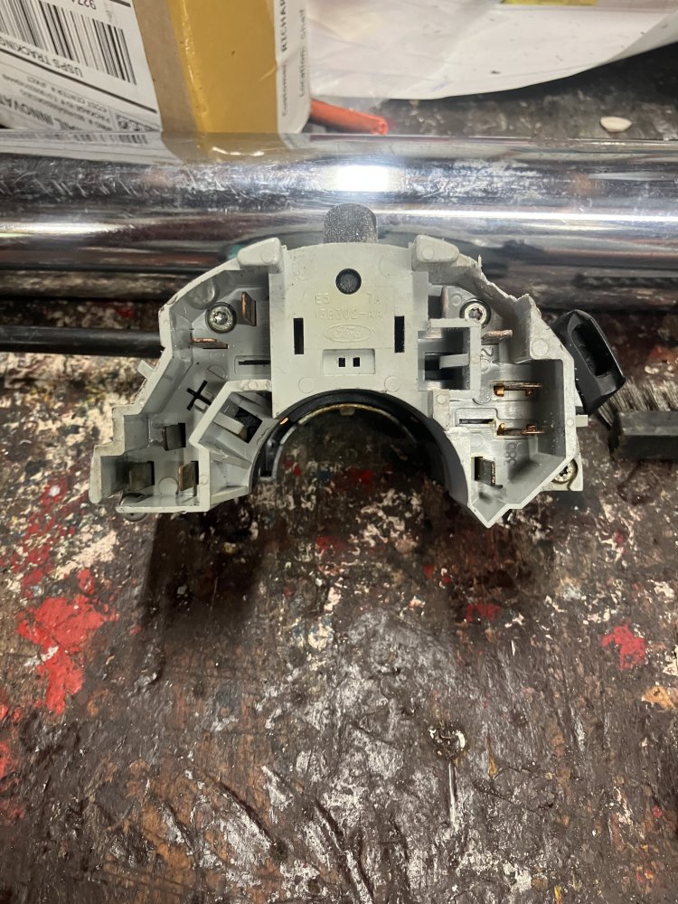

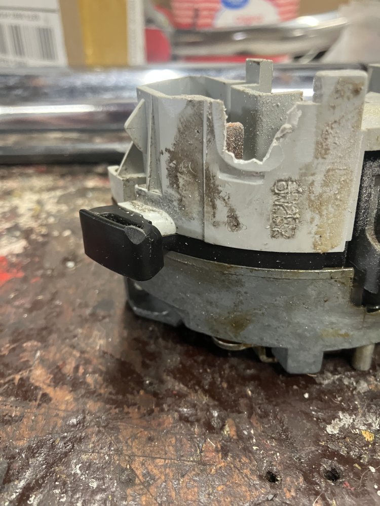

Like always, curiosity, I took the old multi function switch apart, which was also pretty simple. It has four tiny Torx screws and it comes apart in two halves. I was lucky that when I pulled it apart, the side where the plugs plug-in was laying flat on the table, and I pulled off the side closer to the driver. If you do it the other way around, some contacts for the turn signals fall out.
I had to break out a tiny bit of the gray plastic at one spot to get my Torx bit and holder down to that one screw.

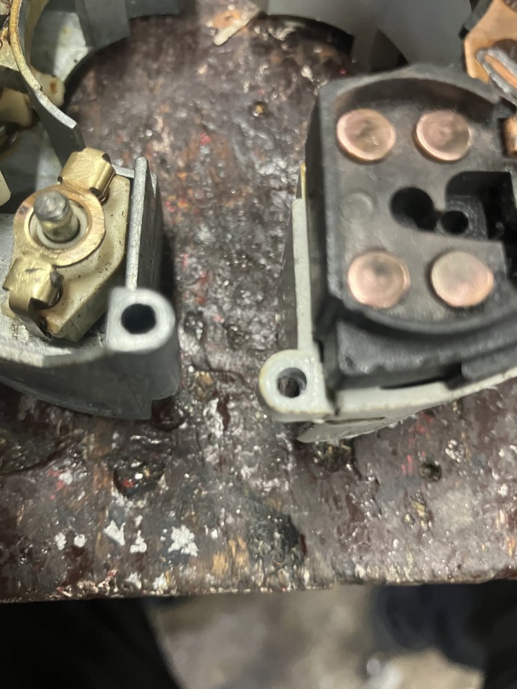

The low beam/high beam contacts are a simple little pivot bar that snaps back-and-forth on four contacts. Obviously, one side of the contacts are tied together because there’s only three bayonet connectors on the outside.

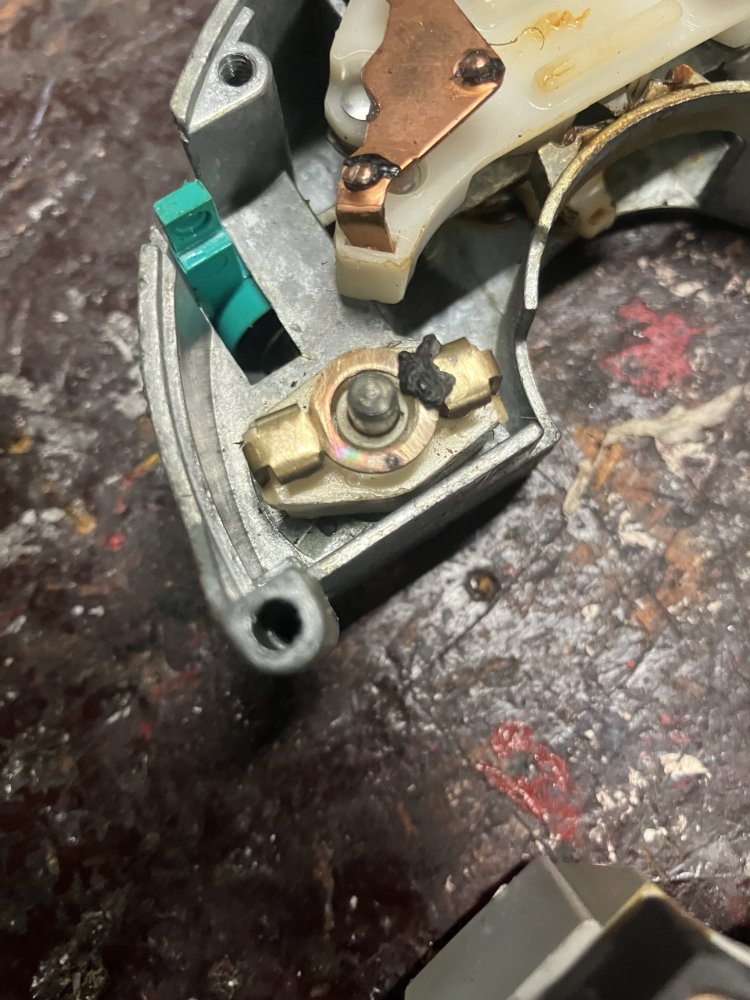

We all know what a set of burnt contacts looks like, but these actually looked pretty clean. There was a spot on the bar side, something black and built up almost like a piece of plastic. I think it might be dried and burnt grease they used to lube the contacts. It was hard like a rock, and I think it was just preventing the bar from pushing down on the Contacts when it flipped.
I picked that off with a pick, and then used my Dremel Moto tool with a tiny wire brush to clean all the contacts on the inside, and the bayonet connectors on the outside.
There is no doubt in my mind that it will work perfectly, so I put it on the shelf as a spare.
I had assumed it was going to be all kinds of printed circuit boards and such, but I should’ve realized it would be pretty simple from a 1987. If I had known, I could’ve saved my $30, and it would’ve taken 15 minutes longer than swapping it with the new one.
