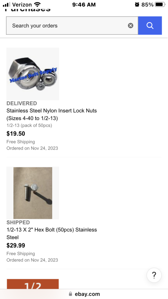

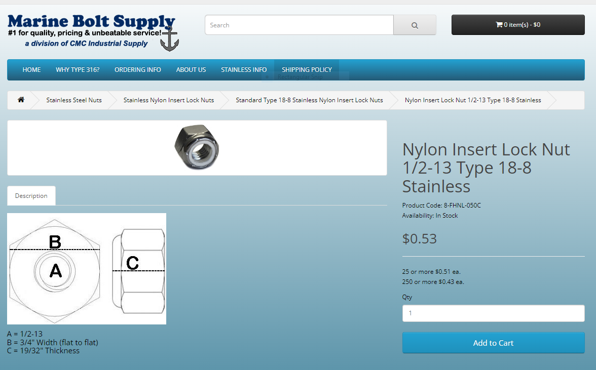

I am curious what it cost you to acquire that big bag of big nuts.
Website is on the bag in the picture

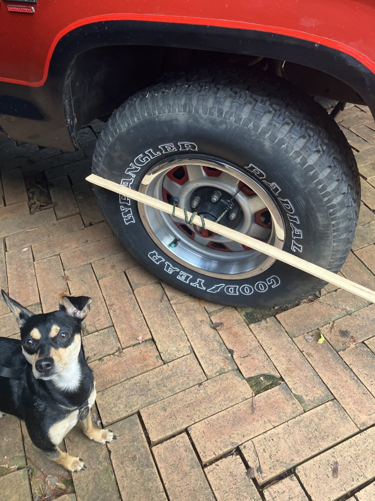

After a quick test ride, I used the DDS&B* alignment method and got the tires pointing in the same direction.
*Deluxe Double Stick & Bungee.” I bungee a straight edge on each of the front wheels/tires, and let them stick out about 3 feet. I measure the width close to the tire, and then I measure the width close to the tip. When the measurements come within about 1/16 of an inch of each other, it’s straighter than anything else on the truck.
Then I ran up and down the road a couple more times, and adjusted it, so the steering wheel was centered. I’ll check it again in a couple days.

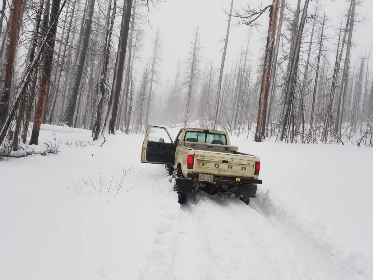

Went into the mountains yesterday with the '90 Ranger to play in the snow as planned and the snow was pretty decent, could have been better but could have been worse too... somewhere around 24" of snow and we were breaking trail for many miles between the two of us, good times! Ranger did pretty good, the radius arm bushings are SHOT and there's something squeaking on the passenger side axle shaft, that'll take some investigation... I only took a couple pics, might post them later...

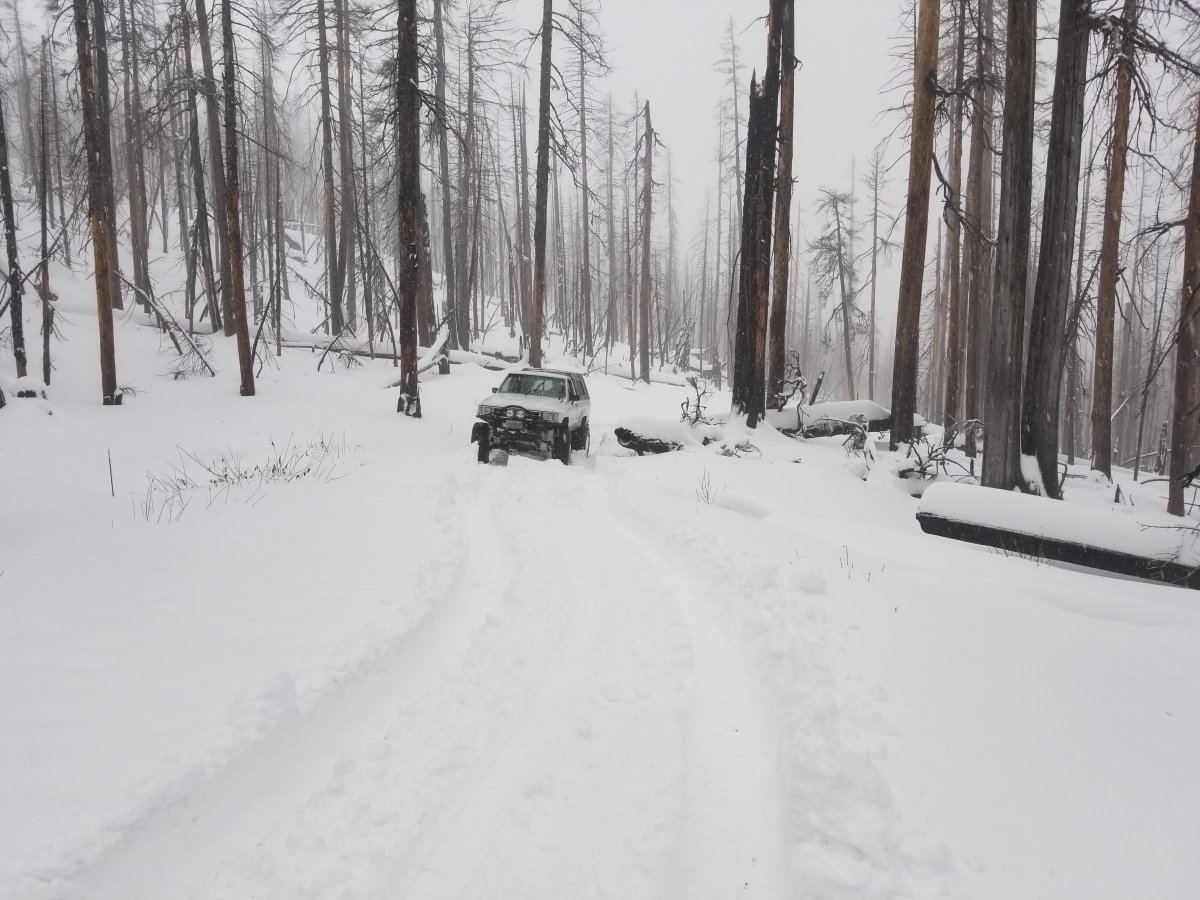

Here's a pic of my Ranger and my buddies Yota from yesterday, didn't do anything with it today other than unpack some stuff... This is in an area from the 2020 wildfires in Oregon, hadn't been there since before the fires...

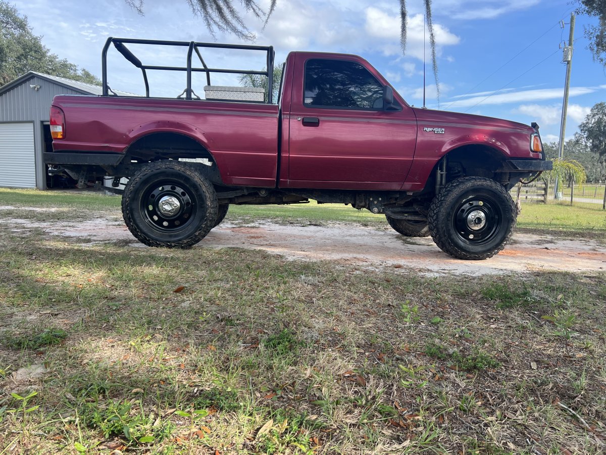

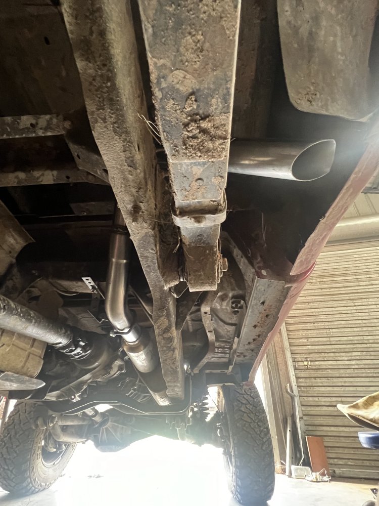

Built a new exhaust that’s completely tucked above the frame, quiet as stock despite having long tubes and no cats, and has fairly good flowing muffler/resonator combo, without touching the frame or body at any point. This and getting an alignment tomorrow were about the last two things on my to do list before we take it two hours south for our anniversary getaway this weekend.

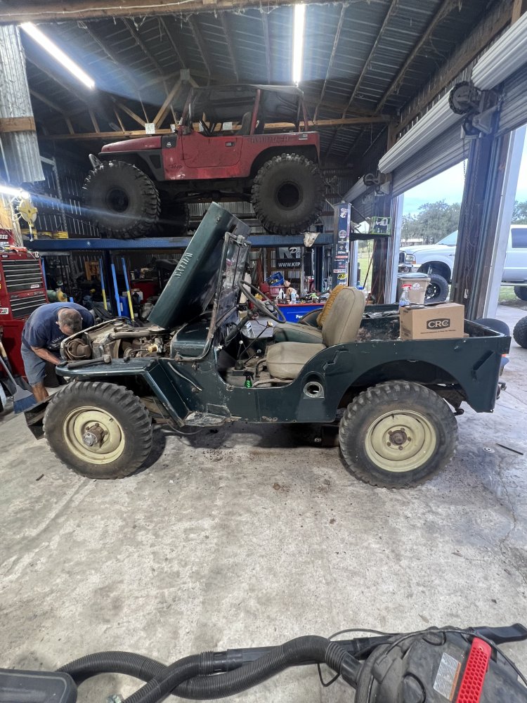

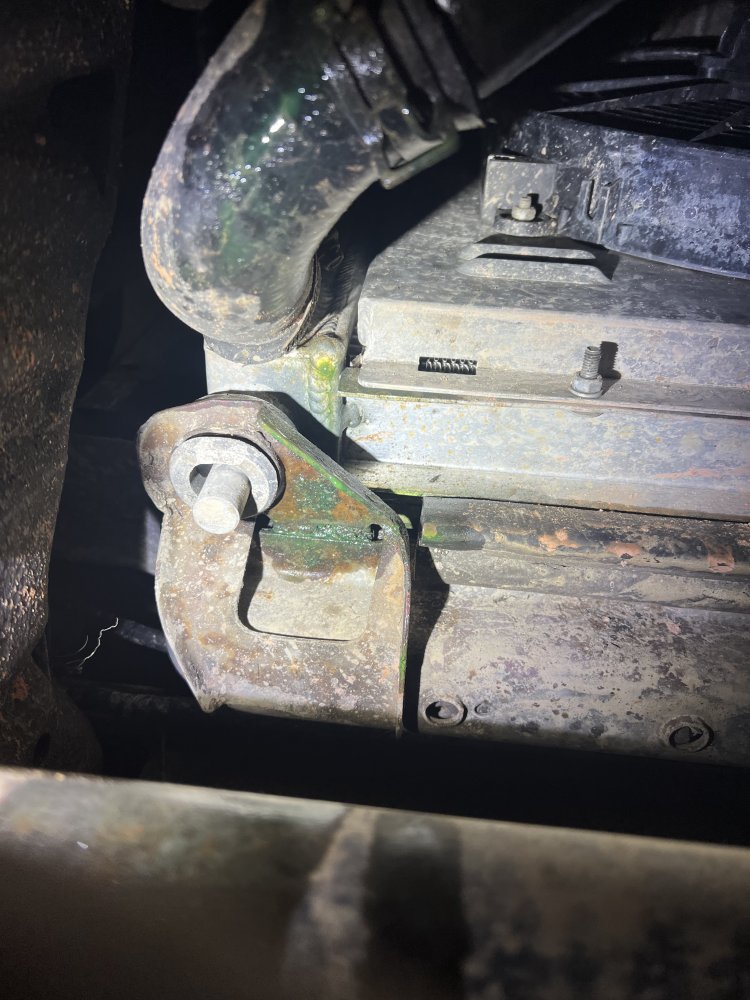

Then I pulled over to my neighbors house to check out his new 1948 Willys and noticed my AC had quit, and it appears the condenser has begun to leak with no provocation. This is a new unit only a year old, is this a common failure anyone knows about?

Your picture of the leak appears to be green coolant at thr bottom corner of the radiator. What makes you think it's an A/C condenser leak other than the coincidence of the A/C not working?
Nice truck, by the way.
Thank you I’ve worked hard on it!
It’s definitely the UV dye that was in the AC system, I hit it with black light and it glows extra bright, ac pressures are near 0, plus my coolant is topped off still.
I’m guessing the leak is from the corner of the condenser because I can’t see the leak anywhere except right in this corner which is mostly covered by the rusty core support. I have a new one enroute hoping to get it installed by Friday before bed time.
