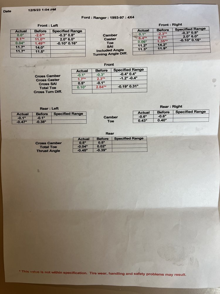

Hey alignment gurus how does this look? Just picked it up and can’t believe that I can go down the road straight with the wheel centered for the first time since I owned the truck!
I guess nothing concerns me much except the 2* more caster on one side vs the other, but that shouldn’t affect tire wear.

I’m assuming you’re referring to the 0.0* of camber? Or the almost 0.0 toe lol. I’m pretty happy, I got a phone calling in the ride home so I didn’t get to hear if it’s quieter now at higher speeds but I’m assuming so. The tire noise was getting pretty loud and they are basically new tires less than 3k miles.
Well, with the excessive toe in that it had previously, it must have been hard to keep straight on the road, and it would wear the front tires pretty quickly, so its clearly a huge improvement. I personally like a bit more toe-in than where they set it, but as long as it doesn't wander then you are fine.
The caster is more than it should be, and that tends to make the tracking unstable at high speeds, but a Ranger doesn't really ever get to high speeds, so you probably will not have any problems with the caster or the caster variation from side to side.
I'm a little concerned about how they think your solid rear axle has different readings post-alignment than it did pre-alignment, but I guess that is just telling us the printout has more precision than the precision of the measurements actually has.
Oh yes previously it was fairly S**t to drive as far as steering at speed goes. Finally got a good 10miles in this morning to pay close attention to everything and the first thing is the wheel is centered and all my hard work replacing every steering component minus the box paid off! There’s no slop at all, despite how it felt before the alignment where there appeared to be a bit of slop or numbness in the steering.
Second thing I noticed is I could listen and sing along to Chris Stapleton this morning at only 13 volume vs the previous 20vol I would need at speed to hear over the alignment eating my tires. I was actually preparing to step down to an RT or AT tire thinking it was just these MTs getting loud after 3k miles.
Third is the that the truck looks right, I think it may be a tad taller now.
I still need to see how funky the alignment gets when I back into a spot, and also try full lock left turns. The driver front was rubbing on the radius arm at full lock previously, but I suspect it was alignment related since the passenger side never did it.

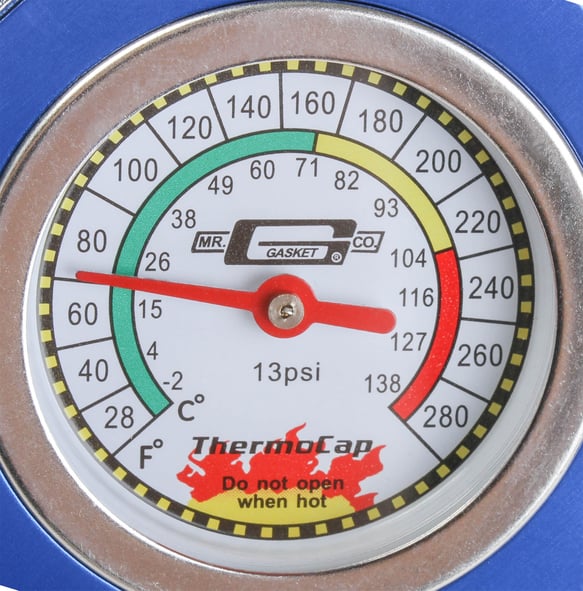

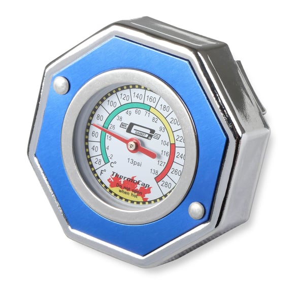

Stumbled on this on Hemmings Auctions Daily on a BII, did a little research on the web & pulled the trigger on 1 for my Ranger.
I didn't know they exsisted ! Pretty neat & useful addition I think. 😀 Good price too. Ebay has an OBB listing for $19.99.
Pretty cheap ! They come in 4 different colors (Silver, Blue, Red & Black) with the letter(s) stating the color @ the end of the part #.
I got the 2470B, the blue 1. I think they come in 16psi too.
Mr. Gasket 2470B Domestic Thermocap 13 Psi-Blue | eBay
View attachment 102722View attachment 102723View attachment 102724
Be careful with that. You're getting the radiator temp. The engine temp will be hotter.
