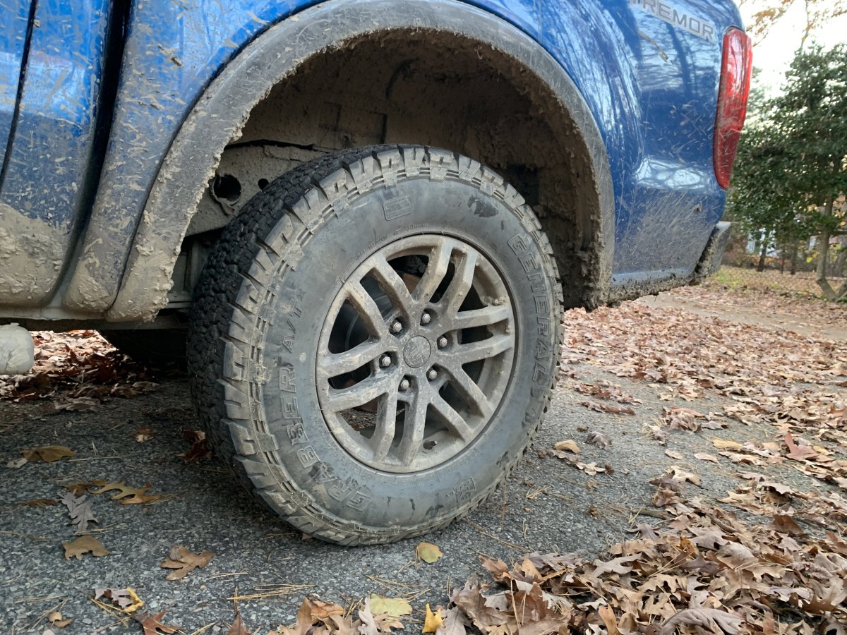

I hosed off all the trail mud and dust that was on the 2011. There was quite a bit up under the truck for some reason, one would figure all the deepish water we went through would have washed that off...
No, the water didn’t do anything. This isn’t regular mud, it’s coal dust.
Yep, pretty much what mine looked like. The engine bay was really coated in dust. So I hosed it off too. It was so bad I couldn't read any of the markings on the fluid reservoirs. I generally don't like hosing out the engine bay but didn't have a choice this time.
