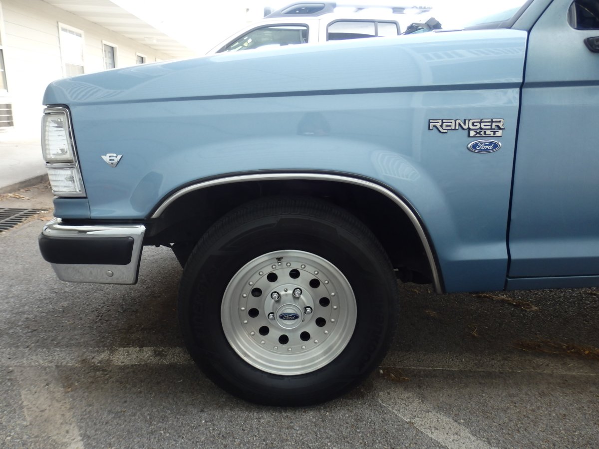

Trim from a Taurus trunk lid.
Thanks guys ! It's actually a blue oval over the area where the flush one was. It gives it a little more dimension.
Sometimes the little things can add a nice touch. (Cheap too !!)
I've done several to my truck & sometimes I think I go a little ovalboard but I don't care, It's my truck !
