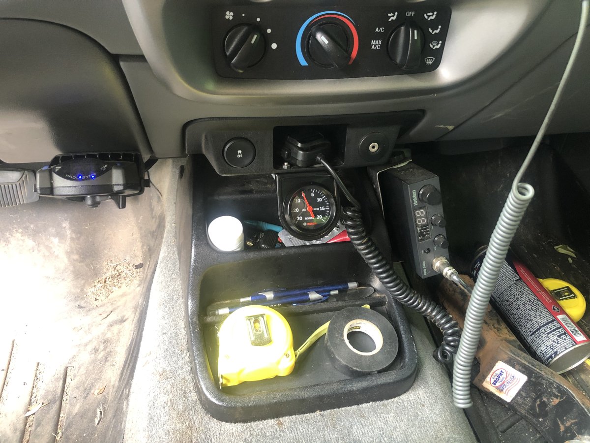

Mounted this vacuum/ boost gage in my blue ranger. Not plumbed in yet because I don’t feel like removing the intake to get at the free vacuum ports.

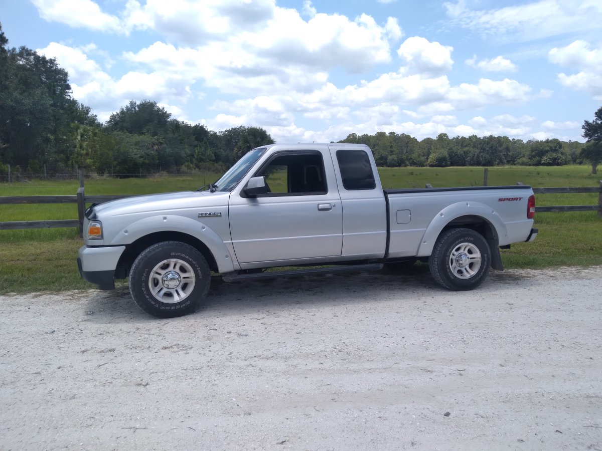

On Saturday (was really tired after the trip and slept a lot on Sunday, so sorry about the late post) I drove the Ranger down to Ocracoke on the Outer Banks of North Carolina. This was a 400+ mile round trip. Left at midnight Saturday morning and got back at about 8 pm after a side stop in Virginia Beach.
The big V-6 managed 24.2 miles per gallon, and that was with the A/C on most of the time. I won't bore you with my tricks for saving fuel, but this ain't bad for that engine. And no, I drove the speed limits the whole trip.

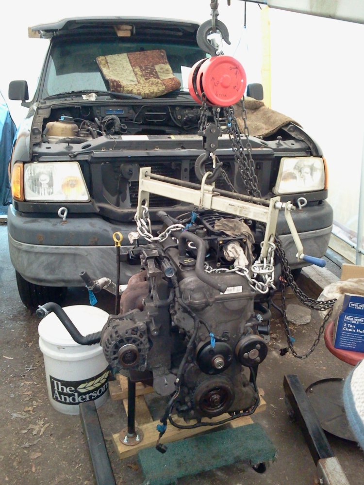

it's putting up a fight for the last inch and a half. can't get the input shaft into the clutch disk.
time for plan B
i'm a gonna take a nap

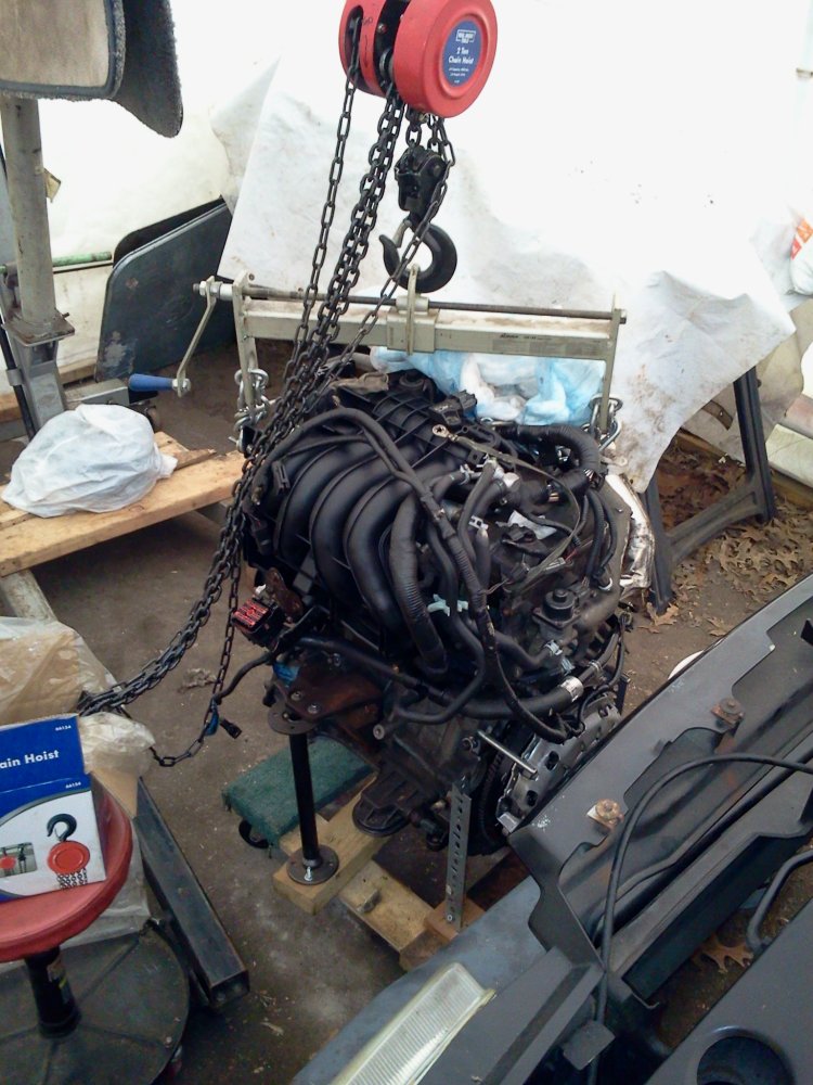

this engine being a 2002 has an aluminum valve cover, which has a different sized nipple for the crankcase vent than my 2005 engine did. which is why I have a piece of heater hose stuck on it.
the tranny is still mounted at the rear. I'm going to move it back and set the motor on the mounts then slide the tranny back forward. maybe
had to take the oil filter adapter off, way too much in the way during installation.

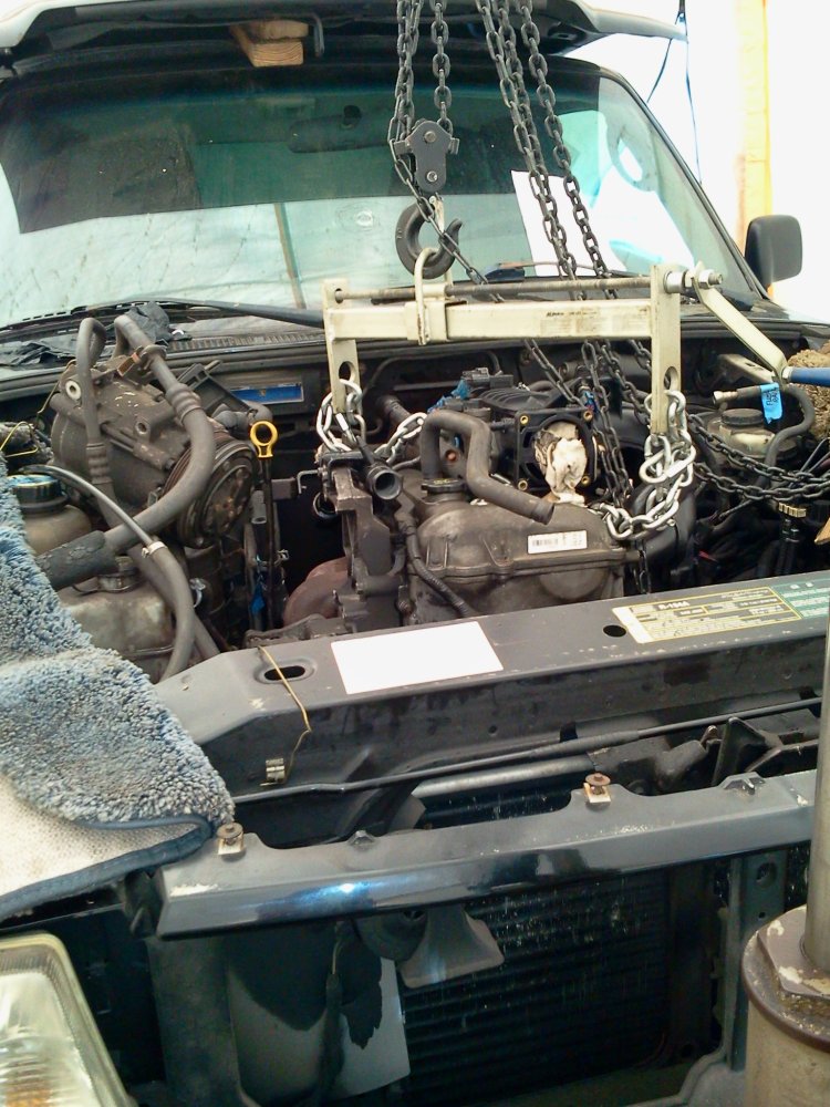

time for plan B
If you're doing it by yourself getting the splines and pilot bearing aligned can be a pain. If you've got a helper, once you get the input shaft thru the clutch, you can hold against it and have the helper press the clutch a little to help free everything up. A little wiggling and it'll slide right in. You can also turn the output shaft with the tranny in gear if the driveshaft is out. But again you need a helper.
I'm running solo on this. already decided it would be easier to pull the tranny, then set the engine on the mounts. tomorrow I'll put an adapter on the floor jack to hold the tranny.
as it is now the engine is on the mounts while still suspended and the tranny is out.
it's much easier to mate the tranny to the engine than it is to mate the engine to the tranny.
I will prevail :annoyed:
It always seems like a fight to mate the two, I’ve done it so many times. Always seems like even if you can get it to slide together, then you have trouble getting the bolts lined up. I’m usually flying solo on it too. Just a pain. Getting to the point where I’m going to be inclined to pull and set the engine and trans as a unit and bolt/unbolt them out of the vehicle
