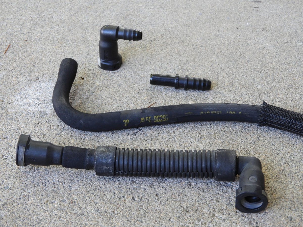

I replaced the hose that connects the evaporative purge valve because I rigged a magic smoke machine to find vacuum leaks and I think a little bit of magic smoke was coming through part of the hose. This hose looks like one of those repairs that looks like it is going to be difficult because the OEM hose appears to be glued on to the connectors on each end. I did a search to find out what others have done to repair these hoses and there isn't much information, but other people think they are stuck with buying the hose from a Ford dealership. A few people had very bad things to day about Ford because they paid quite a bit of money to replace it. The hose on the 2.3L Duratec comes in two sections. After I took it apart I search for the part number to see what would come up. The part number on the longer hose is 4L5E-9G297. Pricing starts at around $45 on the websites that sell discounted Motorcraft or Mazda parts. That's just for the longer hose. The shorter hose probably cost another $20, plus shipping.
For those who haven't figured this out, here's a $6.00 fix for a $65.00 problem. The side of the connectors that appear to be glued into the original hose are actually 3/8" automotive vacuum hose fittings, so the hose you need to replace it is 3/8" inner diameter PCV/EEC/fuel line hose. I didn't measure the length. I just walked into an auto parts store and bought 3 feet of it, then cut it to fit, then slipped the connectors back on the hose. I reused the braided sleeve from the original hose and the corrugated loom on the shorter hose.
