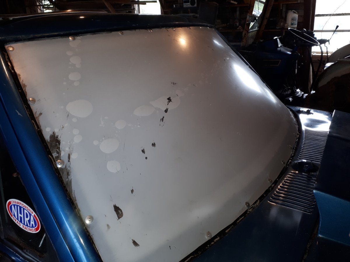

Finally got my Lexan windshield installed. Still have to put the chrome trim back on but I'm sure glad this job is finally over. I fought for two days getting the original(cracked) glass out and had to use every tool and every method I saw on YouTube. That black is just paint streaks on the protective film.

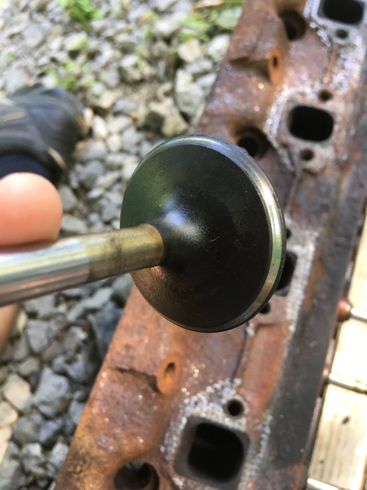

But anyway, back to the green Ranger. I decided to give the valves a quick spin with some grinding compound before cleaning the head and putting it back together. For the most part, so far the intake valves are pretty, but the exhaust valves are pitted up. They aren’t cleaning up as well as I’d like, but they should do alright, it was more of a well, since it’s apart… lol. Unfortunately one intake valve looks questionable. It has a chunk missing that looks like it was probably there from the factory and it’s not making good contact with the seat. Slides good though, no binding or play. Not sure if I should give it a good grind and send it or just replace it.
If you replace one valve, rule of thumb says replace them all. Same with lifters, valve springs, etc. Don't replace just one. Call it the "Lay's potato chip" rule.
On one hand I fully agree. On the other hand, I need this motor back together and running. It only has to run long enough for me to build a motor specifically for this truck. Which will hopefully happen this winter. I’d like it to last longer than that, but once I have what I want built, it’s less of a concern. Right now budget and time are tight.
My thoughts: well if your *going* to have a valve that may leak a bit , better to be a exhaust than a intake. Since its a “for now” Id say use what you have on hand of the best parts. If it was a more “permanent “ engine it would be a different story.

Nothing is so permanent as the item that is continually and frequently labeled "temporary".
There is this… and knowing my luck it will be temporarily permanent
