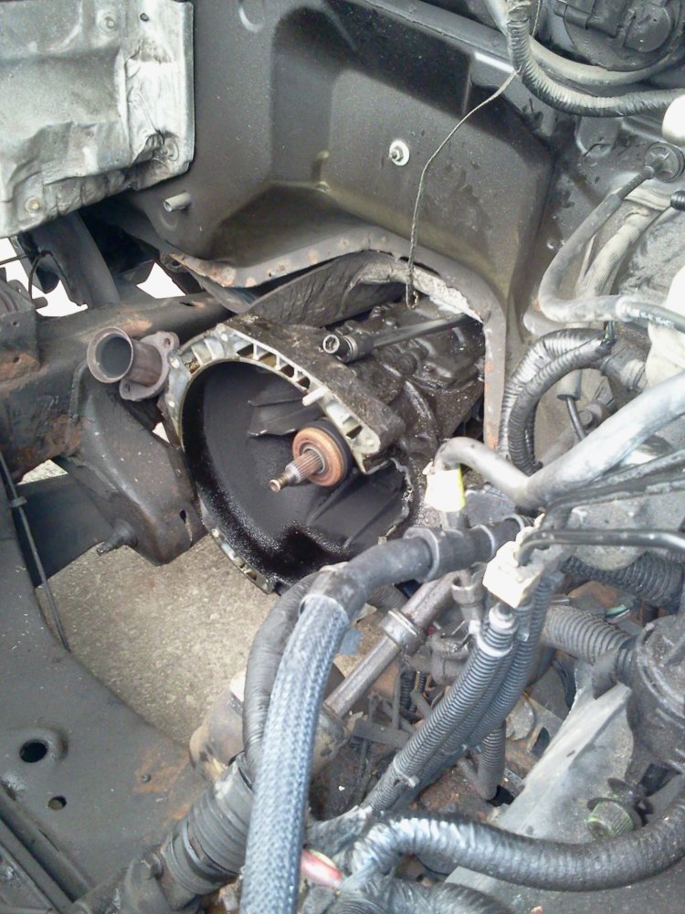

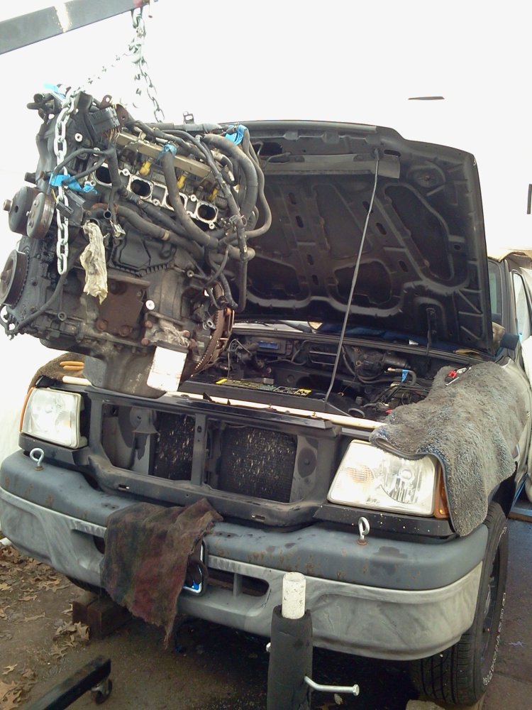

I left the tranny in. it's still attached to the cross member, front is at normal height.
there is plenty of room to get the 2 upper bell housing bolts if you use a 30" extension with wobble socket.
go over the tranny, you will have to work blind and put the socket on the bolts by feel, from under the bell housing.
the bolt behind the pass side exhaust manifold can be accessed with a 24" extension & wobble socket going over the motor mount, between the AC/ALT bracket & block.

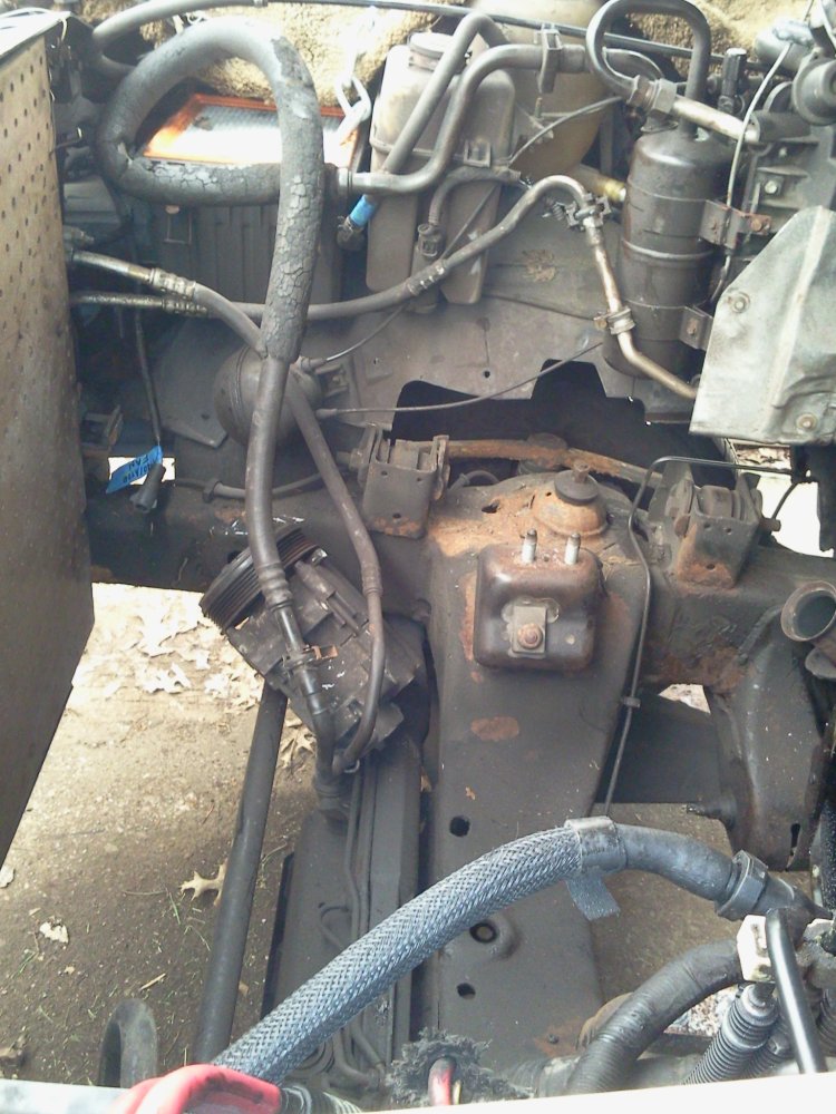

AC is still intact too.
