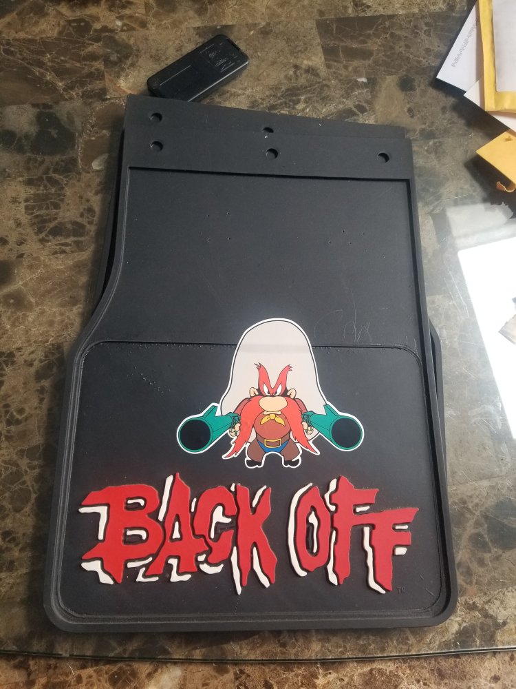

I really think those mud flaps increase the desire to tailgate you...
Wow... I thought they stopped making them around 1992.
I purchased the mudflaps and the Yosemite Sam Stickers Separately. I'll install them next week sometime. I hate when people are up my ass. Maybe they'll get the hint.
Have to get closer to see what it says. That's why wordy bumper stickers with small print are bad.
