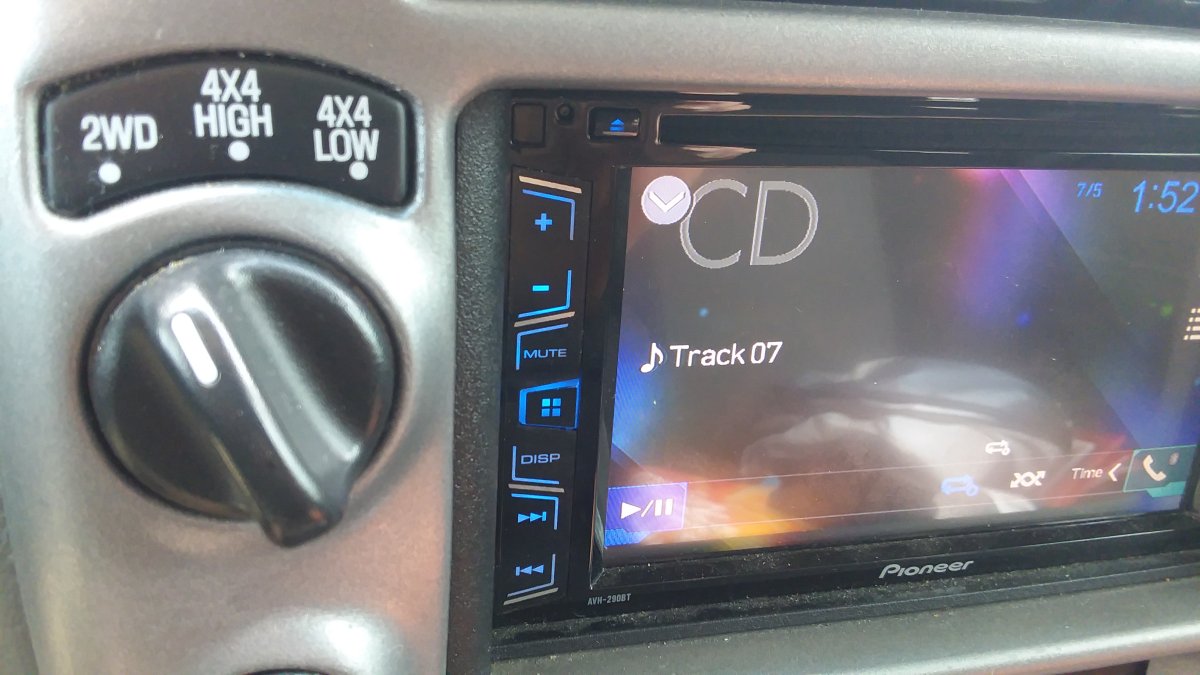

I made an embarrassing mistake. After turning into a parking lot I went to turn down the radio and I thought my power steering had failed it was so jerky. I looked under the hood but realized I had accidentally hit the 4HI switch. They are pretty close together I guess and I'm clumsy
