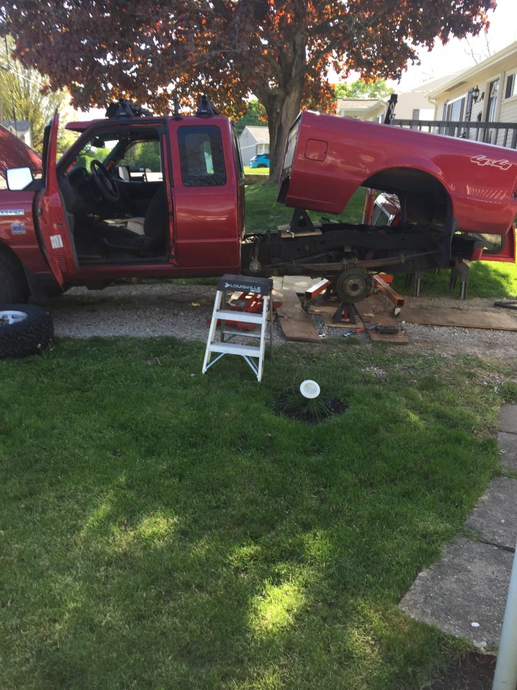

It occurred to me when I saw SgtSandman's picture above: I'll bet some of you would just love to have a tilt-bed conversion for your Rangers. :LOL:

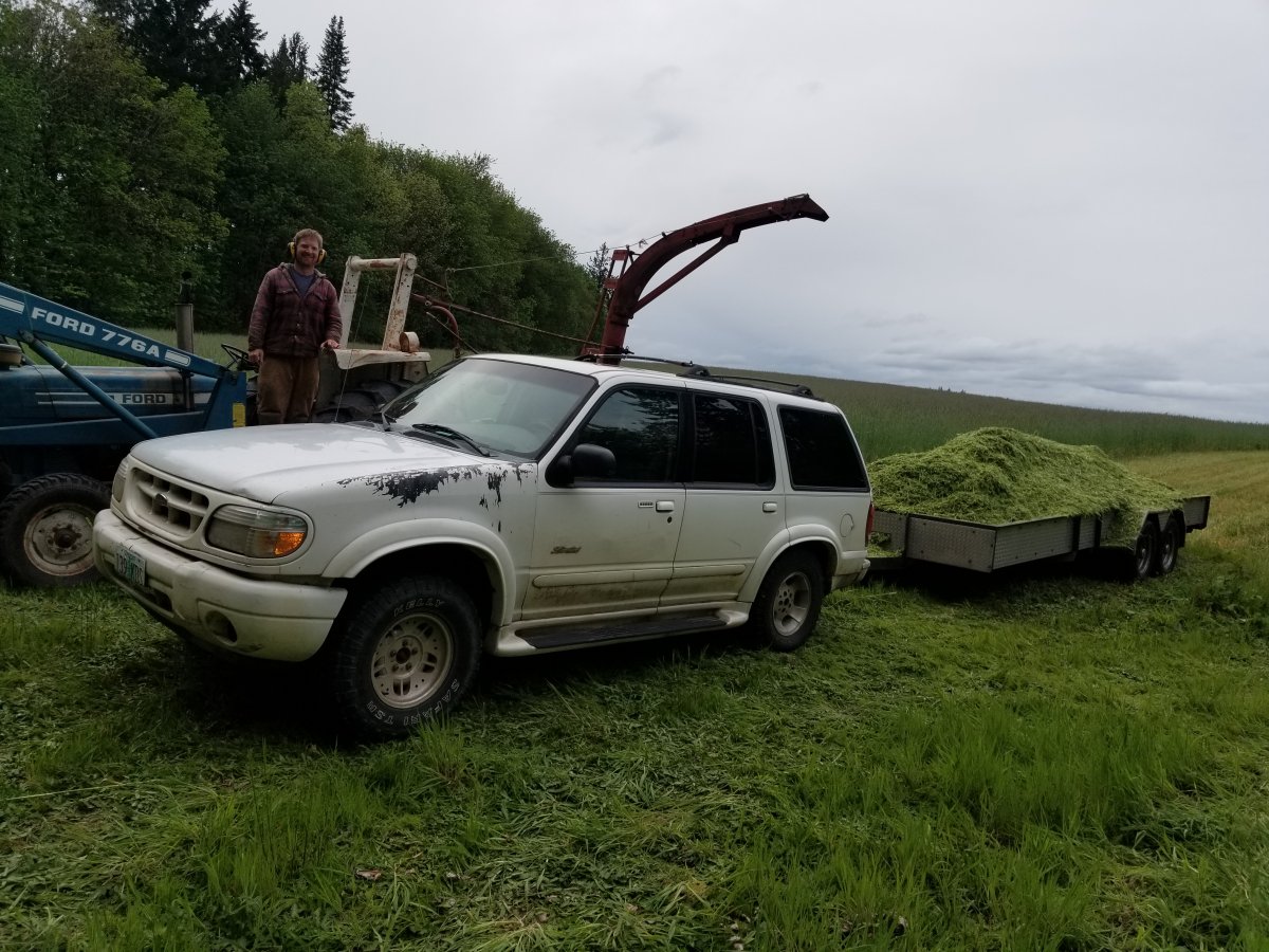

ok, here's a pic of yesterdays shenanigans'... Not sure why the "check susp" light wasn't on, it's almost always on... the air shocks are shot... For reference the trailer deck is 20' long and around 18" sides... I don't think I've taken a pic of my sweet wheel combo... deer hooves up front and Jeep out back with 5mm spacers :), tires are aired down from snow months ago so it towed like crap on the way to my brothers...
At that particular point in time, a tilt bed would have been a huge benefit.

Well that is taking a tilt bed to the extreme especially to change a fuel pump.
Hey man, it was the 90's. Everything was "taking it to the extreme".
