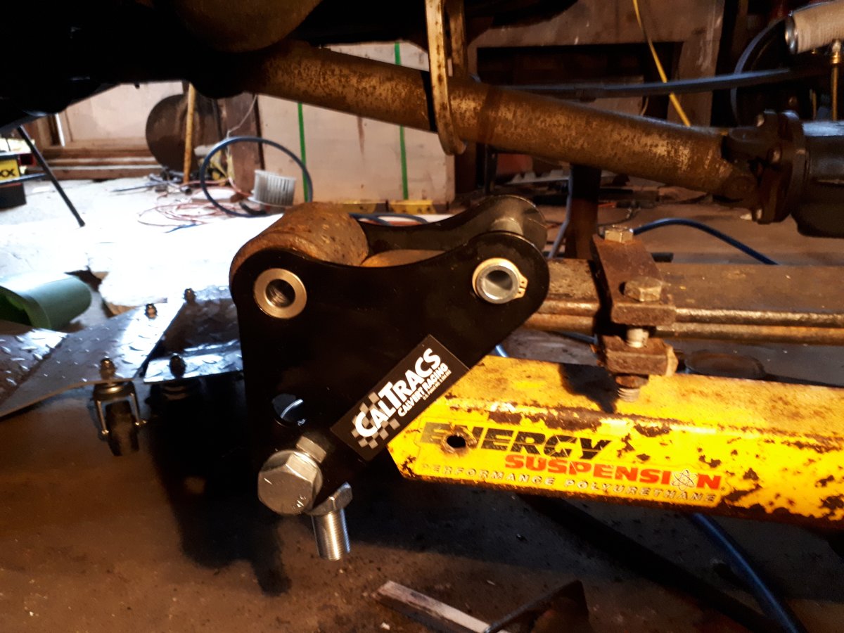

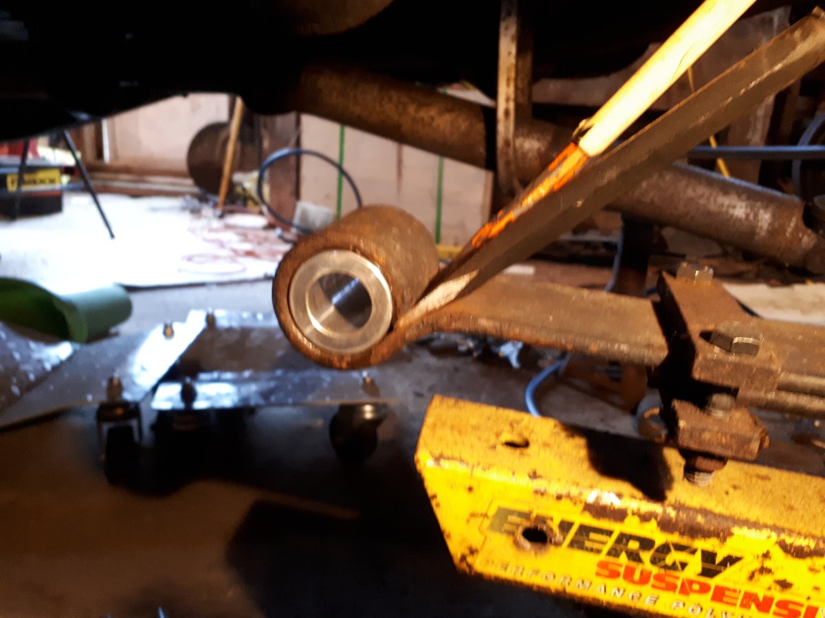

Got the front half of the CalTracs bars installed this AM. Next we jack it up in place, put in the spring eye bolts then replace the old slapper bars with the rest of the CalTracs system. I contacted the help line at Calvert Racing and they told me to leave my spring clamps in place. Spring pack consists of only the stock main and one slightly thicker second ply that took the local spring shop a few tries to get the arch right for the ride height I wanted.
