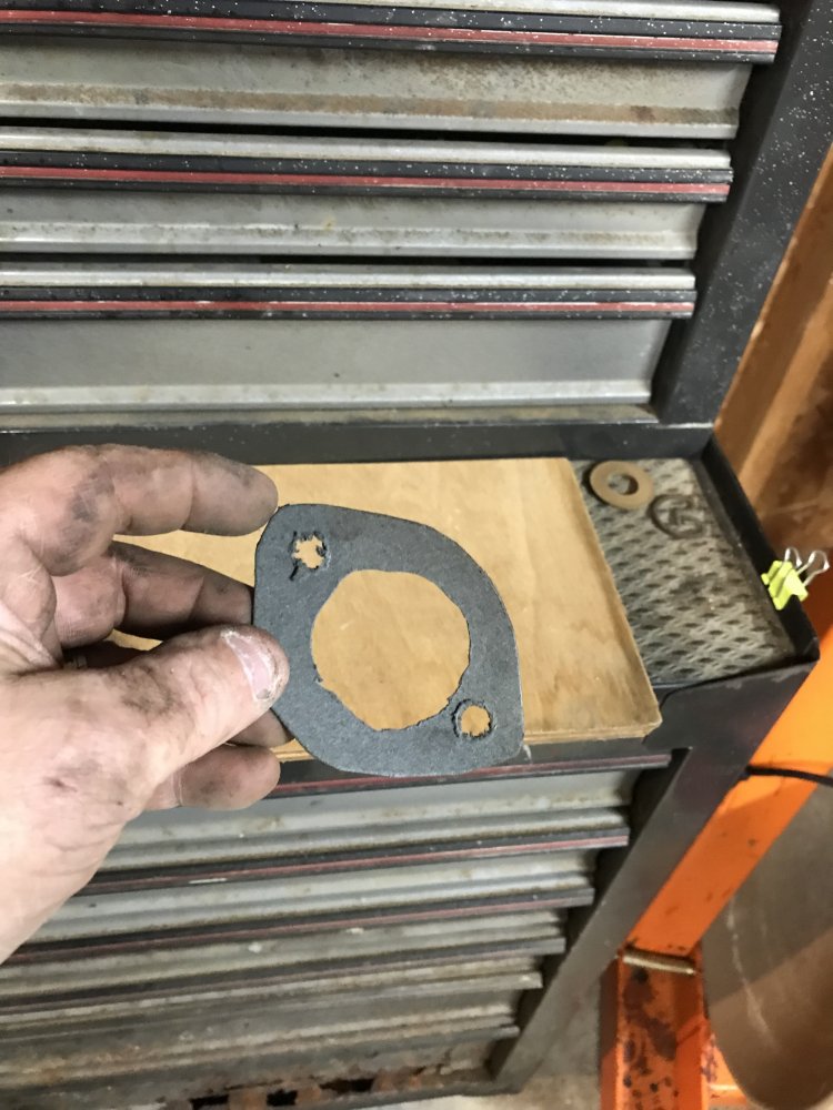

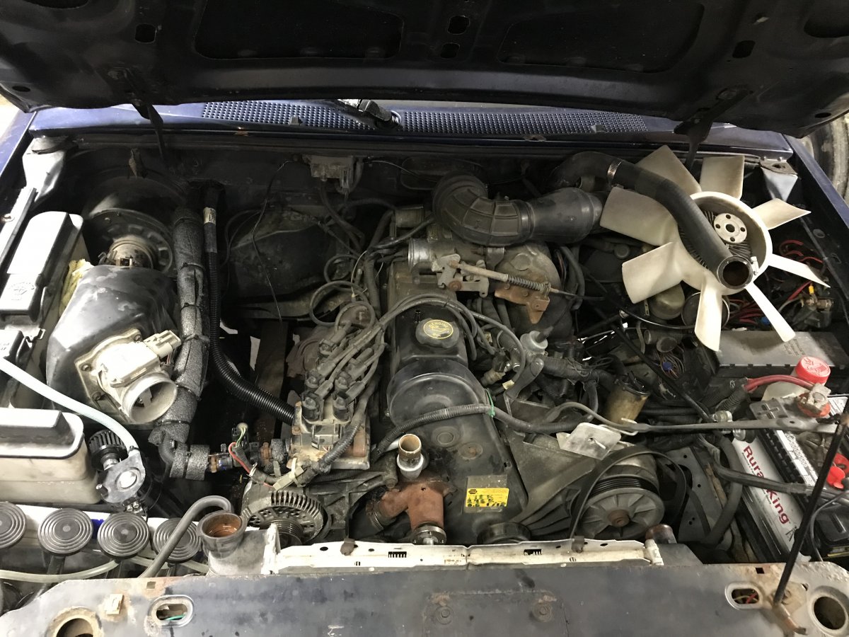

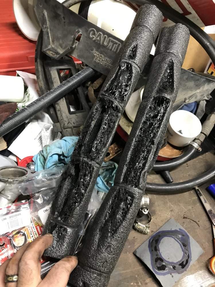

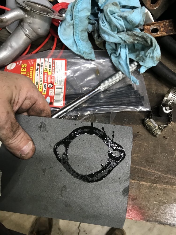

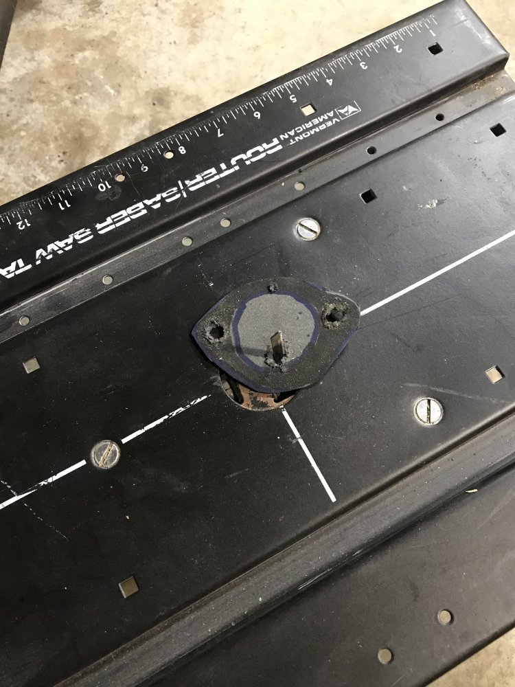

Got the ranger mostly back together. Decided to call it a night before I heard from the house “do you know what time it is?!” Yes, I do have a clock in the garage, and I know its not really a question. I still need to put fan back on, the fan shroud peice , air intake hose , upper radiator hose, belt and fill with coolant. I didnt have a gasket to go between therm housing & block and had to make one. old thermostat was indeed a 192, even though I ordered a 195 I saw the new one says 192. Oh well, one issue I think iis now fixed is a removed restriction. Back when I first got the truck I tried putting a inline 120V coolant heater on it. Didnt go as planned and I removed it, where I cut the heater hose I had put a 90 degree pvc fitting in. So that might not be giving me good flow through the core, between the inside diameter of the fitting and it being a sharp hard 90 degree turn. All heater hoses are new now, secured with oem style spring clamps. (yes pia but effective) The foam I used as insulation had melted some, most likely from my high speed runs home last fall at 2am. ( no heat sheild on exh manifold) I used a sabre saw mounted upside down in a old router table to help make the gasket. worked well. heres a few pictures from today. More to do tomorrow, not much more and still a hell of a lot better then that 2.2 gm water pump on the hhr I just did. Oh- tech tip of the day, a hair dryer works great for warming cold hoses to ease removal. I actually bought my own to have in the bottom of the toolbox for such jobs. I did cut the circuit breaker plug off it and added a vaccum cleaner cord for more cord length.

Got the ranger back together, the good: no leaks, went together quickly . but…, the bad: still not getting warm enough, I think the issue is the thermostat doesnt fit like it should in the housing . After a 8-mile run my laser temp checker said it was only at 170. And quickly started dropping off as its idling. Just about have to pull the fan (again) to be able to work on it. When I first got the truck there was a pinhole in the neck right below the radiator hose connection . I clamped a peice of rubber there for awhile then eventually replaced the whole thing (napa part) Hopefully I can find the original & see if a thermostat fits better. I remember my ‘88 always had a bad airlocking issue when the cooling system was refilled and Ive never had that issue with this 2.3 I also could get a thermostat that fits inside the hose (ford N series tractor) I might try that first, assuming the tractor thermostat isnt a fortune. Spent rest of the day finishing a ventless propane heater project I started before thanksgiving. That stainless gas line is awesome, drilling through block isnt. My cordless harbour freight drill worked good, maybe too good. couple times it caught & spun the drill around , twisted my wrist & once it got me in the nose.
