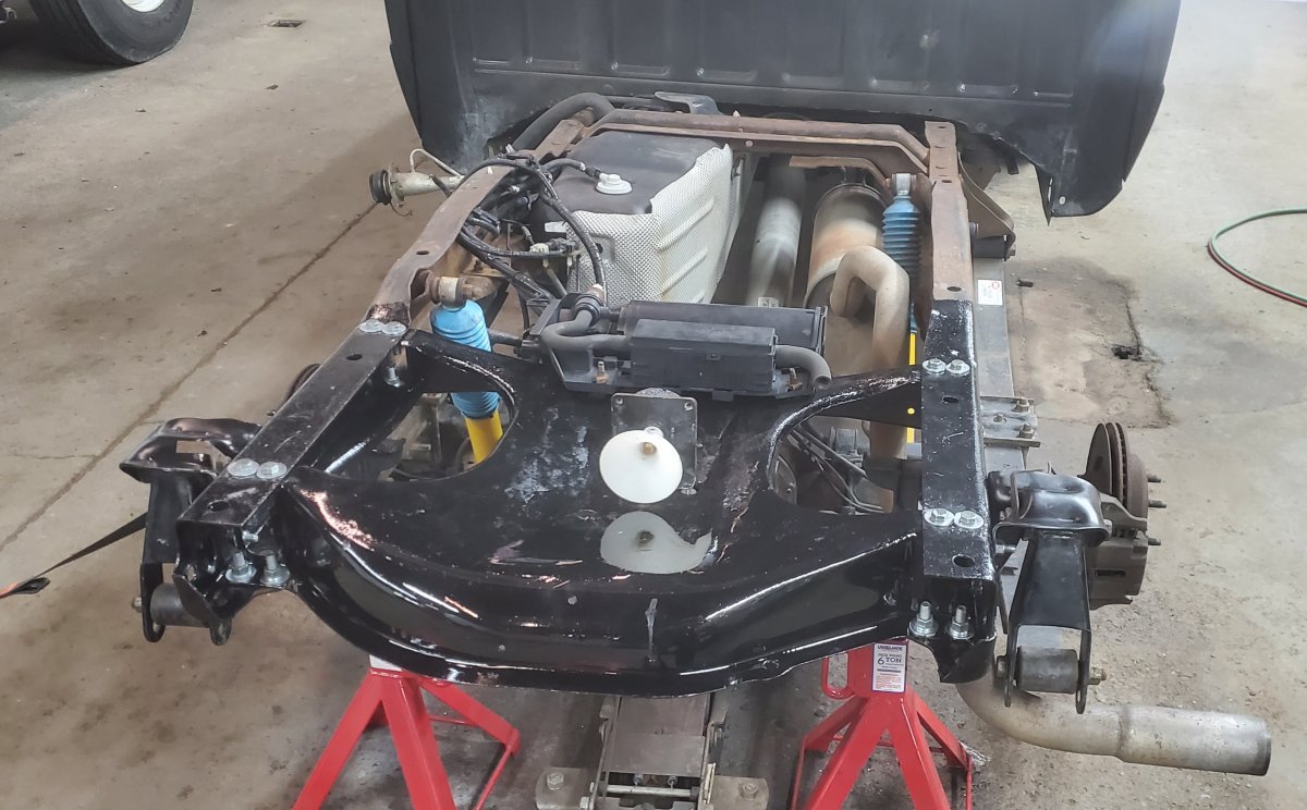

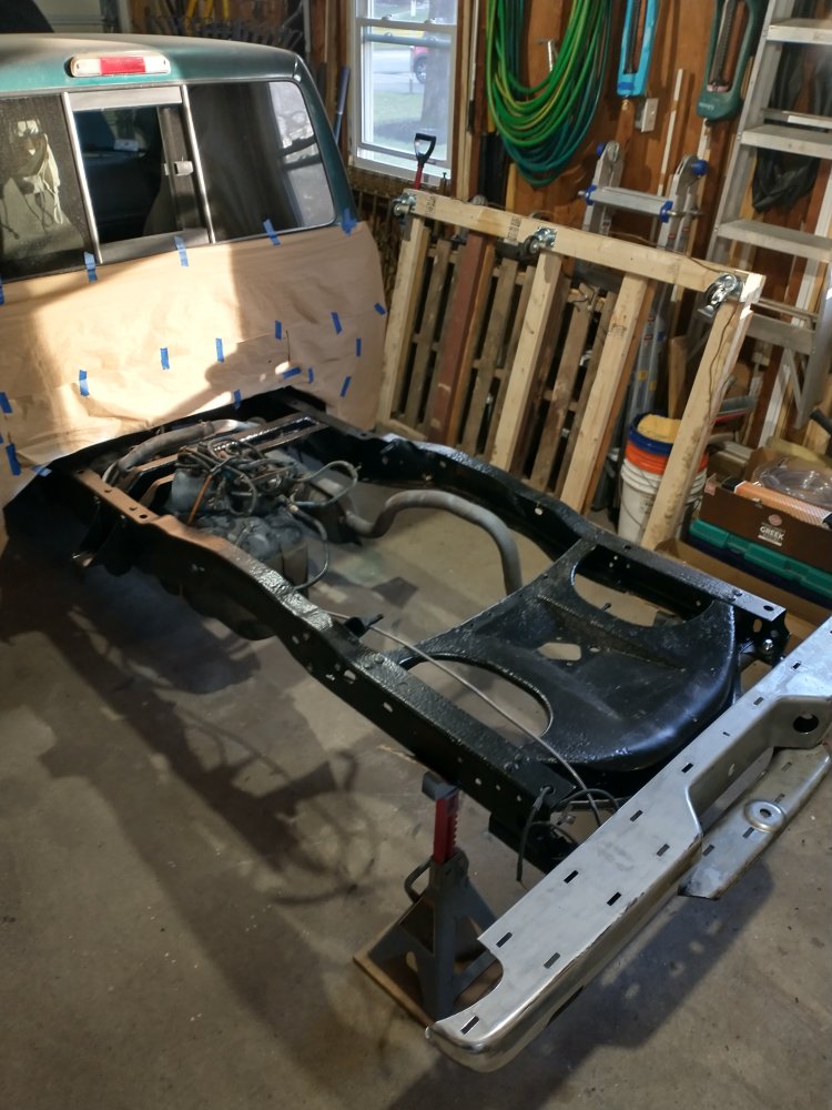

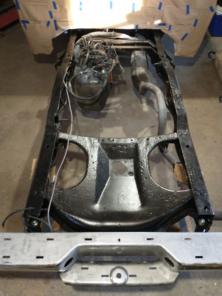

What the hell is the factory wax/tar all over this thing? Any way to clean it off chemically?
My entire frame was also coated in that black tar stuff, so I know your pain. Unfortunately cleaners alone weren't enough to remove it because it was caked on so thick. I had to use paint scrapers to scrape off the bulk of the material, and then I sprayed the remainder with POR cleaner/degreaser and used steel wire brushes to brush the frame down to the bare steel. It took me several full days underneath the vehicle cleaning, scraping, washing, and brushing to remove that stuff from the frame, and it was a nightmare.

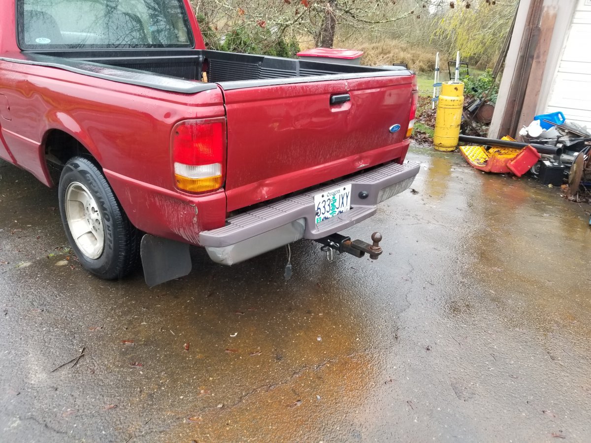

I'll think about getting a picture later but today I decided to tackle the tailgate on the '97 since it got rearended a few months ago... it wouldn't close with the linkages dragging so I needed to monkey with it... It actually straightened out better than I expected, the two dents in the bottom from their tow points are still there since you can't get to the bottom from the inside, I've got some thoughts, that's a project for another day. I was going to get another tailgate but now I'm rethinking it...
My entire frame was also coated in that black tar stuff, so I know your pain. Unfortunately cleaners alone weren't enough to remove it because it was caked on so thick. I had to use paint scrapers to scrape off the bulk of the material, and then I sprayed the remainder with POR cleaner/degreaser and used steel wire brushes to brush the frame down to the bare steel. I spent several full days underneath the vehicle cleaning, scraping, washing, and brushing to remove that stuff from the frame, and it was a nightmare.
Xylene. Takes it right off. Should have updated.

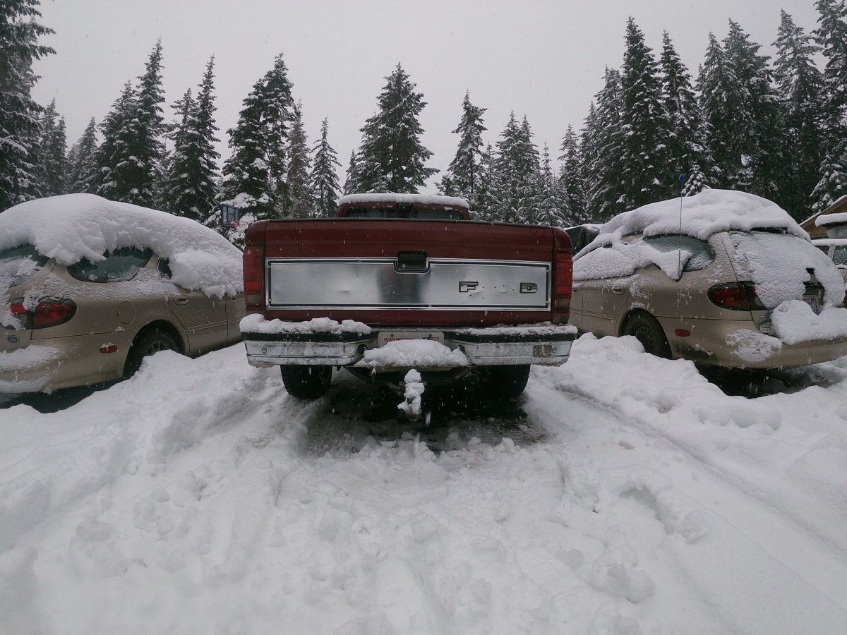

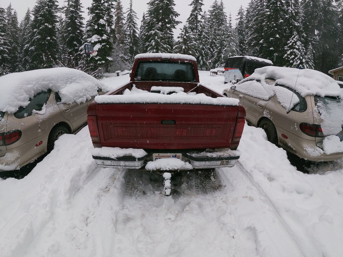

today i added tail gate trim to my 91 using some self tapers because my tailgate is off a base model and it never had trim.
Before
69491
69492
After
69493
69494
i'm still looking for the missing letters if anyone has them and willing to sell them let me know.
Here's a picture of after I straightened the tailgate some, I apparently don't have a before pic handy...
