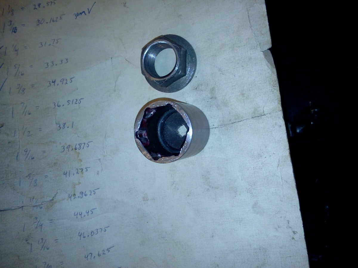

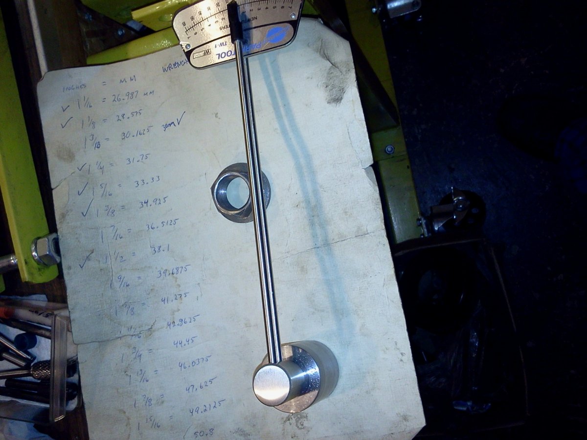

performed some tool& die creativity and made a 1/4" drive 1-1/8 " socket for the front pinion nut so I can attach my 1/4 drive inch-pound torque wrench.
if you look close the first couple of threads are missing from the nut. I ground them off to make a shim checker nut.
I should have done that instead of making a leaning tower of adapters. For next time. You make a setup bearing too?
not yet on the bearing(s).
that "socket" is made from a worn out fuser roller from one of the copiers I used to work on. it has a closed end tube.
69370
I just used a die grinder to open the center of the old bearings just enough that I could slide it on and off the pinion by hand.
