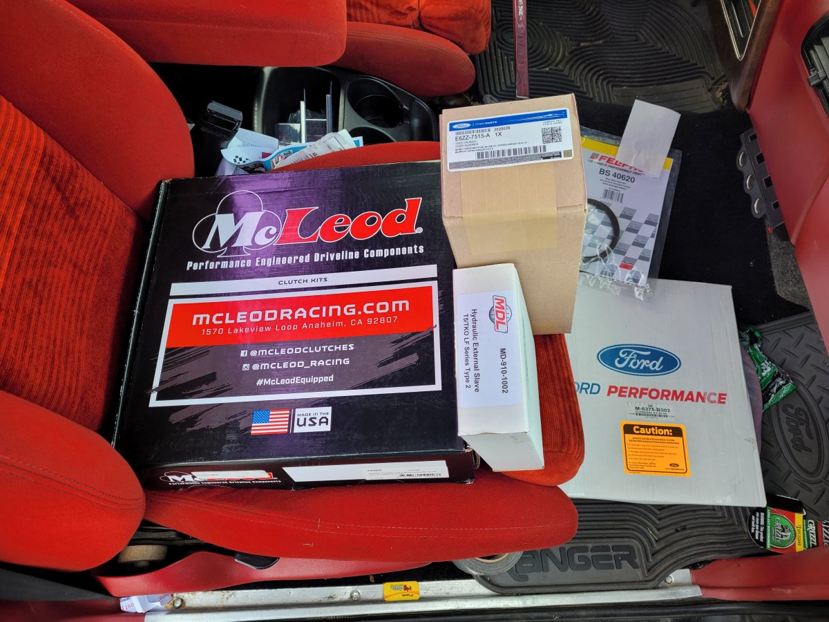

Hopefully that modern driveline kit holds up this clutch was a lil more then the last one.....
