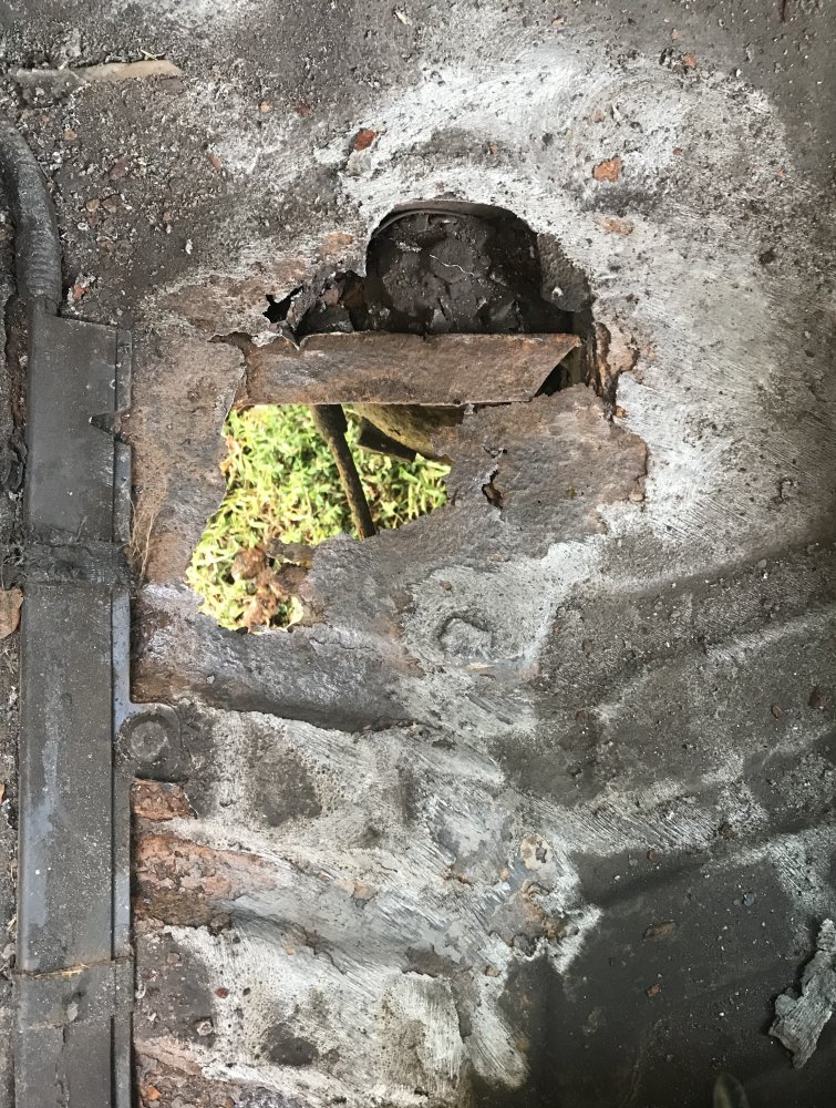

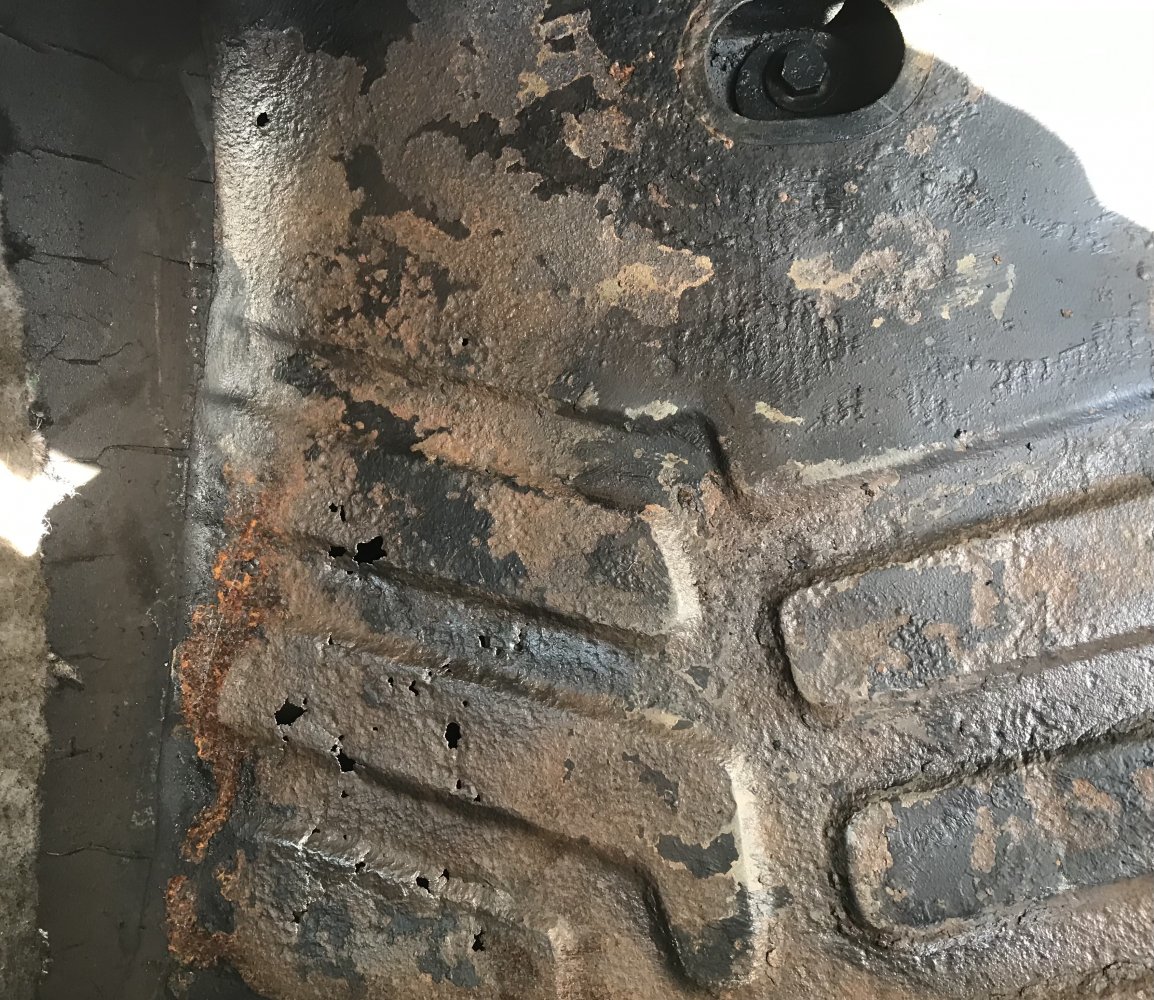

started working on my floor pans, of course drivers side hole got bigger, passenger side now has a few pinholes.

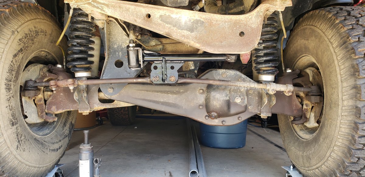

Dropped the front axle for the gear oil change. While it was opened, I drilled and tapped the bottom of the case for a 1/8-27 NPT plug. I think that equates to a 3/8" plug?.... I nestled it back in the depression on the bottom of the housing behind the flange for the cover and the stiffening rib for the pinion. Not impossible to hit on something but the something would have to work at it to hit it. Unfortunately, the hardware store didn't have any NPT internal wrenching plugs. So, next time I do the oil change, I'll have to remember to order a plug before hand. Any way, the axle is back up in place and filled. I just need to torque everything down and get the front suspension back together.

Much to it in the steps but step description and doing the actual work are two different things.
1. Break the half shaft nuts before you get the truck up in the air or have a big bar to wedge between the lugs to keep the hubs from spinning and have a big breaker bar. The nuts are 34mm, if I remember correctly.
2. Get the truck up on jack stands since the tires will need to come off.
3. Pull the tires.
4. Pull the brake calipers and caliper bracket.
5. Pull the rotors.
6. Use puller tool to grab the hub flange and push the half shaft stub in so as to break it free from the hub.
7. Pop the tie rod ends off.
8. Remove the retaining bolt for the upper ball joint and let the knuckle swing out of the way.
9. Pull the half shafts. You’ll need a pry bar to disengage the clips holding the shafts in the axle.
10. Place a jack or transmission jack under the axle. A transmission jack is better since it has a bigger platform to hold the axle in place.
11. Remove the drive shaft where it bolts onto the axle and swing it out of the way.
12. Remove the three bolts holding the axle in place.
13. Drop the axle enough to access the vent hose.
14. Drop the axle and roll it out from other the truck so you can work on it. The rest is like any other axle as far as changing the fluid. It takes 1 quart and 20 ounces of gear oil.
15. Installation. is the reverse.
