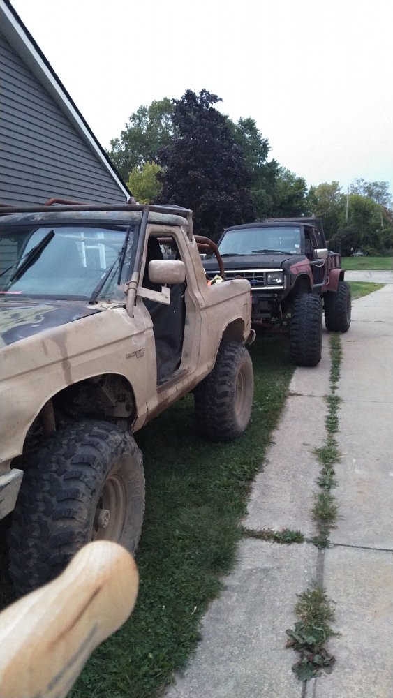

My idea of cleaning.....park on grass....suppose to rain bad tonight.
