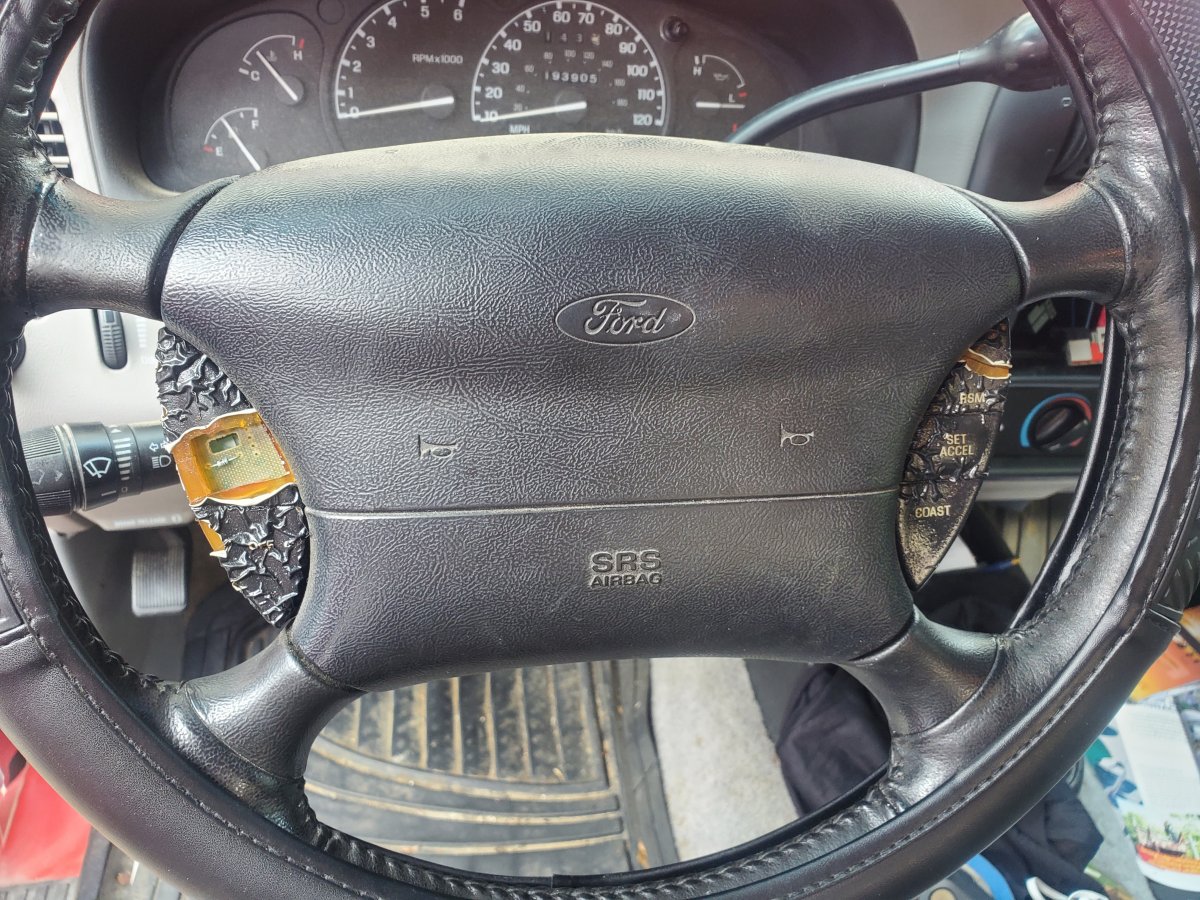

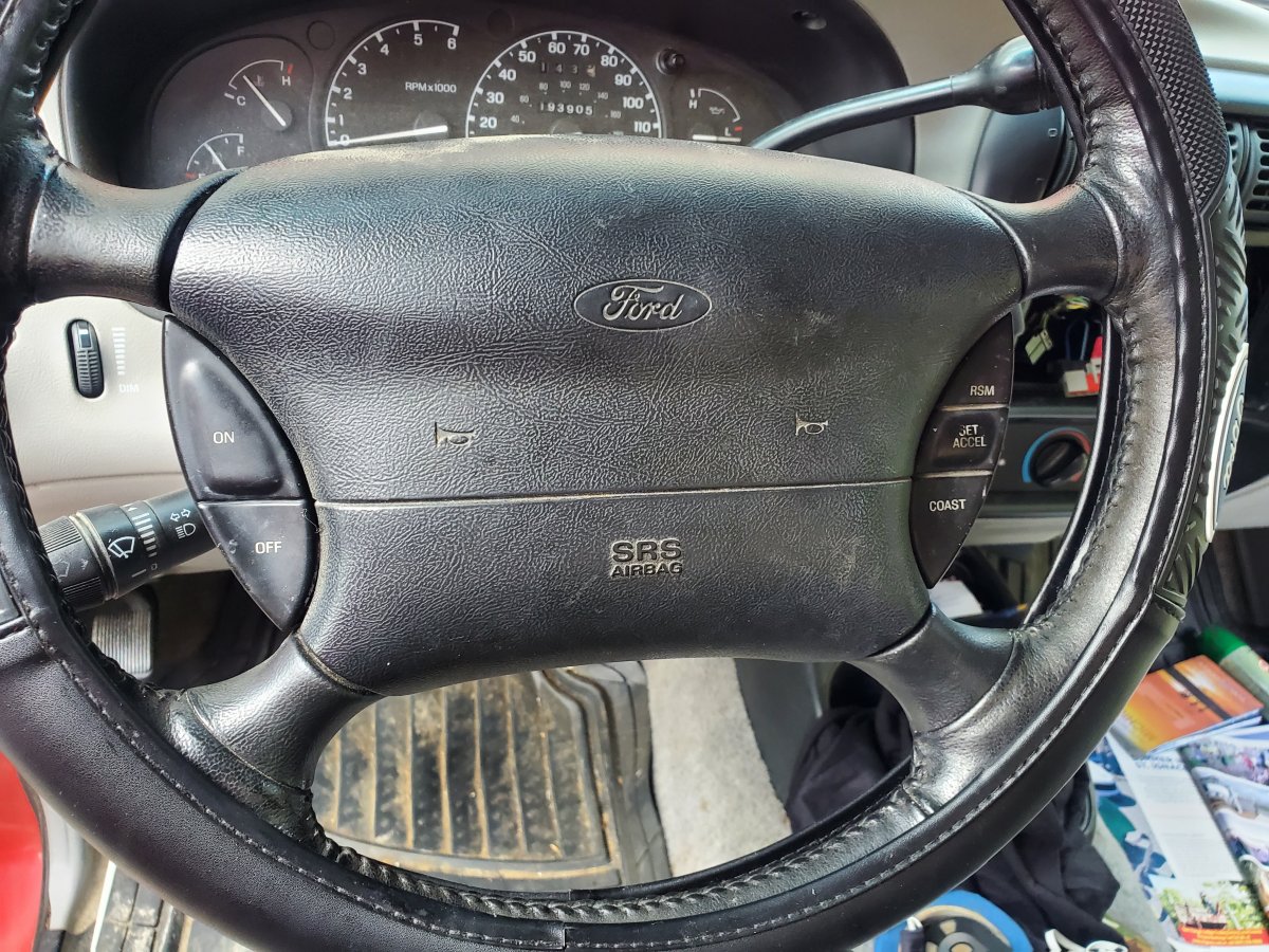

replaced the nasty disintegrating cruise controll buttons. Go a set from the junk yard a few years ago. Something to be aware of if you have a 97, the electronics are different than any of the other years... so I had to disassemble the pods and reuse the electric board
before and after shots. The old ones were really sticky and crumbly
Just curious - why a junkyard rather than a new set for $20 or so?
Better question, what the hell did you do to the old ones?
And why is your text so big?
excellent question.
because the $20 set does not fit the 97 Ranger (at least the last time I checked) to get new for the 97, it is about $100 :(
AJ
Another good question. I blame Samsung for that. it was the default text on my phone when I posted it.

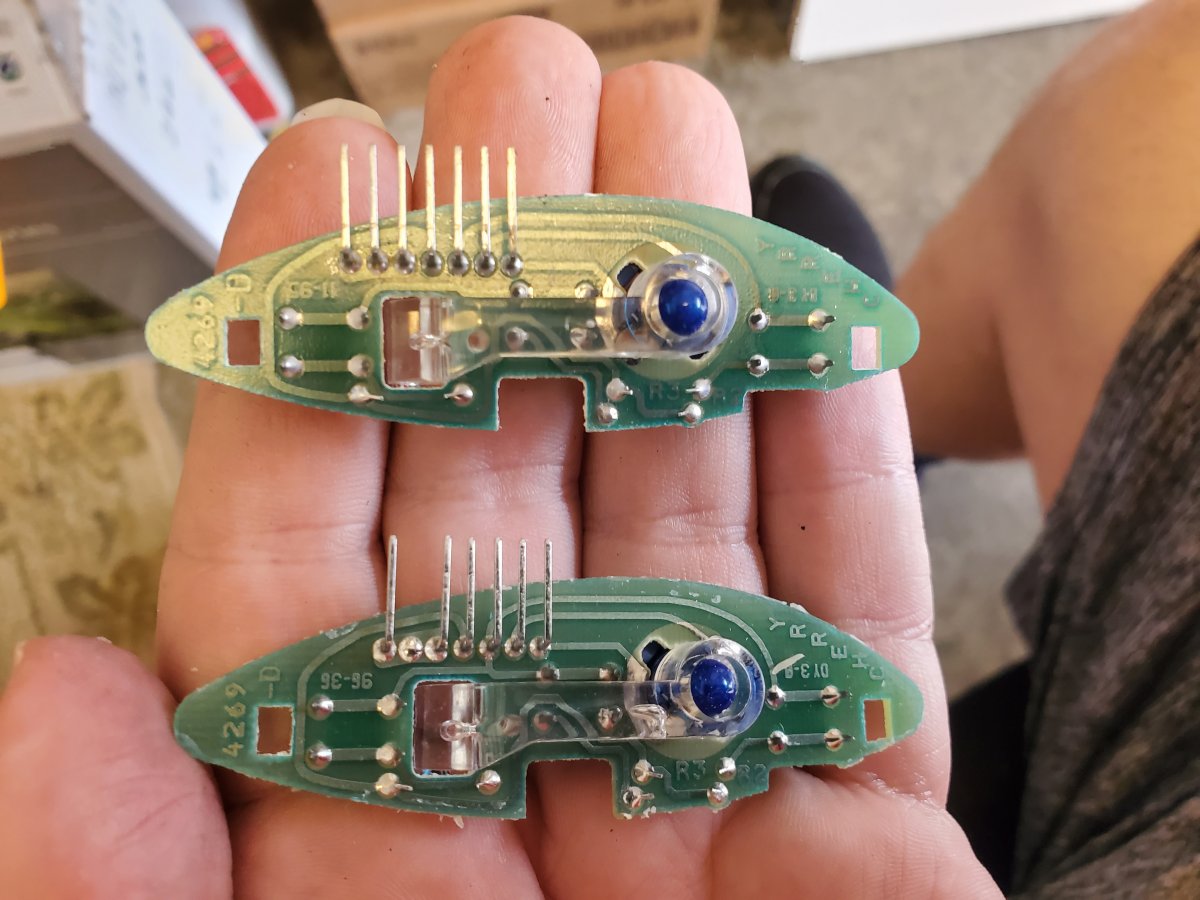

Interesting. Most of the info I found indicated that the '98+ set really does fit but was just mismarked.
Hmmm... He never did reply if it truly did work... if that is the case I may just order a set. the right side one has a bit of a crack in the center of the button but they definitely look better than the old ones.
the one difference that I did notice is that the right hand side 97 control was missing the second pin, where the junkyard versions that I got off of a 98+ had all of the pins.
Here is what I found bottom is original. Wiring harness going into the connector has that wire clipped off about an inch out of the connector.
AJ
If you want to look at it next weekend and there's time, we can certainly pop the controls off mine so you can try them.
Side note... do your buttons light up? I've never gotten clarification on whether mine should or not. They definitely do on later Rangers.
