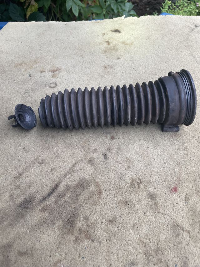

I replaced my drivers side rack and pinion bellows. I measured the threads on the outer tie rod, replaced the bellows, and put the tie rod end back to measurement. I checked toe in with a laser and it was spot on, so I called it good.
Two years ago I replaced almost all steering and suspension parts on my '07. Control arms, lower ball joints, steering rack and tie rods and wheel bearings/races.
Since then my passenger side upper control arms boot degraded and trashed the upper ball joint. My passenger side steering bellows fell apart. My Moog 8771T lower balls joints went bad (Listed as 'Premium on Rockauto). I buy everything that has zerks, and keep them lubed.

Someone is compounding some very cheap neoprene, and manufacturers and rebuilders are using it.
The Moog ball joints have a lifetime warranty but it's a laborious process, and limited to replacement. It's as if "Oh, we sold you a piece of crap? Well, then, we owe you another piece of crap."

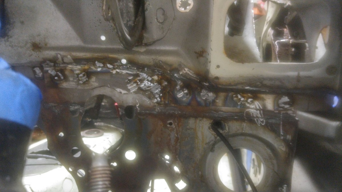

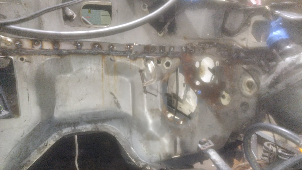

Zap zap zap. The firewall is coming along nice. Terrible feeling to run out of gas on a Saturday. At this rate I might be done with the rust repair by the time they start salting the roads again!

Looks kind of poopy now, but once I wipe off the residue and put some high build primer on this it will be hard to notice. :)

I 4ecomend getting some seam sealer once you get in there with a wire wheel
You will want it..

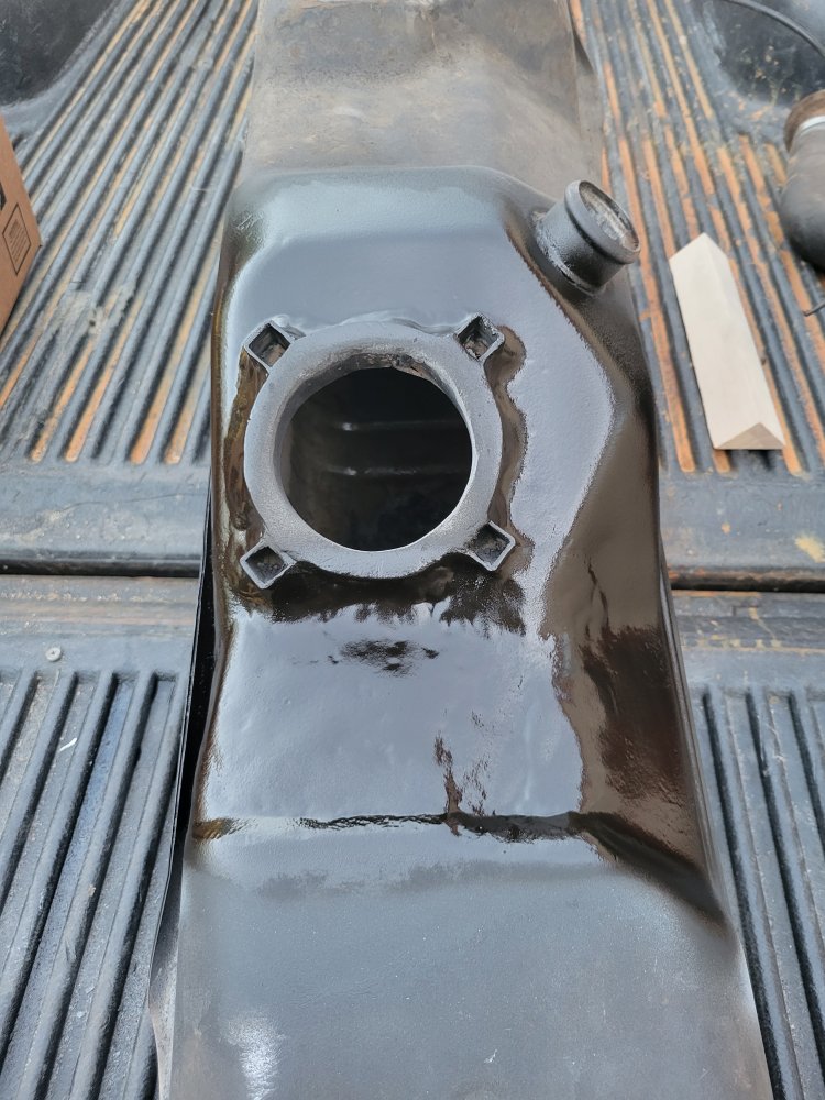

I spent the last 2 days working on my gas tank modifications. Converting an 83 fule tank with a pick up for a mechanical fule pump, to the pump and sending unit for a 4.0. Just like me I didn't take a before photo. And I won't horrify you guys with pics of in progress. We don't need dirt man to revive his, Why does everyone think they can weld thread lol. But here is the mostly final product still need to mount some bolts into the square stock, flat sand the gasket surface, build the bolt down ring, but this was so difficult, a large section on the top of the tank below the pump mount was so rusted I had to cut it out and weld in patch panels. @Dirtman how hard is it to weld a gas tank on a 1-10 scale. I had my welder on the lowest setting, and it still just kept blowing through, made me feel like a fool for trying. Eventually I got it all closed up, than coverd it all in jb weld to insure everything was water tight. I then rust converted, primed and undercoated. I will refinish the rest of the tank later.
Welding on thin stuff gets interesting... I've welded up enough mufflers and other goofy stuff to know a trick or two, but usually it's making a welder that shouldn't weld (the Harbor Freight 100A flux core welders, they're A/C which shouldn't work on flux core..) work on stuff that shouldn't work in the first place... Anyway, turn the voltage down and the wire speed up which is opposite of what you would normally do...
I'd be more sketched out about welding on a fuel tank in the first place... apparently the volatiles stay in things for a long time and it can get sketchy from what I've heard...
[/QUOTE]
I did notice towards the end I was getting a little nicer results with it set like you said, and as far as the volatile, the tank had been sitting for ten years and still smelled of gas so I rinsed it several times and than left it full as I could with the rust holes with water for several hours, than left It half full while I welded on it to hopefully keep the fumes at a non flammable mixture, I even tested it with a bbq lighter first lol.
If you're mig welding (not flux core) forget about laying a bead and spot stitch. Lay down 5-6 fast overlapping spot welds at a time moving to different locations to avoid putting too much heat in one area. You cannot do this with flux core though.
If you're flux core welding... try cursing at it? :dunno:
