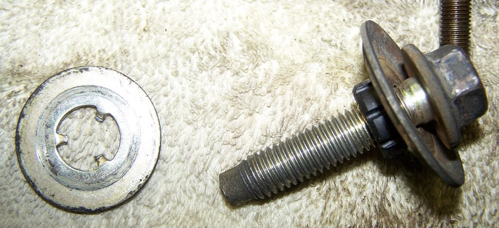

In my case the idler pulley was installed with a large washer both in front, and in back of the pulley. Of course after I finished the job, I read a post elsewhere on the Internet stating that the washer in the back of the idler pulley (shown off the bolt in the picture below) is only used to keep the assembly together in the factory, and should be discarded when installing a replacement idler pulley.
64758

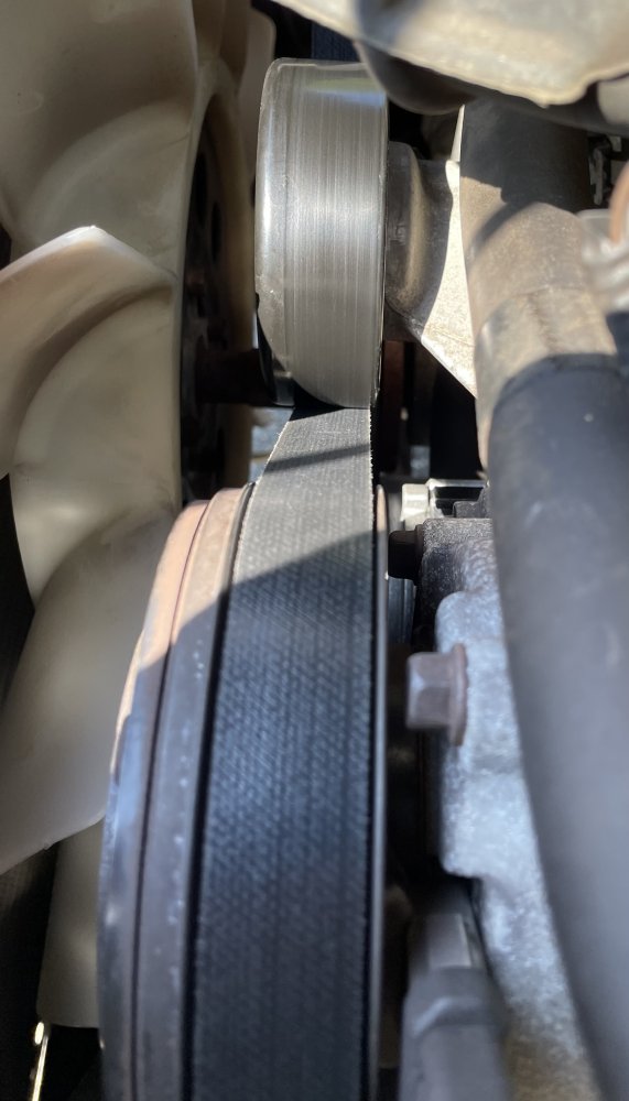

I think that might be correct because although my belt operates correctly and doesn’t make any noise, it does look like it runs very close to the rear of the idler pulley and that re-installing the idler w/o that rear washer would allow the belt be centered better on the idler. I think I’ll try to remove that rear washer this weekend. See photo below …
64760
If it ain't broke, don't go fixing it. As long as the belt is fully supported, it's ok.
