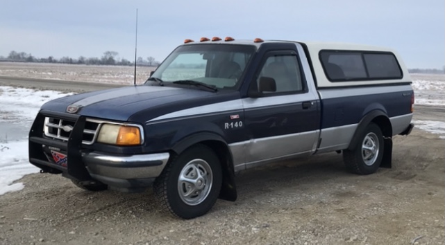

Drove mine all week to work, friday I washed it and filled it with gas, replaced thermostat in the car so the ranger can sit a bit, have parts to put on but want it to be warmer out than it has been. Have a new starter, solenoid, battery cables. Its had a slower than normal cranking speed for the past few months and the battery is 6 months old.
I've never replaced my starter I don't think. Dumb luck I guess.
well Id rather do it now before it’s completely gone, sure it could be a cable or solenoid issue too so Im just renewing it all, after 20+ years and 160,000 miles it cant hurt. Im sure everything on mine is original.

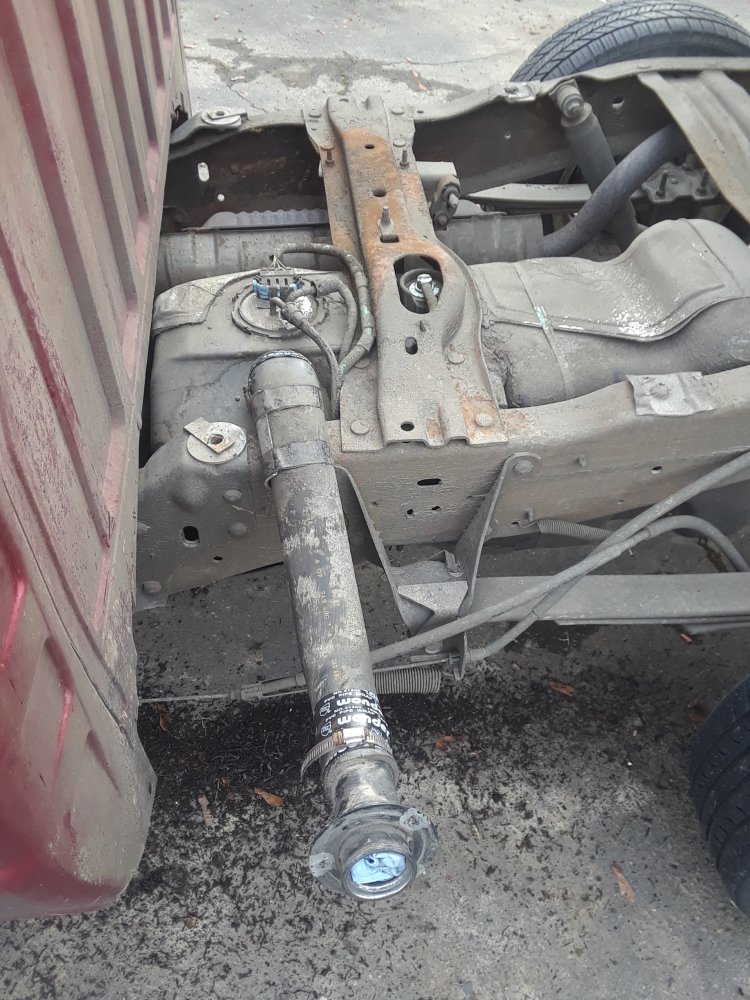

Got gas on the way home from work last night in the '97, the attendants (I'm in Oregon...) got all freaked out when it was leaking gas again... the stupid filler neck is very bad... I ordered one a few months ago but patched it with some of that tape that seals to itself when stretched, that only lasted so long and apparently isn't gas proof...

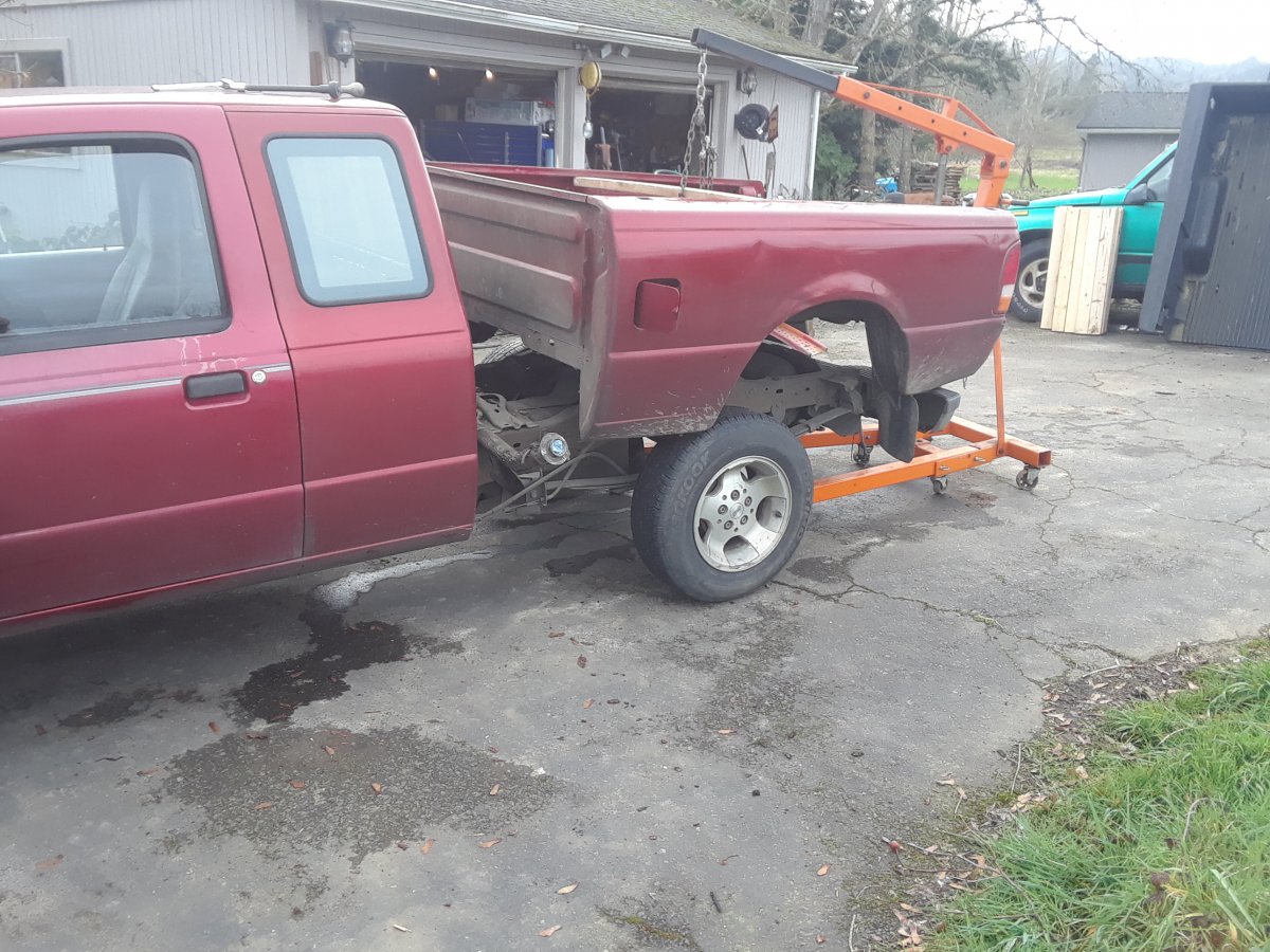

Pulled the bed today to change it finally only to realize the hose I got was 2" too short (before I installed, but after opening package, must be for step side bed) so I improvised again... This time I used PVC Pipe Wrap tape since I don't remember where I put the tape I used last time... Hopefully that will last long enough for a new hose to be ordered. It's annoying that the hose on my '90 is from 1989 and perfectly fine with close to 300k miles on it, but the '97 is completely fried at 160k
Could be how the road salt hits it. A few years ago I bought my late uncle's Mercury Marquis from the estate (I was the executor, had to buy the car so I could fix it up to sell it, long story), it hadn't run in a year and a half since we took his keys away, and when I put gas in it leaked all over. Filler tube was rusted out, the part was discontinued by Ford but I found repro units on Amazon.
It's not that, this is probably the cleanest frame most of you have seen :). That surface rust on the crossmember was surprising, I might spray it down next time I have the bed off... The metal is in good shape, they changed materials on the filler tubes, I think it's just a thing, when it first started happening I looked into it and it sounds common... I know the Jeep wheels in back look odd, there's Ranger steelies in front... I need to get the stripes off the door too...
Just a side note. It looks like you’re using a NAPA/WalMart type paper shop towel to plug the fill tube for safety. A long time ago, in a galaxy far far away, I used to do that until: a piece of the towel about the size of a dime tore off and eventually slipped into the fuel outlet (1966 Ford F600 with the tank behind the seat, no in-tank screen). The truck would start & run around for maybe 1/10th mile, and then sputter and lose power, but not cut off, and if you let it sit and idle, then it would start running right again, but only for a bit. The bit of paper was still allowing fuel to go past, so the carburetor bowl would fill up and it worked OK at a low speed. When you stepped on the gas, it would go right just until you drained the bowl and then it was working off the trickle from the gas tank. Three of us spent 24 hours on the side of the road out of town taking half the truck apart before we found that little bit of towel, from a towel that I had used maybe two weeks before that.
Point is, use a rag or the gas cap, check it going in & coming out!!
