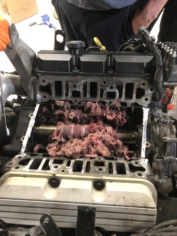

Rags can be bad inside of stuff too...
Not if you use them as specified in the New World Rag Applications Manual, 23rd Edition, Chapter 3 “Rags in Automotive Machinery,” Subsection 3a1.f “Rags as Temporary Fuel Caps.”
