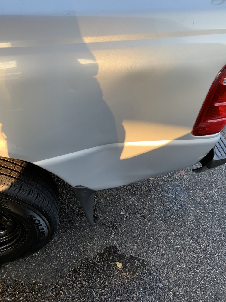

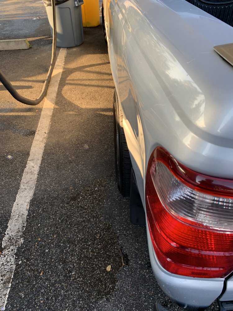

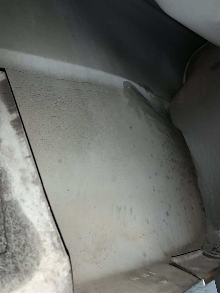

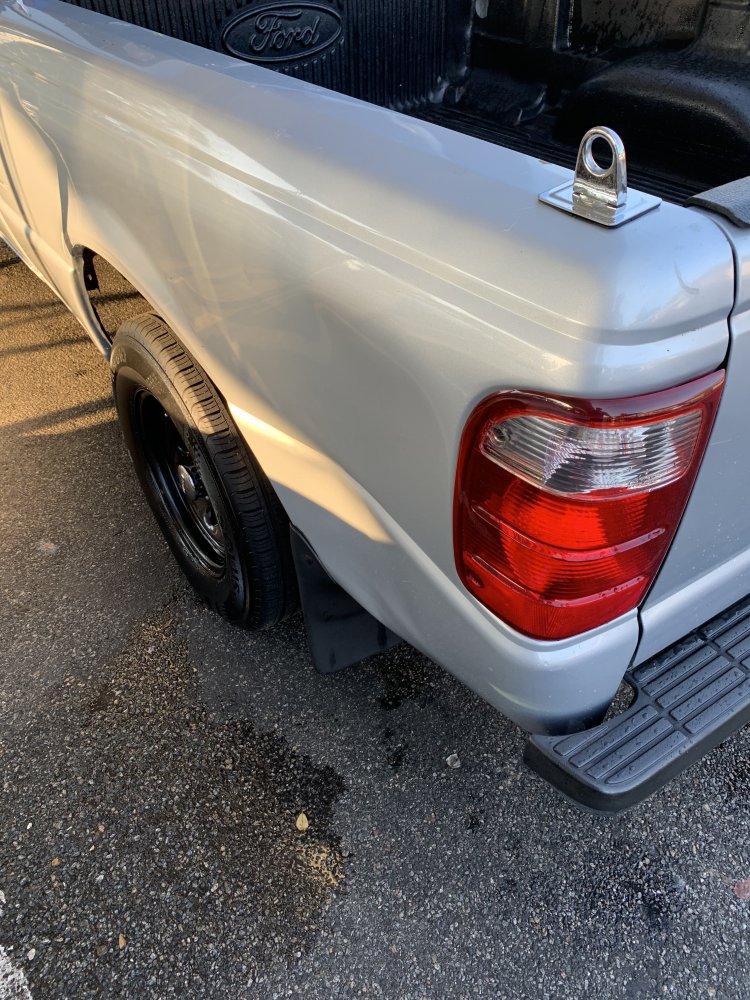

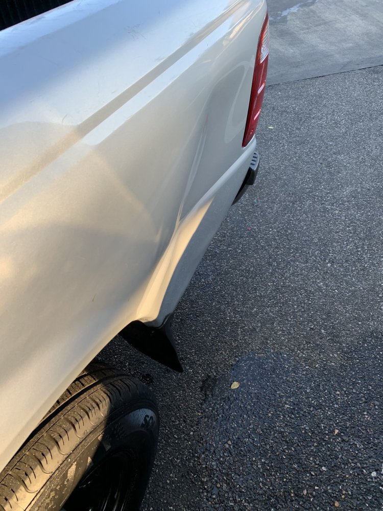

Took some pretty good body damage in an automatic wash tunnel.
Was going through the brushes and felt a jolt, like a truck hit me in the rear side.
View attachment 56215View attachment 56216View attachment 56217View attachment 56218View attachment 56219
Oasis Express Wash on W. Tennessee St. (US 90) in Tallahassee, Fla. Attendants took photos, wrote some stuff down and gave me their boss's phone number. Asked me to come back Monday. Was about 5:30 PM and they said the manager had gone home and he was the only one with access to the cameras. We shall see. Worst case I have comp and collision, and a lawyer who will be glad to subpoena their camera footage.
That is unfortunate, but I don't see a big crease, go insurance route first but I'm pretty sure if you put a 2x4 at the body line, angled back and pushed that dent would come 99% out without anything further... You should've seen the dent in the drivers door of my wife's Explorer when her dad backed into it... that unfortunately had some creases but it isn't too bad...

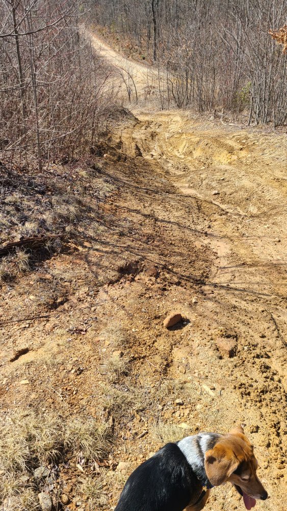

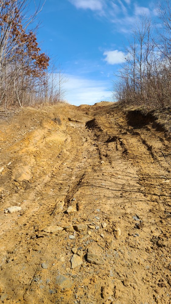

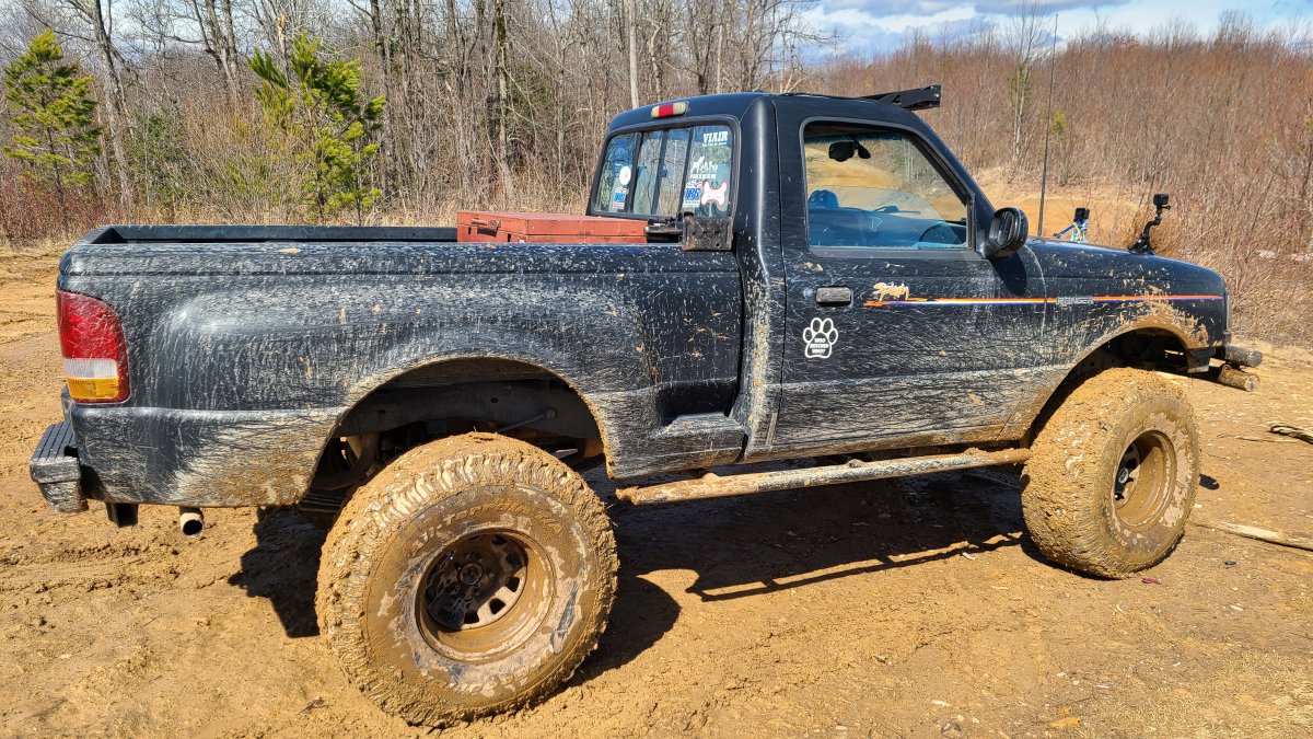

I had fun in it. Pinnacle Mountain Rd in NC. Hopefully videos later tonight or tomorrow.

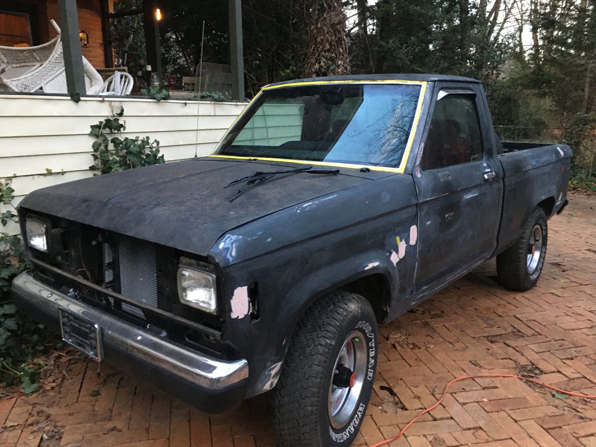

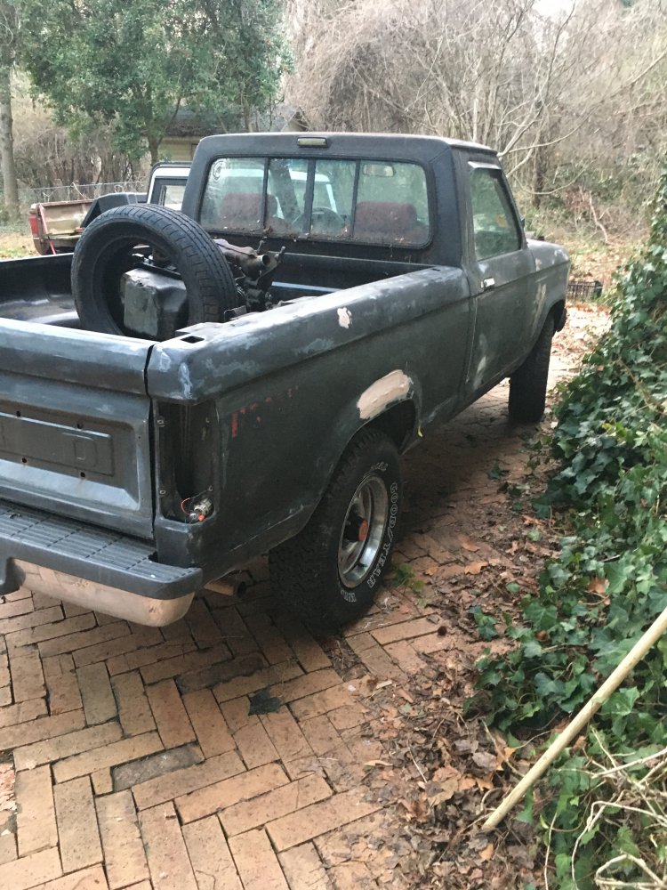

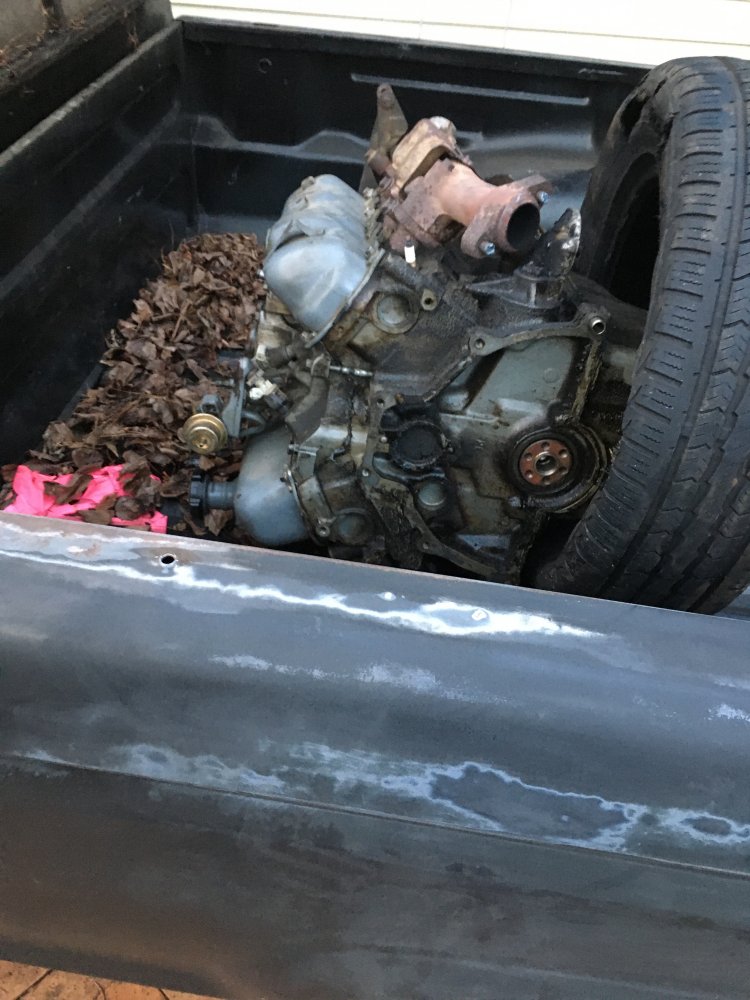

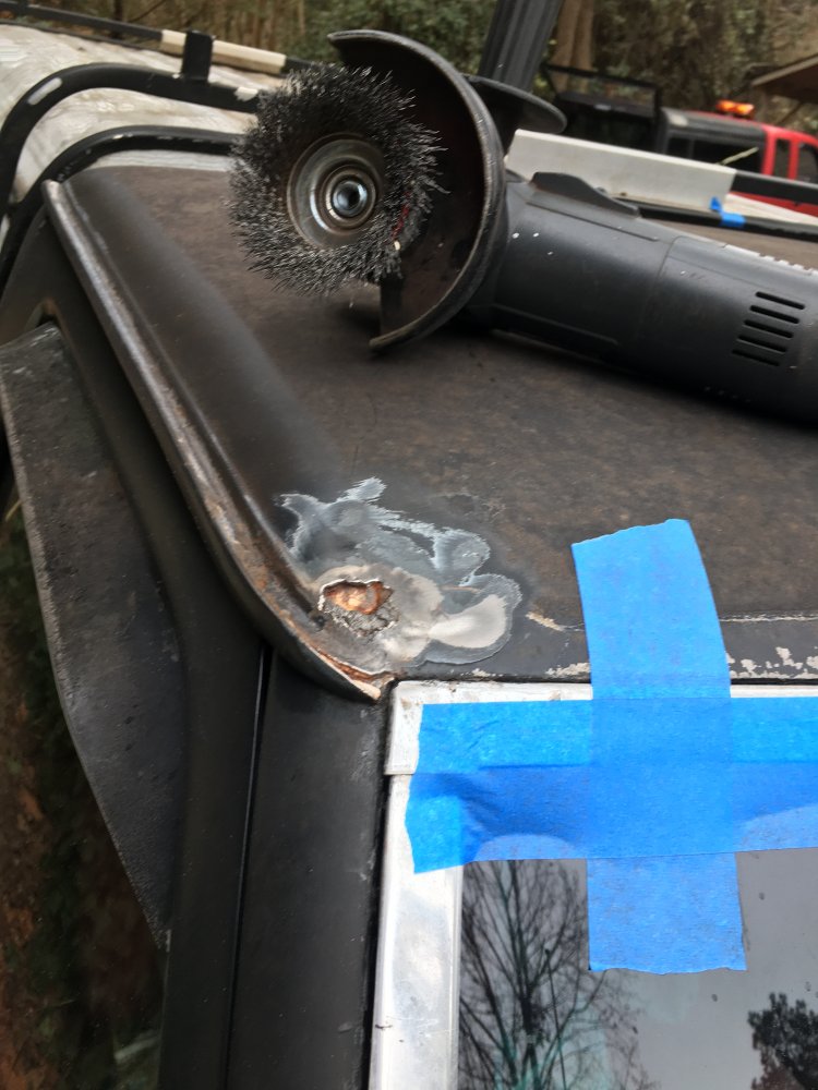

I jacked up the ribs in the aluminum cap (don’t need a bird pond), took off the cap and started stripping & sanding. Really only two bad spots, both very manageable.
I’ve learned you get the best result by using the right precision tool...

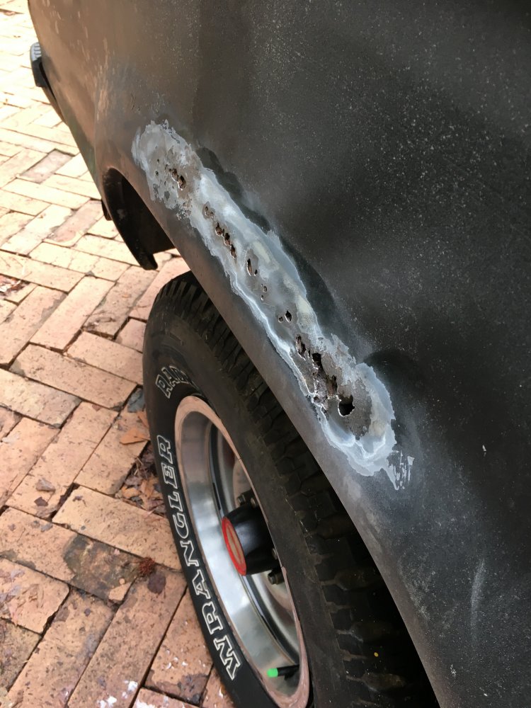

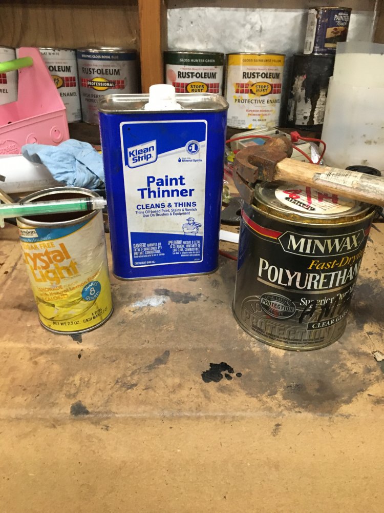

On the two rust holes (only rust holes), after I brushed them out and blew them out with air, I mixed up a very thin urethane and then squirted it all around in the holes. I used 2 parts thinner to 1 part polyurethane. I squirted it in with a 3ml syringe (no needle). It’s thin and soaks spreads everywhere, hopefully slows down the rust.
I was happy to finally use my Crystal Light container. I’ve only had it 30-40 years.
I got it 90% stripped and 90% sanded, got bondo over all the small stuff. In the fender, I mixed the bondo into some steel wool, & packed the holes, and slathered it over the top. We don’t have the same issue with rust here in Hotlanta, and it’ll be under a carport. Definitely will outlast me!
I was hoping to get a primer coat on it, but ran out of energy. It’ll have a coat or two on tomorrow. & I also need to strip the paperweight now that the cap is off.
I saw the guys over at TFL classics fix a dent like that by pushing ab under inflated basketball behind the dent and re-inflated it, popping out the dent.

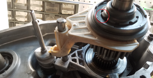

Reinstalled my transfer case after fixing 4H that was slipping out of 4x4 when in a sandy wash. And it actually works! -Well at least the little test drive I did. I'll try sand and hills tomorrow.
Worked on it for a week. Ended up swapping the mode slider with one from a '93. The OEM mode slider was engaging only 1/8" of the 1/4" wide spline, and since it's spring-loaded, allowed it to slip out with a Bang.
