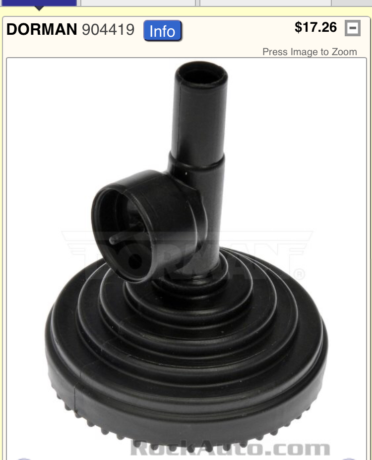

The new pick up screens are made of correct material, so when you put them in, you don’t have to worry about them disintegrating. But some of them didn’t disintegrate, they simply fell off the tube, hence using a little hose clamp to really tighten them down.

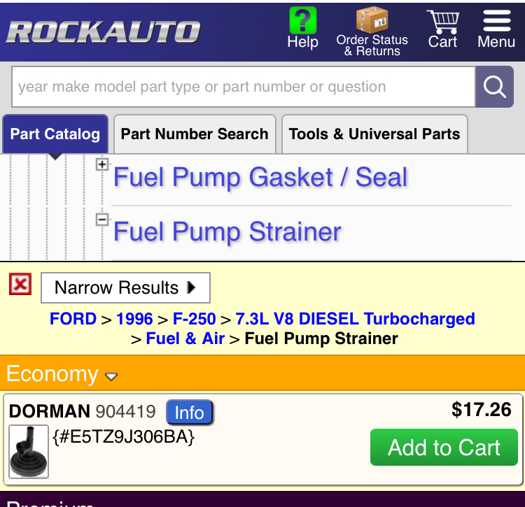

Rock Auto. I may have gotten it cheaper on eBay.
The little hose clamp is an oddball size, I had to order them and I had to buy a kit with a bunch of them in different sizes, but it was still dirt cheap and now I have the others available for my various Rick-storeration projects

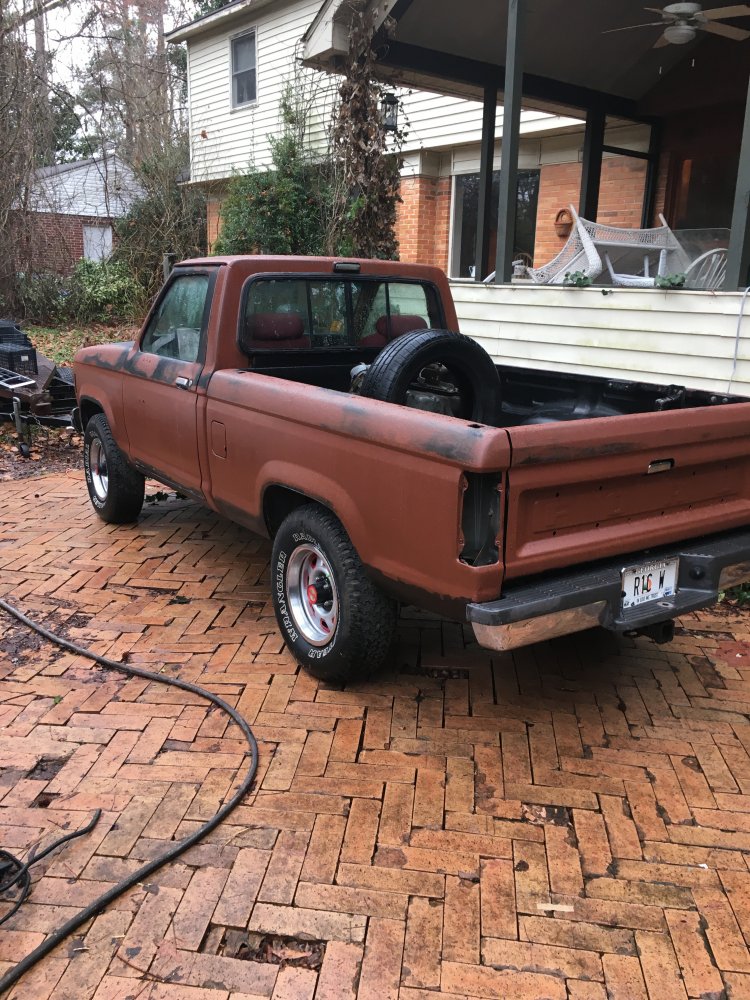

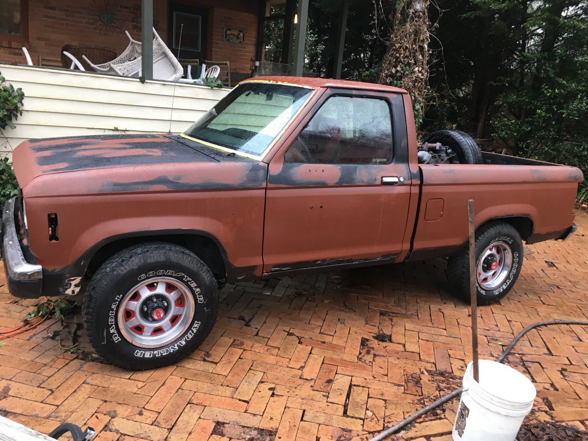

Baby steps: The two seams that go up and out from the back window and the rain gutters had cracks in them. I cleaned out the seams by hand, and I ran that heavy wire brush on the angle grinder down the rain gutters. Then I used regular latex caulk like you’d use around your house window and refilled those seams and ran a good little bit, worked in good, down the rain gutters.
That’s as far as I got before I ran out of daylight and energy yesterday:
Rained here today, so it’s hard to tell the raindrops from my runs.

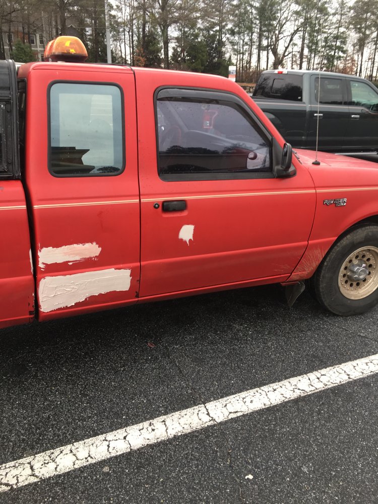

As I was doing the Bondo work, I mixed up more than I needed every time, and I started filling two creases in the 97. Yeah, they look like they were done in the dark too, but we’ll sand ‘em out...
View attachment 56326View attachment 56327

I don't use Dorman posts for anything that requires more than 5 minutes to change.
Edit: Especially on a Ford diesel.
In my front tank I used the Dorman part I believe but it was hard to find so I don't think there's any other options... I might have gotten the NAPA part, but it's probably reboxed Dorman...
These are just strainers, no moving parts. Not much could go wrong if you just secure them tightly.
