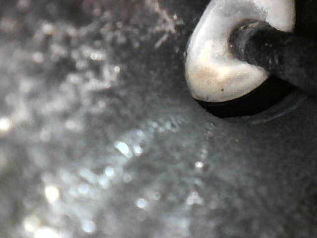

The area of concern is on the back of the valve where it meets the stem. That is very clean. The valve stem itself is pretty grody though.
Here's a photo of the back of the valve that forum member grammat95 posted over on the Ranger5G site. His truck had 25,000 miles on it when he took the photo with a borescope. No catch can is being used.
Maintenance / Habits​
- Full synthetic 5W-30 (Valvoline) from the first oil change. No more than 5k intervals.​
- Lots of towing (often times at max cap.), I would guestimate around 10k miles​
- Most trips are at least 20 minutes​
- I have not noticed any fuel dilution issues with oil​

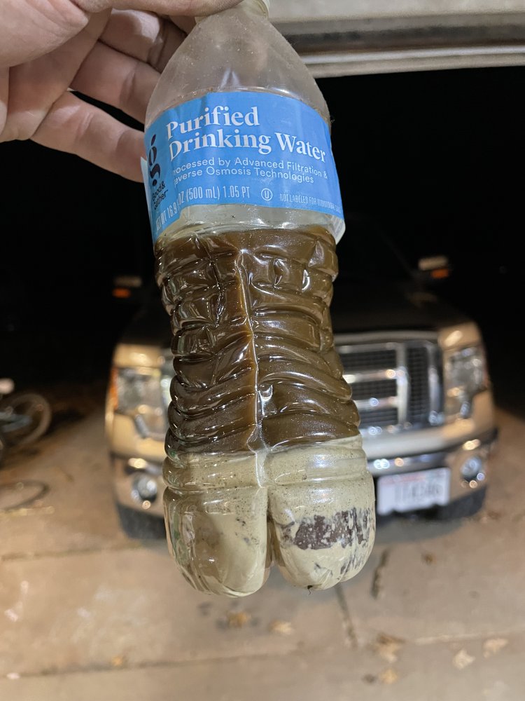

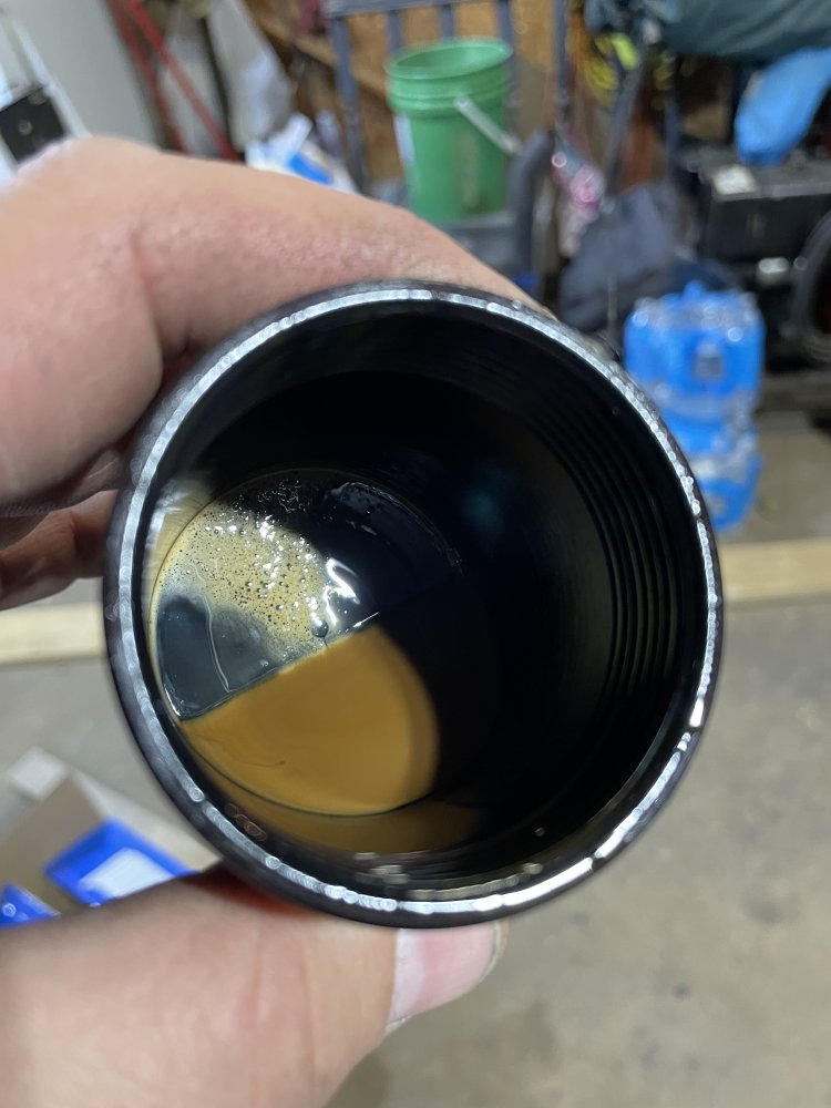

I have a JLT 3.0 on my 3.5 EB F150. I took a couple pics to show you guys what the separators are catching.
This is 300 miles worth of crud;
This is roughly what I've collected since last February. My commute is 17 miles one way but I'm in Wisconsin and it can be very humid at times. I average approximately 50 miles a day between the trip to work and picking kids up after school/running to sports.

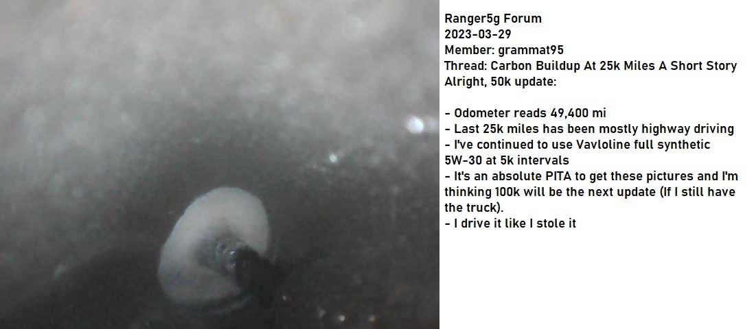

Ranger5g member grammat95 posted updated photo's of the intake valve at 50,000 miles. The valve looks to be about the same, or better, in regard to carbon build up.

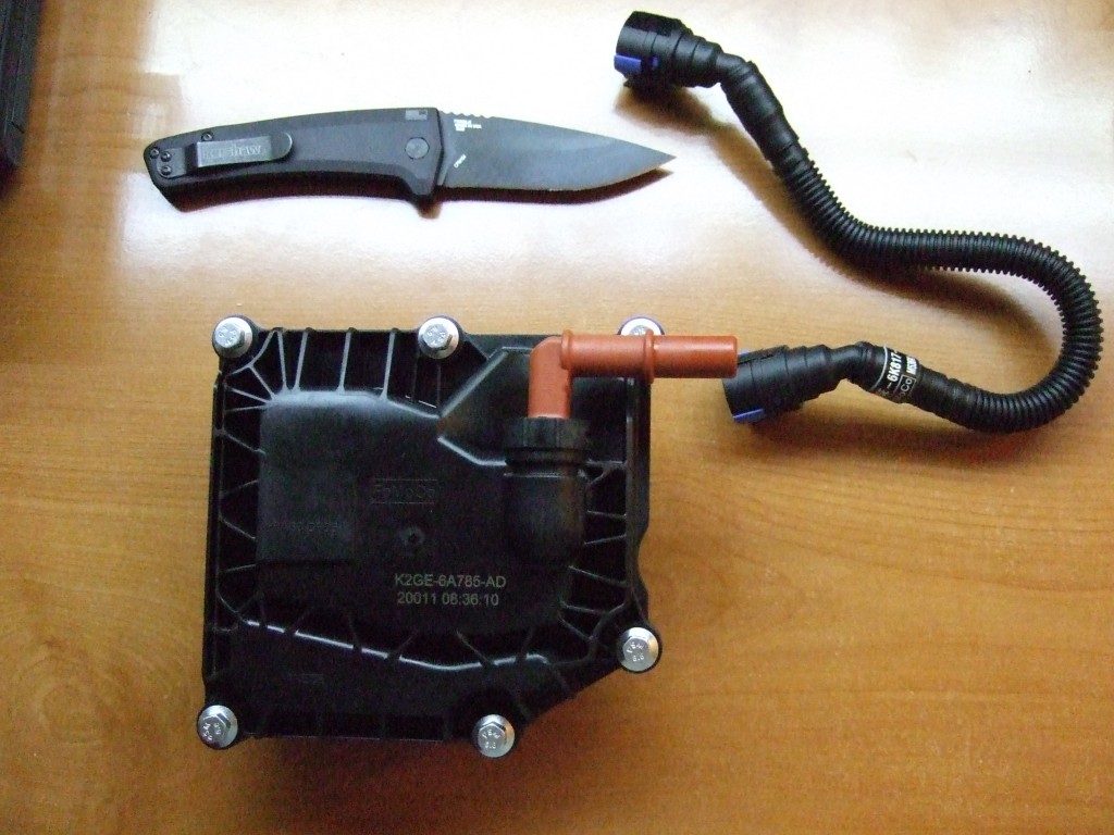

Maybe that silly little oil separator Ford put on the Ranger ecoboost motors to address these issues... isn't so silly after all?
