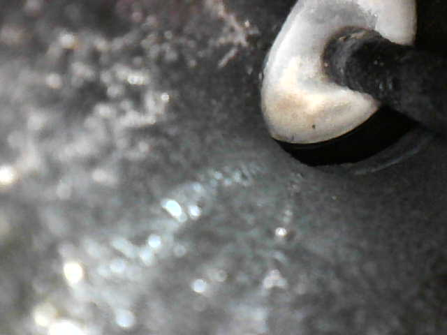

Here's a photo of the back of the valve that forum member grammat95 posted over on the Ranger5G site. His truck had 25,000 miles on it when he took the photo with a borescope. No catch can is being used.
Maintenance / Habits​
- Full synthetic 5W-30 (Valvoline) from the first oil change. No more than 5k intervals.​
- Lots of towing (often times at max cap.), I would guestimate around 10k miles​
- Most trips are at least 20 minutes​
- I have not noticed any fuel dilution issues with oil​
