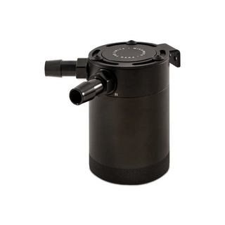

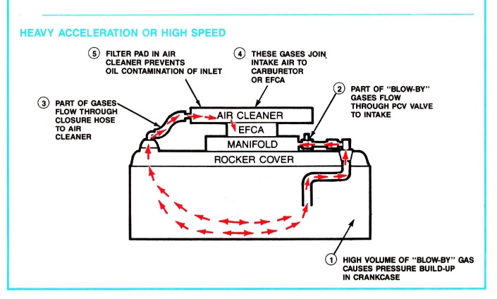

Picked up a universal oil catch-can for my bronco II.
I've added these to my last 2 vehicles, and recommend them for reducing throttle body soot.

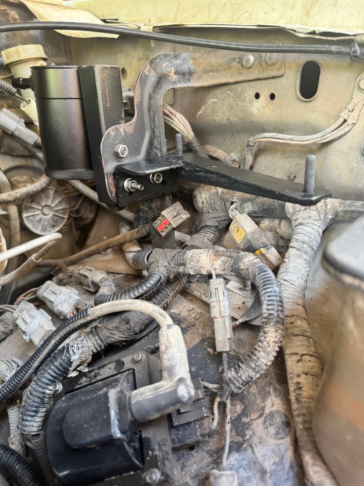

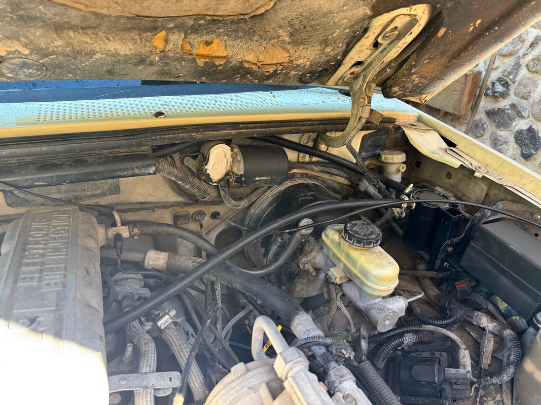

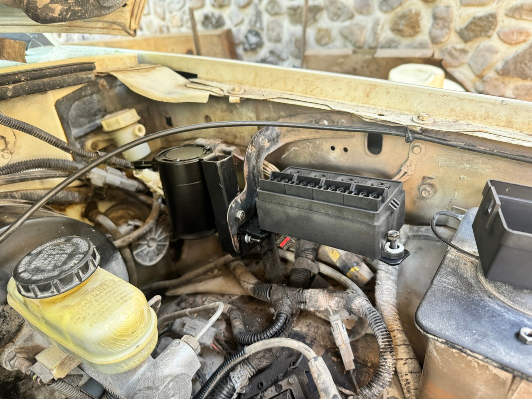

I removed the cruise-control vacuum canister today, so there is one possible location.
If you've installed one, I'd like to know where you installed yours.
Thanks
