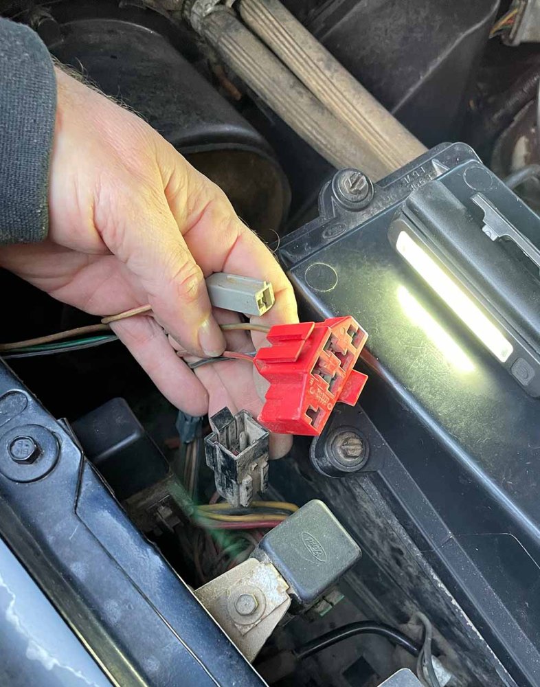

I have three unplugged plugs on the left side of my engine bay. They are between the airbox and firewall. Does anyone know what these could be for? One thing I am realized in the month I have had my 86 is that even when I turn the key on before completely starting I never see the engine light light up. Not at all ever. I have seen in youtube videos of same years and when people start their cars the engine light briefly comes on. Did the previous owner unplug it somehow or? Anyone way I can test it? The truck runs really well. Starts and idles great. Just continuing to learn as much about the truck as I can because I absolutely love it. Thanks all.
The grey and red are for system diagnosis using OBD1 code reader. I didn't think that was available on pre-93 or 94. Not sure what the other one is for. But someone will come along shortly and correct me, cuz I'm usually only part right 😬
86 is the first year of EFI. There wasn't any cel light for this year. As rumble cloud said, the grey and red are for obd1 diagnostics. The black is for a relay, I think for air conditioning bypass when gas is floored.
Two of the connectors plug into a scanner like this.
The bulb may well be burned out. The light was originally switched on by a module that was a timer set to turn on around 60k miles. It can be accessed by dropping the glove compartment and looking up. There’s a paper tagged labeled reset that gets punched through when the module is reset.

Yes, no CEL(check engine light) on your year
Grey and red are for testing the computer, commonly called OBD1 connectors, they are left unplugged until needed
Seen here: https://www.therangerstation.com/tech_library/OBD_I.shtml
The labelled Fuel Pump slot can be used to activate the Fuel Pump Relay manually for testing purposes, if you GROUND this slot, then when you turn the Key On the fuel pump relay will activate and send 12volts to the TWO fuel pumps
Normally, the computer grounds that wire/slot with key on but ONLY for 2 seconds, its a safety thing, so makes it hard to test wiring to fuel pumps
The black one may be for an uninstalled Option, need to see/get the wire colors on it to see what it might have been for
It looks dirty inside so hasn't been connected, ever, or for a very long time
